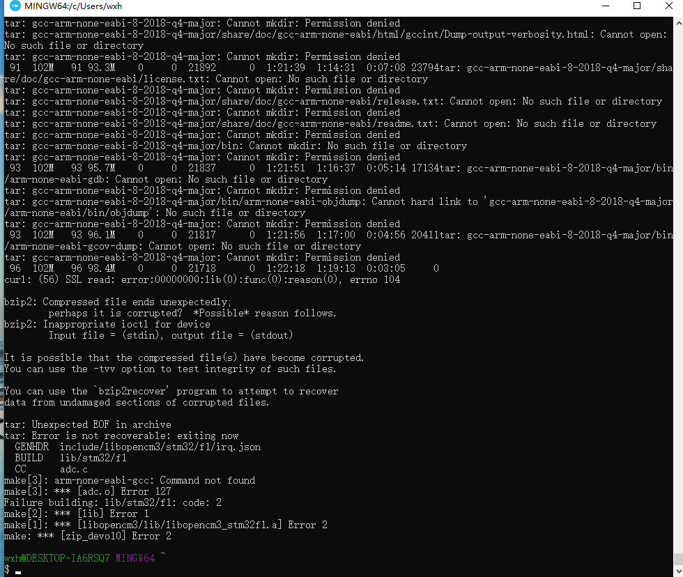

- wind10071
- Posts: 20
23 Jan 2019 08:05 - 23 Jan 2019 08:06 #72488
by wind10071
Replied by wind10071 on topic [Call For Testing] Test GCC 8.2 & new libopencm3
Last edit: 23 Jan 2019 08:06 by wind10071.
- csujun
- Posts: 28
23 Jan 2019 08:12 #72489
by csujun
Replied by csujun on topic [Call For Testing] Test GCC 8.2 & new libopencm3
Should relate to the change on GCC version. Let me check the docker script.

- wind10071
- Posts: 20
23 Jan 2019 19:54 #72507
by wind10071
Thank you csujun !
Now the build deviation is back to normal!

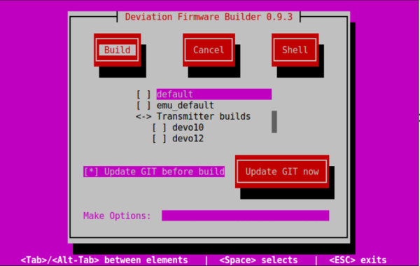

- gdenton
- Posts: 71
24 Jan 2019 01:34 #72511
by gdenton
Replied by gdenton on topic [Call For Testing] Test GCC 8.2 & new libopencm3
Windows 10
local clone copy of deviationtx
I finally figured out that I had to delete the existing image/container, re-download the Deviation build environment and re-create the Docker container.
I then had the following error after starting a build:
fatal: destination path 'src/libopencm3' already exists and is not an empty directory.
Clone of ' github.com/DeviationTx/libopencm3.git ' into submodule path 'src/libopencm3' failed
I deleted src/libopencm3, re-started the build and it succeeded.
- wind10071
- Posts: 20
24 Jan 2019 07:33 #72512
by wind10071
Yes, delete the existing image/container, re-download the Deviation build environment and re-create the Docker container.
1 View all containers:
docker ps -a
2 Stop container:
docker stop id
3 Delete container:
docker rm id
4View existing image:
docker images
5 Delete existing image:
docker rmi ID
6 exit
All over again
docker ps -a
2 Stop container:
docker stop id
3 Delete container:
docker rm id
docker images
docker rmi ID
6 exit
All over again
