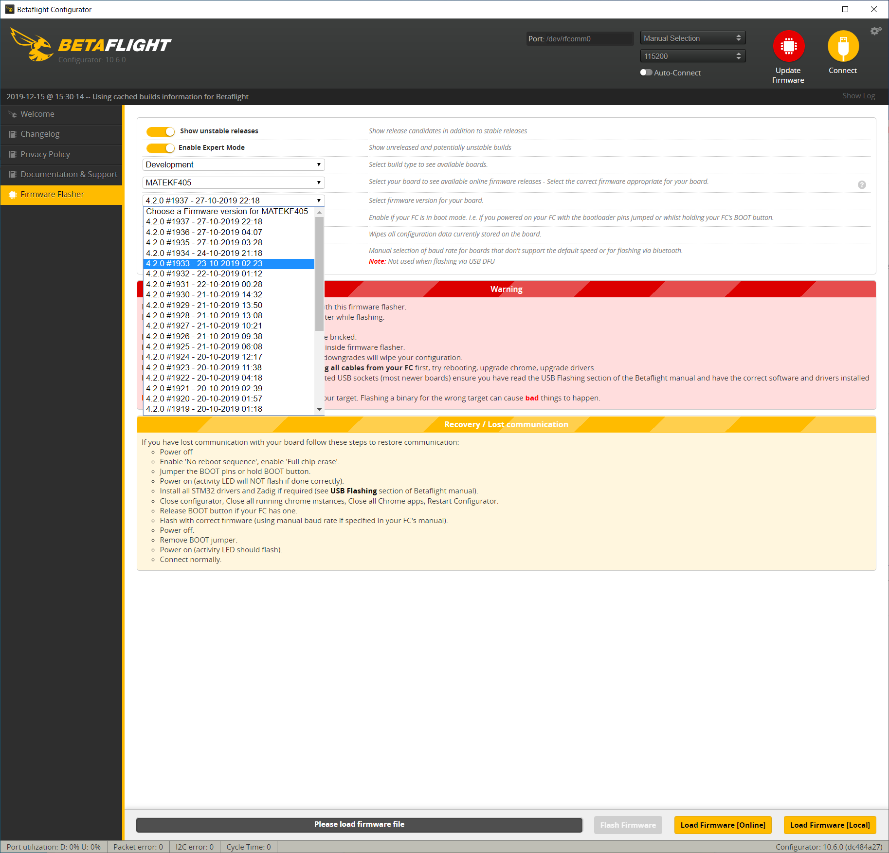

For me the versioning of Deviation is not clear, can we change a clear follow up versions id?
I personally like they way Betaflight deals. See attached.
-Development / test builds (generated multiple a day, each with different nr, basically our nightlies)
-Release candidates
-Official Releases
-Maintainance Release (Specifiic compilations/selections, f.i. to run some of the newer features on an old hardware)
-Release candidates
-Official Releases
