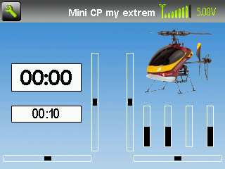

Walkera V100D03bl was created by AngryPete

07 Dec 2012 08:30 #3742
by AngryPete
Replied by AngryPete on topic Walkera V100D03bl
I exported the bmp with GIMP portable v2.8.2 as a 16Bit image colors A1 R5 G5 B5. The Emulator and Deviation v2.0 shows the image correct. I only can not upload it to the forum.
07 Dec 2012 09:01 #3743
Replied by FDR on topic Walkera V100D03bl
Just as I thought:
If you are using Gimp2.8, then select 'Compatibility Options' and enable 'Do not write color space information'
