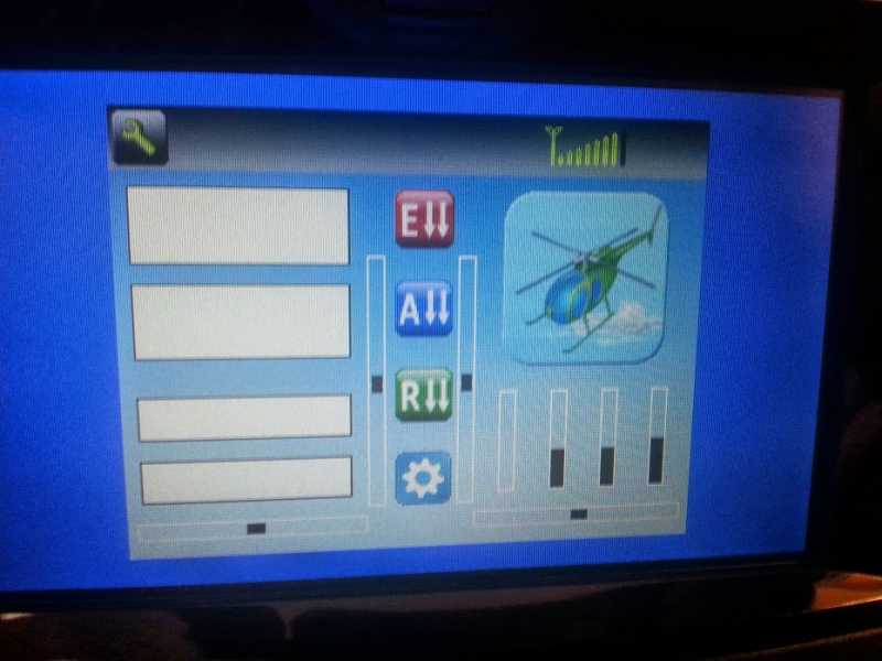

20 Jun 2013 19:34 - 20 Jun 2013 19:35 #11171 by adabman
Replied by adabman on topic VM dedicated to compiling Deviation
Hello, I just got the vm working in hyper-v, my preference. I am able to build successfully. So far I have built the reg deviation, PB's new-gui, and RBE's Devo 12 widescreen build.
Problem in all cases when I flash the Devo12:
Seems there is fonts problem.. Any ideas?

20 Jun 2013 19:37 #11172 by rbe2012
Replied by rbe2012 on topic VM dedicated to compiling Deviation
You must flash the library too (devo12-lib.dfu, in the library tab of dfuse). It contains the fonts and more.
20 Jun 2013 19:47 #11173 by adabman
Sorry should have said, I did flash the lib-devo12 also. as well tried flashing the lib included in the filesystem.zip "devo12-lib.dfu"
Same prob :(
