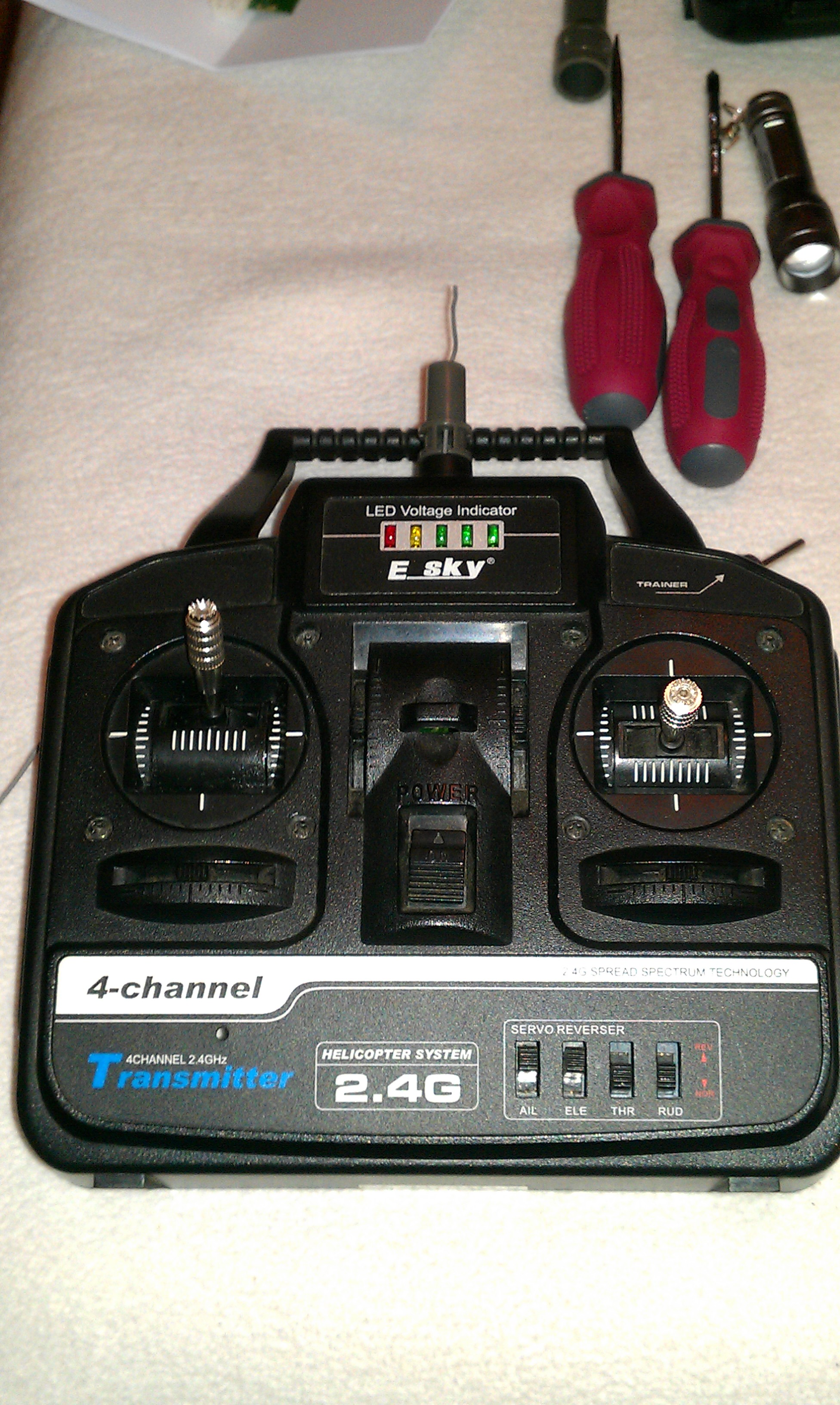

is there the possibility to bind the Devo 10 to the Esky EK2-0708 2.4GHZ 4in1 Receiver?
Or to Upgrade the Devo to this Module and Protocoll?
The Board inside the Esky 2.4G tx is: module TX1P08B
3 Wires black, red, white
I use the Devo also for other Heli´s and Planes, but they are equipped with devo RX and 2801pro RX...
Thanks in advance for assitance
Sven
Sven

Thanks,
now i modified to the last Nightly build and find now 2 Esky Protocols
*ESky150
*Esky
... but i cant bind, there is a Star in front of (*ESky150 / *Esky)
Do i need to add a new Module to the Devo?
Which one i´ll had to use?
or how to install the one i have?
In the Supported Models Sheet isn´t a Module to the ESky referenced
many thanks in advance
Sven
*ESky150
*Esky
Sven
