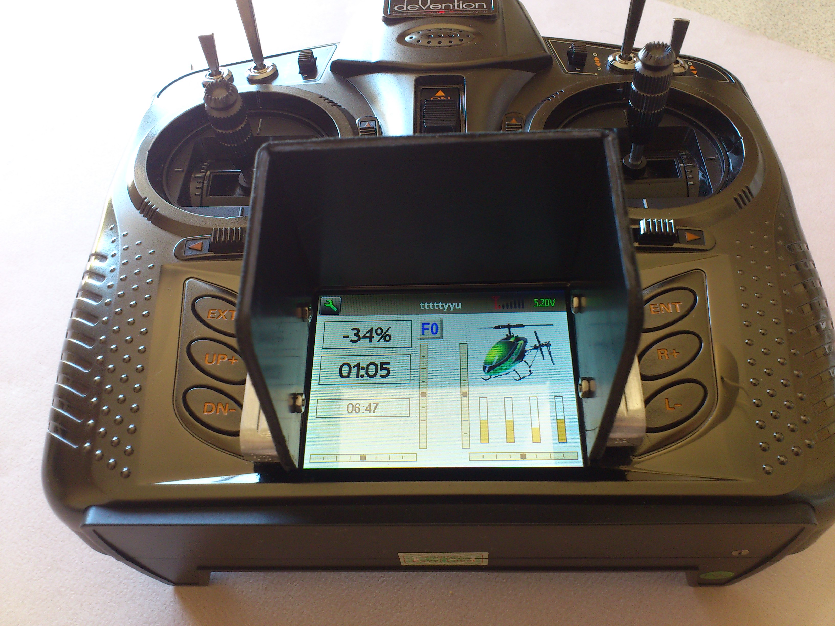

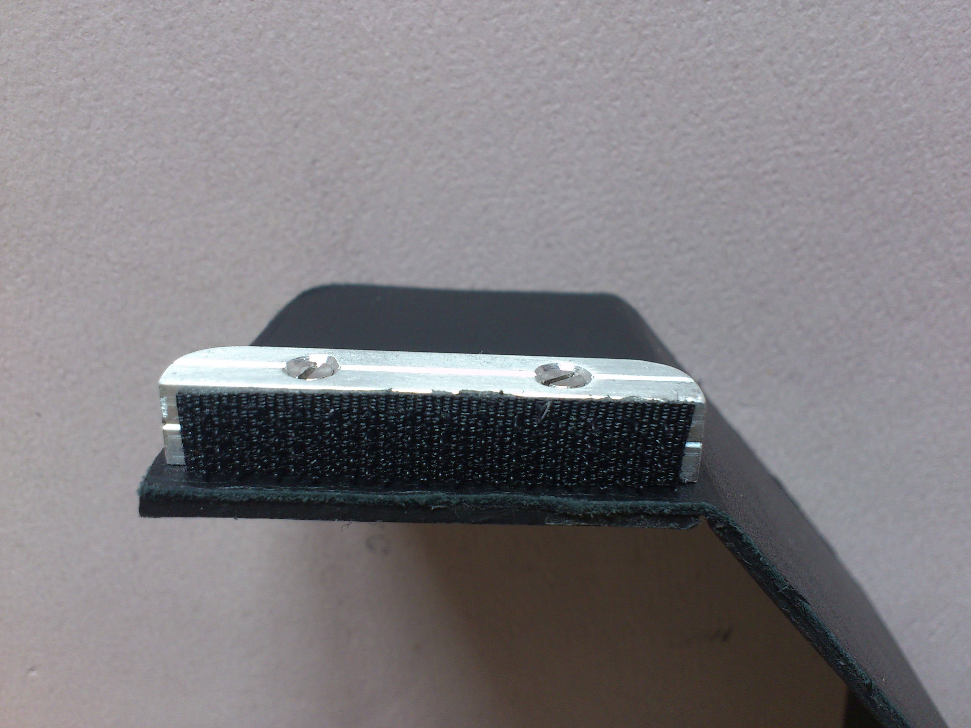

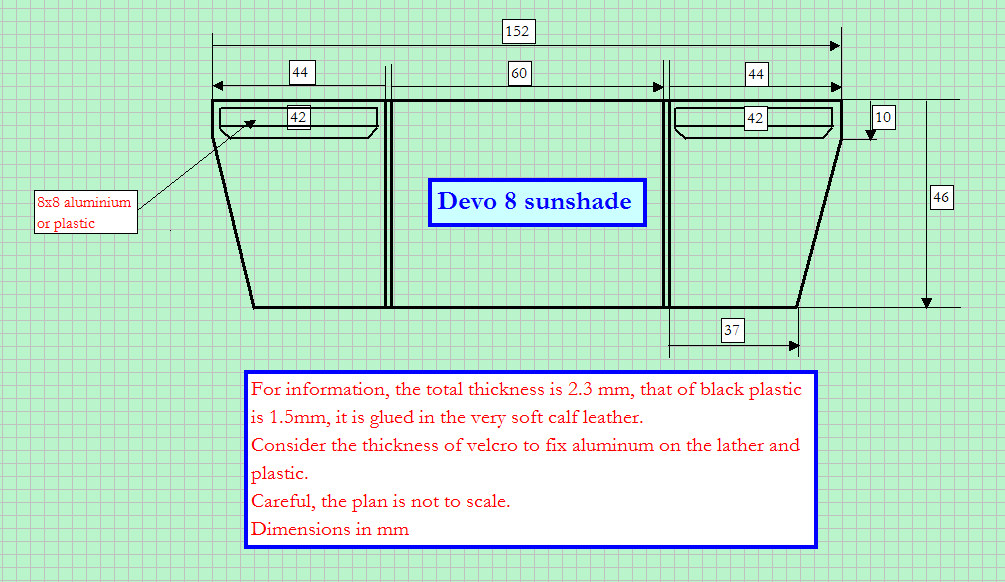

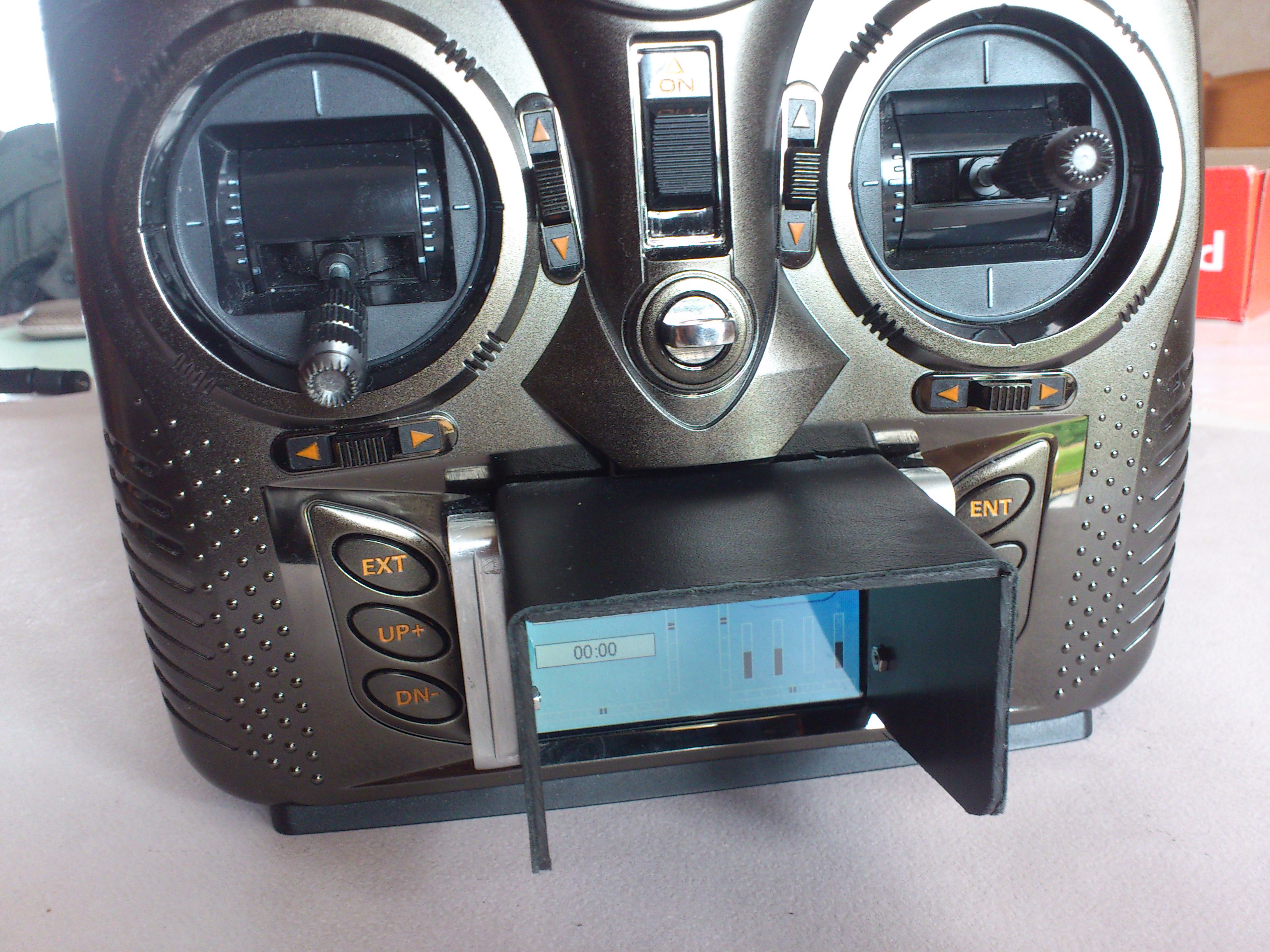

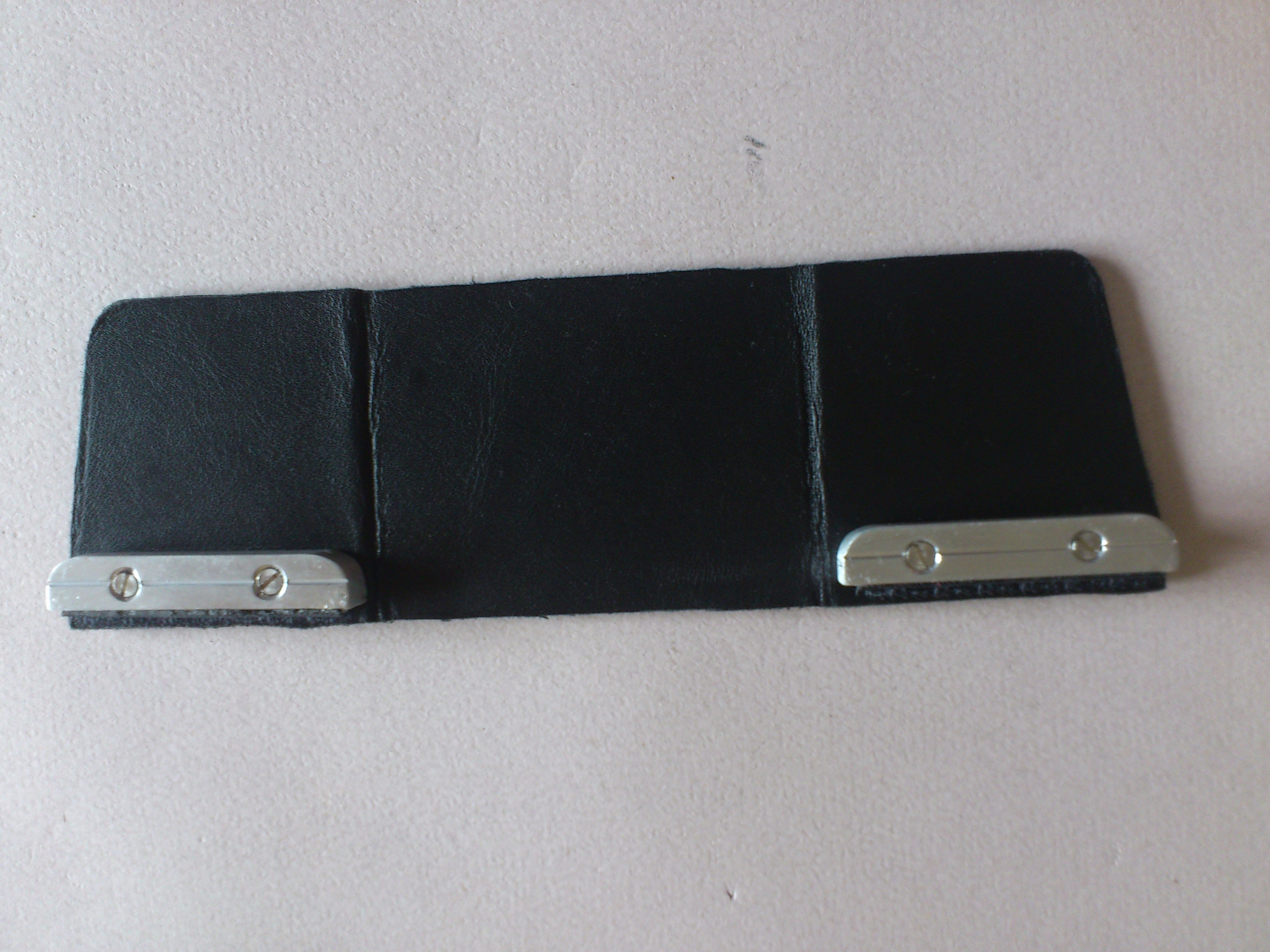

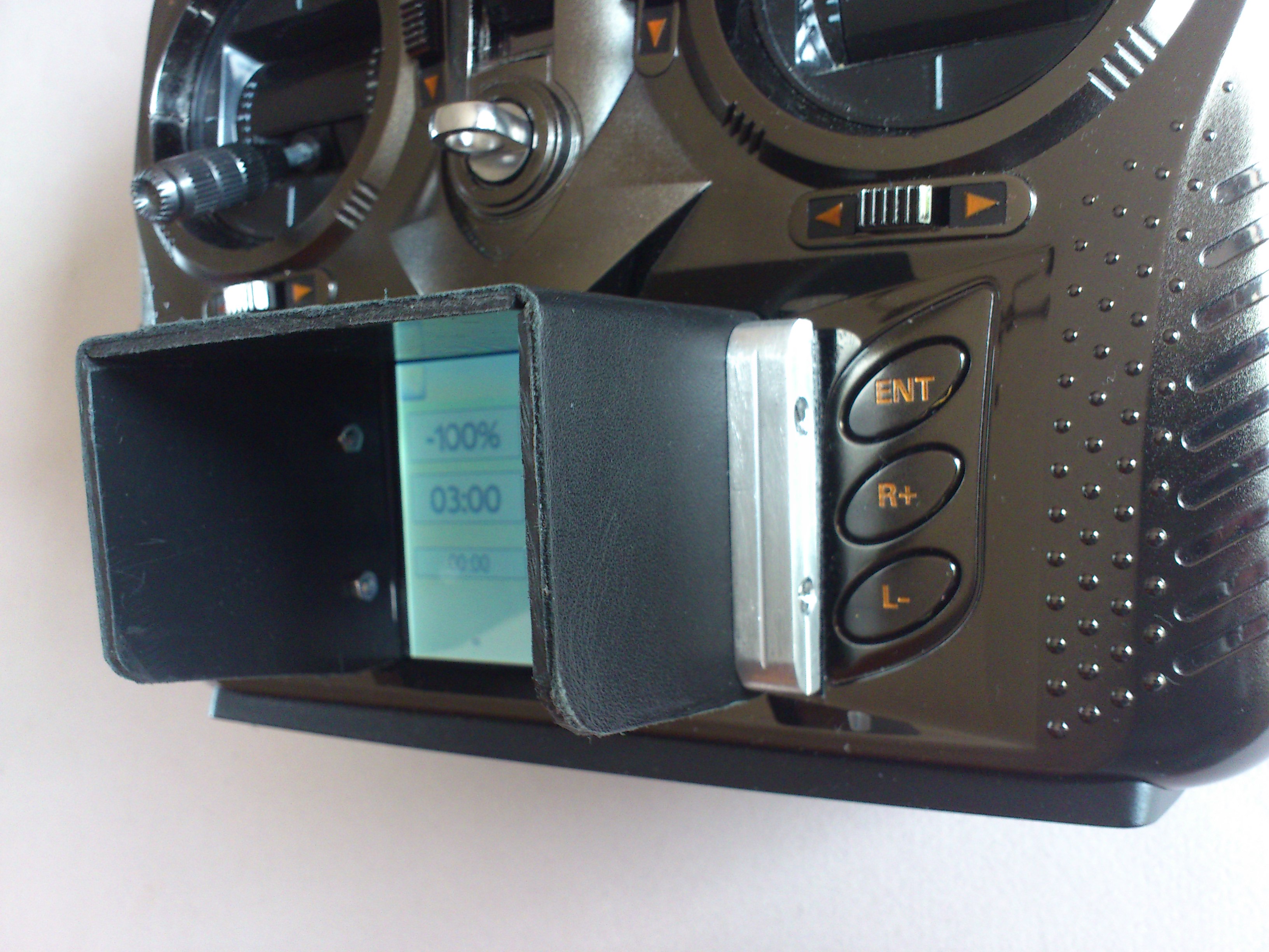

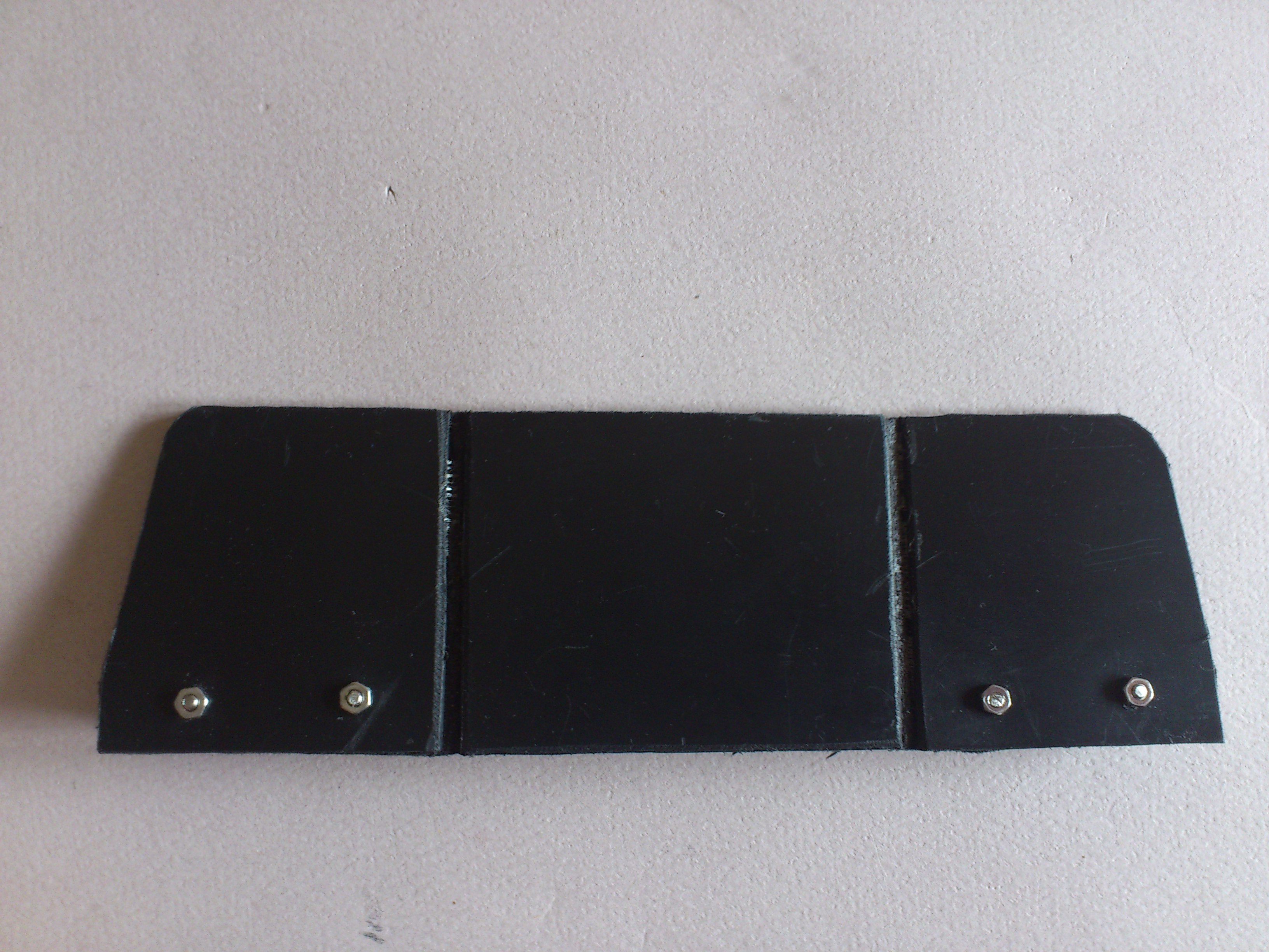

Sunshade for Devo 8 was created by saidem
Sunshade for Devo 8
It is true that the screen of Devo 8 is awful in the sun, but for the "happy" owners, this is part of the solutions to adduce
Proper installation.
Last edit: 28 May 2015 10:26 by saidem.

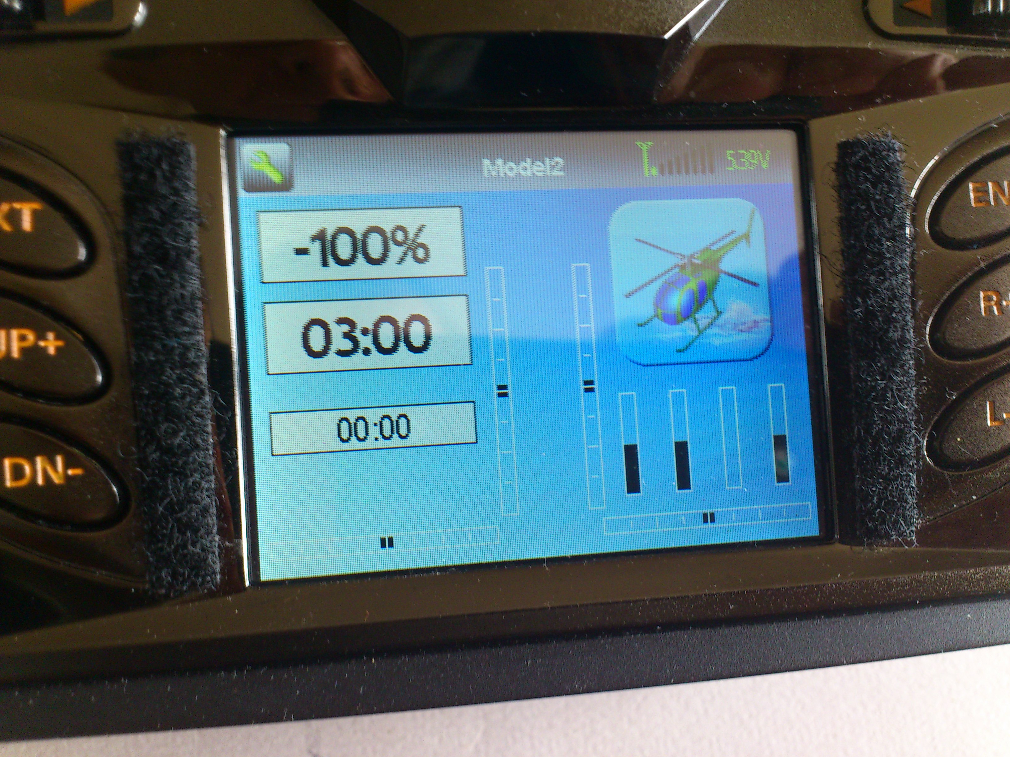

My first photos (19 to 21.jpg) was taken first, with the Deviation Original police, the photo (3.jpg) was taken last with Henkerhauss police that I'll test the sun.
