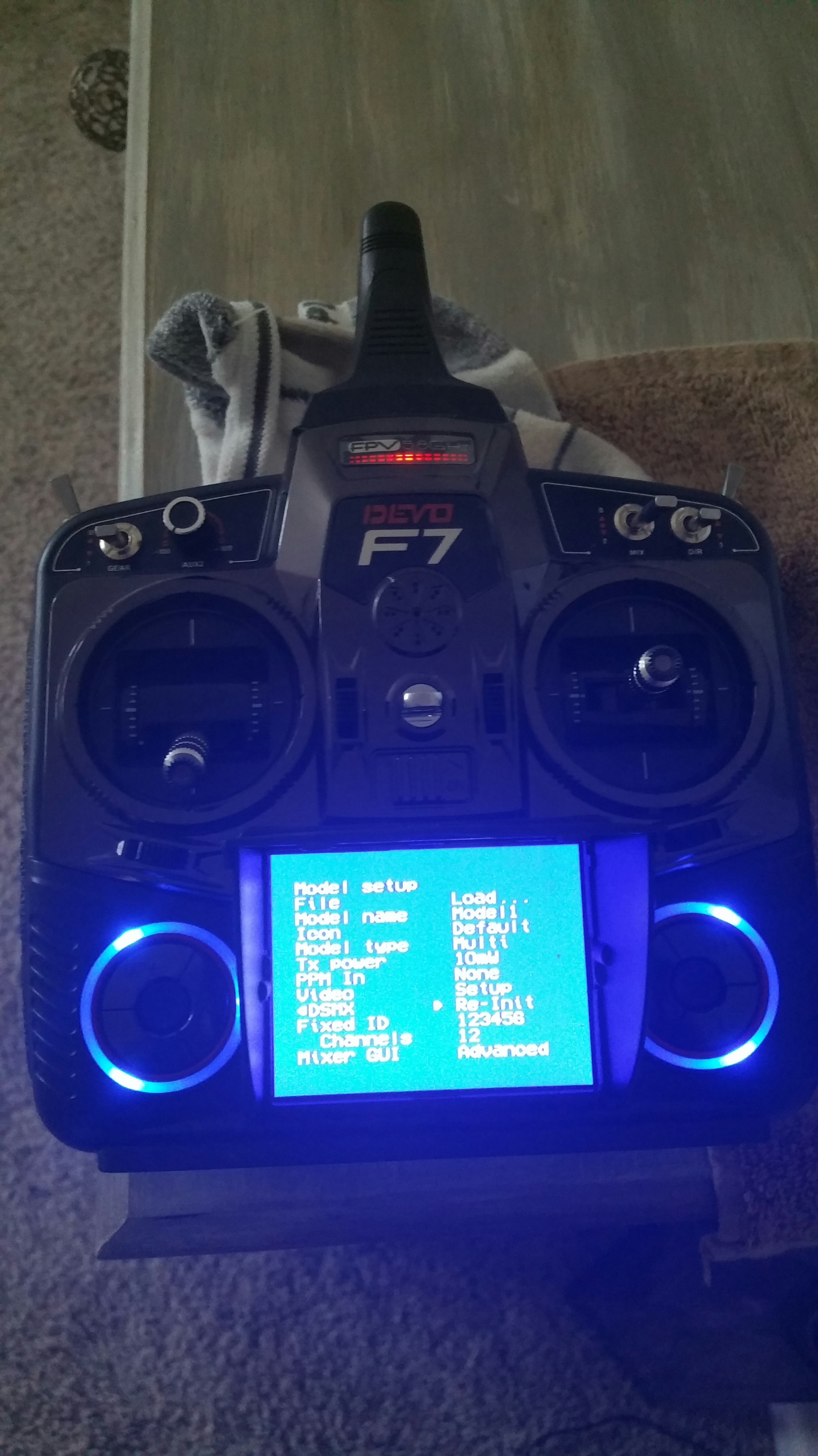

So I found a thread suggesting to also read the devo f4 thread and got a lot of help from that. On my devo f7 I was able to get dsmx and dsmx and devo protocols. I ordered my 4 in 1 so I can use my frsky receivers.
The video works great when I flew my blade fpv nano. I set my aux 2 to activate the video. At some point I accidently set my throttle to start video so I had to hold full stick to fix it.
Dsmx and dsm2 binding was very and my blade nano flew great. My cheerson cx10 dsm2 flew fine and didn't notice any issues either.
Last edit: 14 Jul 2017 18:51 by planetfpv.

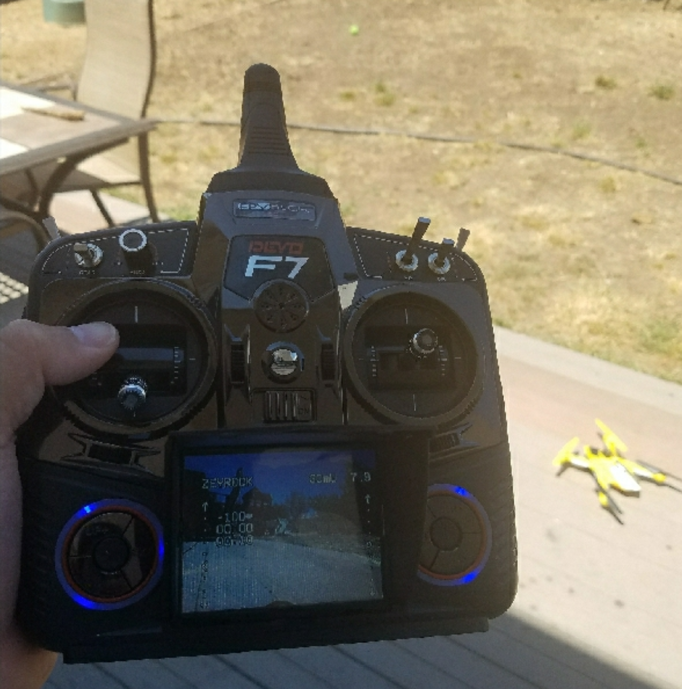

- planetfpv
- Posts: 7
14 Jul 2017 19:04 #63443
by planetfpv
There she is
Replied by planetfpv on topic How to load an F12E with Deviation(Possibly F7)
RubenRC wrote: Is fpv working on your screen? Can you bind easily? I am thinking of buying one I have a f12e out of commission until my replacement chip comes in long story. But if I can get the F7 to work the same way I'm all in!
There she is
- RubenRC
- Posts: 62
14 Jul 2017 19:07 - 14 Jul 2017 19:08 #63444
by RubenRC
DEVO F12E | Devo F7
Replied by RubenRC on topic How to load an F12E with Deviation(Possibly F7)
Nice do you have a any issues with FPV or does it work good? Did you do the 4mb mod or just stock with the firmware mod?
DEVO F12E | Devo F7
Last edit: 14 Jul 2017 19:08 by RubenRC.
- planetfpv
- Posts: 7
14 Jul 2017 20:12 #63445
by planetfpv
I didn't do the 4mb mod just deviation. The video works fine but not as fluid to set up as stock fw. I ended up changing the channel on my vtxto find my devo vrx. While setting up the video activation I accidently set my rudder then thr to control it so I only had a blue screen. I'm going to bind my runner 250 gps to it this evening to test the vide outdoors.
On my nano the first after my initial bind I had no response from the quad but it could have been the nano not the f7. It worked when I restarted both the F7 and nano.
RubenRC wrote: Nice do you have a any issues with FPV or does it work good? Did you do the 4mb mod or just stock with the firmware mod?
