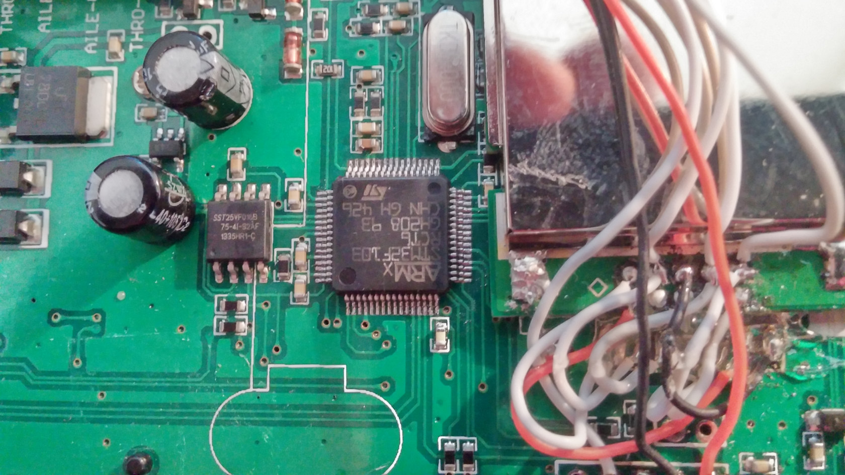

Replied by Arakon on topic Ultimate7e tutorial: Processor upgrade
Indeed.. it was one bad pin apparently. Buzzed them all against the edge of the pad and one had no connection. Oddly, it wasn't one connected to USB... nevertheless, I appear to have a fully working upgraded devo 7e now.

07 May 2016 16:46 #47977 by Arakon
Actually had to remove it again because it shifted slightly just as the solder melted.. second time it attached beautifully, except for that one pin.
07 May 2016 17:36 #47981 by silpstream
Looks beautiful sitting next to that full range module (I'm assuming that's what it is). Nice soldering job! :cheer:
