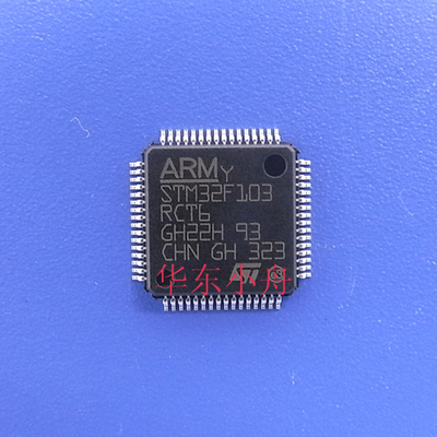

Just changed the CPU of a Devo 7e using drag soldering and everything is working fine. IMO, it's much easier than using a Hot Air Gun. However, there was a little drama the first time I soldered the chip. To my understanding, the corner with a circle indicates Pin 1. Unfortunately, the chip I got has 2 circles on 2 opposite corners. I thought the larger circle was Pin 1. Of course, that was a mistake. I had to unsolder the chip and replaced with another one. What are the chances of the first chip being damaged when soldered upside down and power was applied? I need to do another CPU replacement for my daughter's Devo 7e. If there is a big chance of damaging the first chip, I will order another one.
Here is the chip I got. The top right corner with a circle is not Pin 1. Pin 1 is at the bottom left. Don't make the same mistake as me.
Thanks slipstream for making such a nice and complete tutorial. It was very easy to follow.
