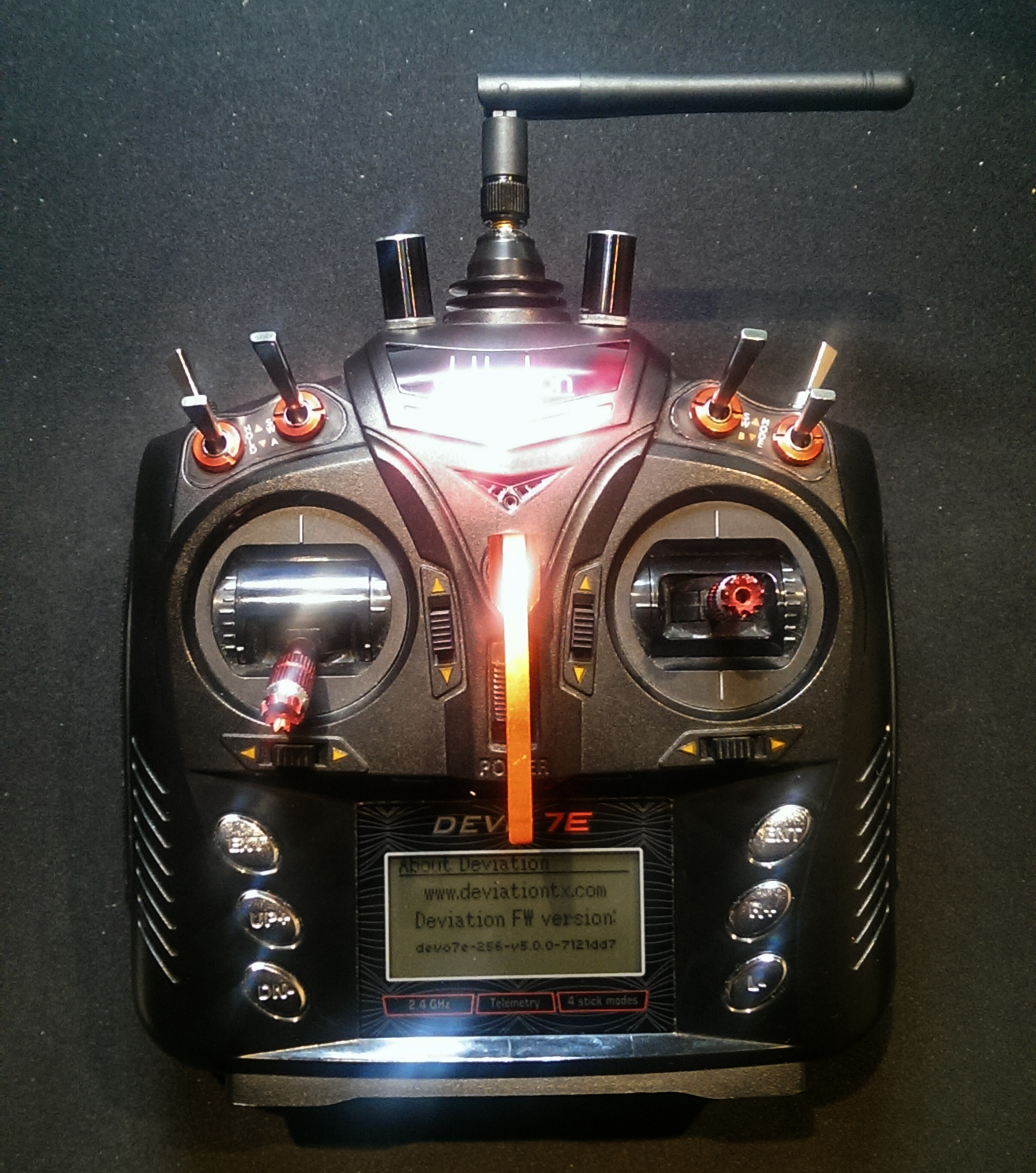

1. Devo 7e Ultimate: Multimodule - CC2500, NRF2401, A7105 + Switchmod + 2x Poti
2. Devo 7e Ultimate: 4in1 Modul, still upgrading
Hobby Horizon 350 QX, QAV250 FPV Racer, JXD385, WLToys 272, Estes Proto X
Replied by Smarti on topic Ultimate7e tutorial: Processor upgrade
Add another Ultimate 7E successfully upgraded to the list!
MultiMod / Switchmod seems to be working. Just some testing missing.
But looks good so far!

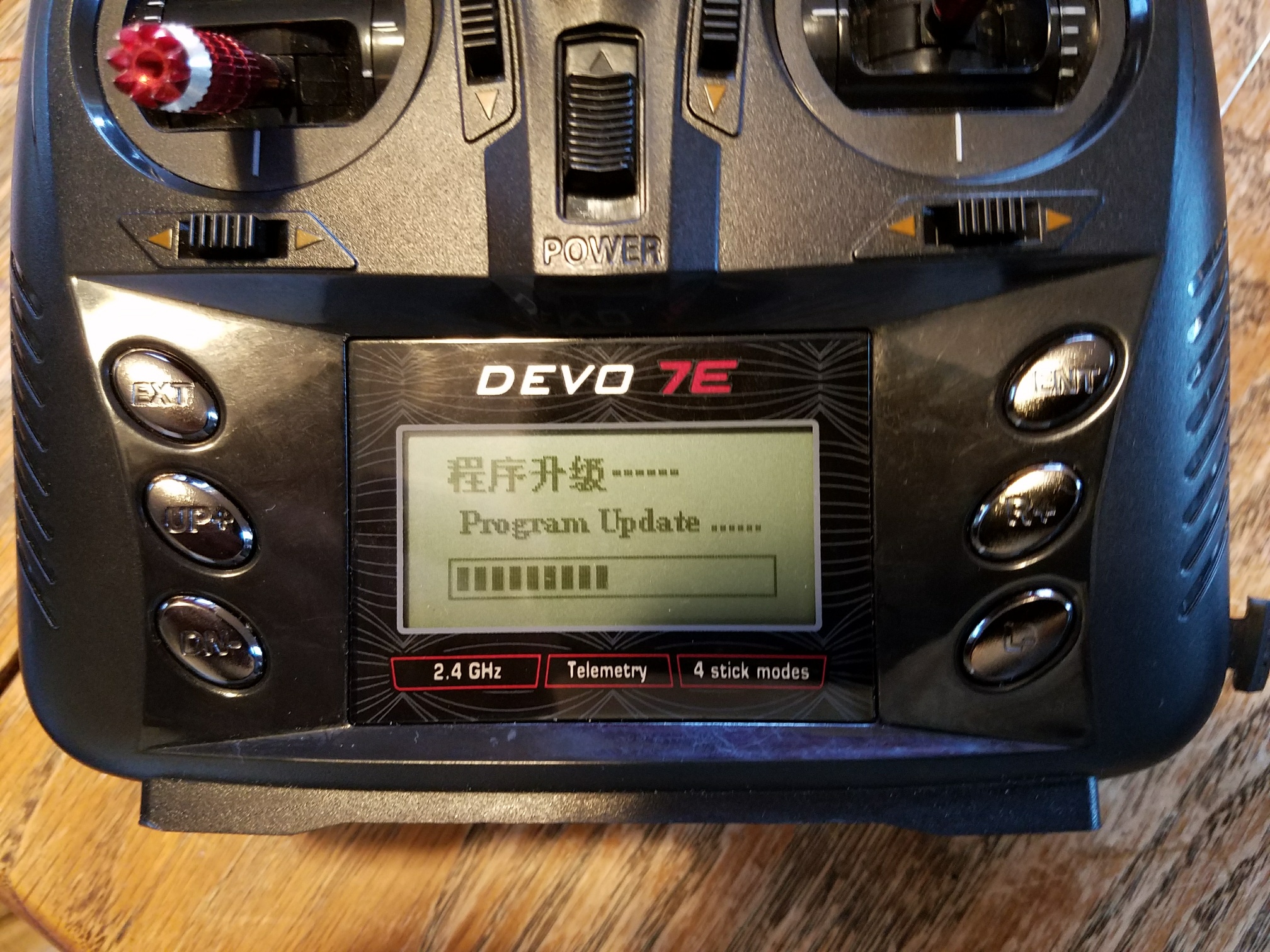

I just did an MCU replacement on my second Devo7e. It is installed and I was able to load the bootloader just fine. However I can't load Deviation as Defuse doesn't recognize the device.
When I power up the transmitter it immediately goes to the program update screen without any buttons being pressed. Is this normal before deviation is flashed or does it mean that I have a bridged pin somewhere in the button matrix? If there is a bridged pin could this be keeping the usb from being recognized or is that a seperate issue.
I have checked that the usb tx and rx lines are connected to the pins on the mcu. Are there other places to check?

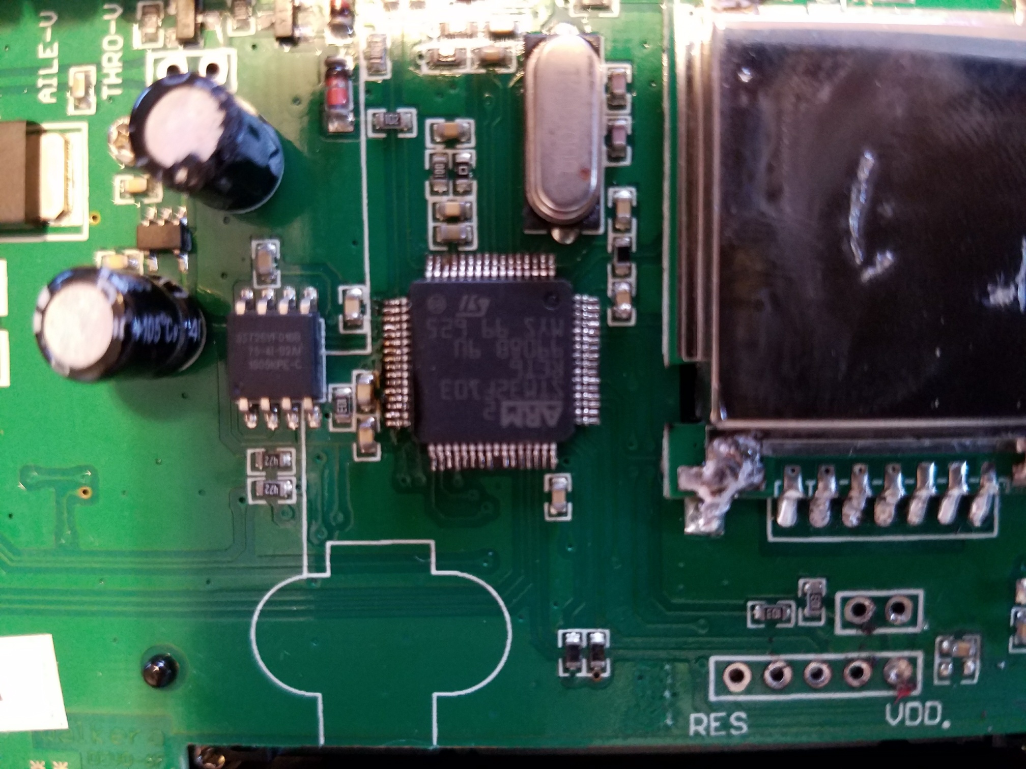

This is driving me nuts I am so close. After mcu flash it powers on to the program update scene like it should but it is not recognized by sub driver and defuse.
I have checked and rechecked for shorts on the pins. I have tested continuity from pin to pad on all mcu pins. I have tested continuity on the usb cable to pins on the mcu.
I just updated the firmware on stink tool and reflashed the bootloader again after full chip erase. All went perfect. Did a compare of the file and mcu this verified.
Any ideas where to look. I did knock a capicator loose when removing mcu. I put it back with hot air rework tool. This capacitor was neat pins 60-64.
I have reflowed the pins on all four sides
twice no change.
I verified it isn't my computer by connecting my other U7e. It connects fine. I am about ready to try another mcu as I have a spare.
I am attaching photos and asking for any advice or suggestions. This replacement is so much cleaner than my first but doesn't working.
twice no change.
Last edit: 17 Apr 2017 16:06 by compman2.

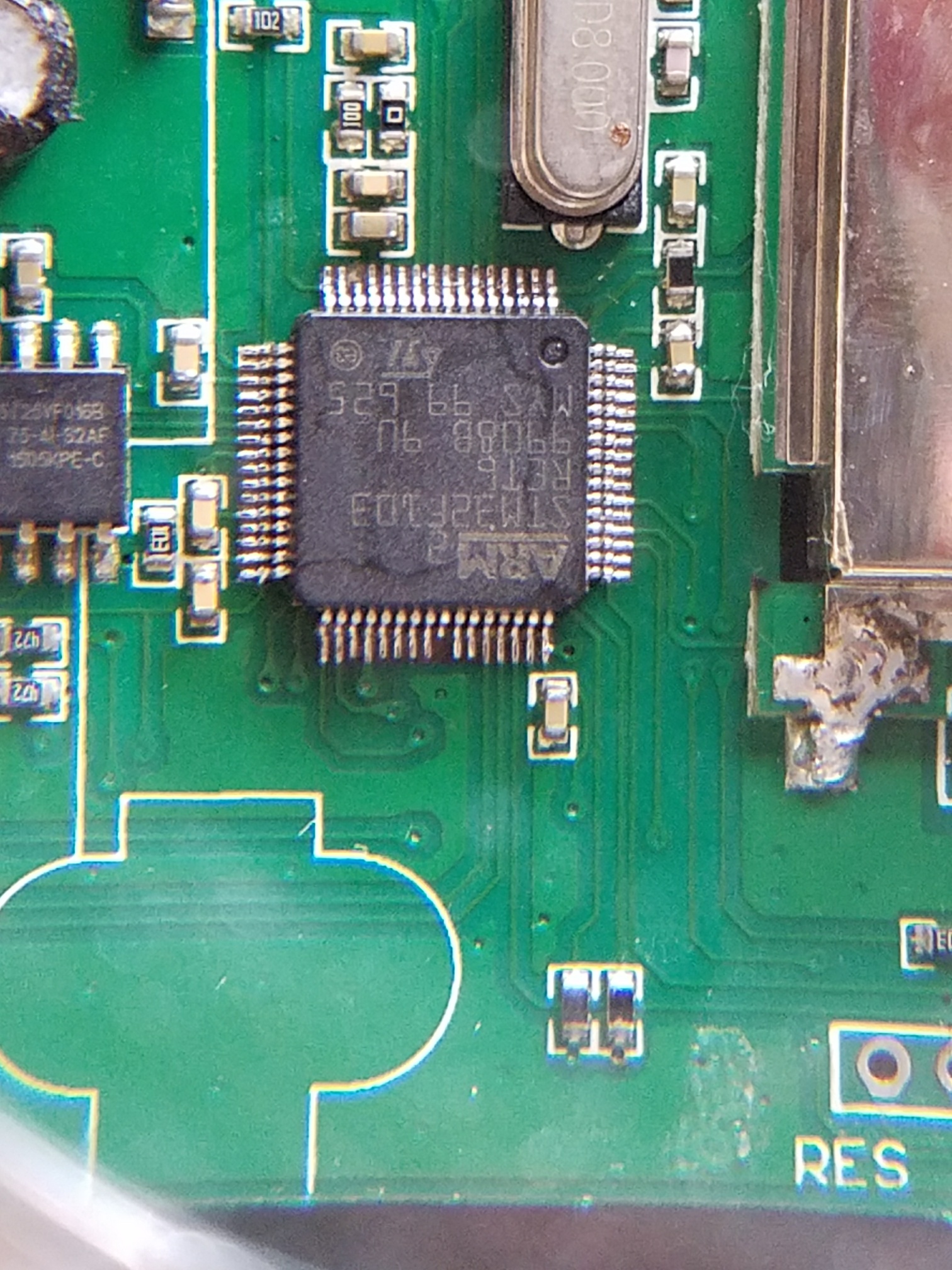

On power on, does it boot into Program Update mode on its own as you said before? Or do you need to press the EXT button? If it is booting to update mode without EXT being pressed, something is shorted/bridged somewhere. A few posts up from here mention is made of Pins 61 & 40.
Not sure if it is the photos or lighting, but there are a couple pins on your MCU that are not looking to be soldered well, and the row of pins furthest from the RF module do not look to be particularly tidily soldered. It may pay once more to flux and run a fine round tip soldering iron over them all again.

It's a poor photo combined with some extra flux because I have been over the pins quite a lot.
It is going automatically to program update, but I thought I saw somewhere that this is default behavior until software is loaded with defuse. I may be wrong about that and forget how it worked with my other U7e.
I have checked all pins in the button matrix for shorts and couldn't find any even checking them for non adjoining pins.
I am looking for the magic bullet as I am out of things to try.

Not sure of what flux you used, but a really good scrub with some isopropyl alcohol should clean it off - it is possible there is very fine solder bridges. I have had that before where even under the strongest loupe I have nothing showed.
I too am not 100% sure, but I am thinking I had to hit EXT to boot into Update mode for the first time on both Ultimates I have done.

I have tested for bridging of pins with multimeter and with fine needle like tips. There is no pin bridging.
What would keep the bootloader from turning on usb MODE? I noticed on the wiki that there is s pin to turn on usb mode. Is there a way to force this like tie the pin to ground?
Can you test the button matrix with a multimeter to see which if any button is pushed/on?
Is it possible to flash the dfu file to the chip with STLink utility?
Here is a much better photo
