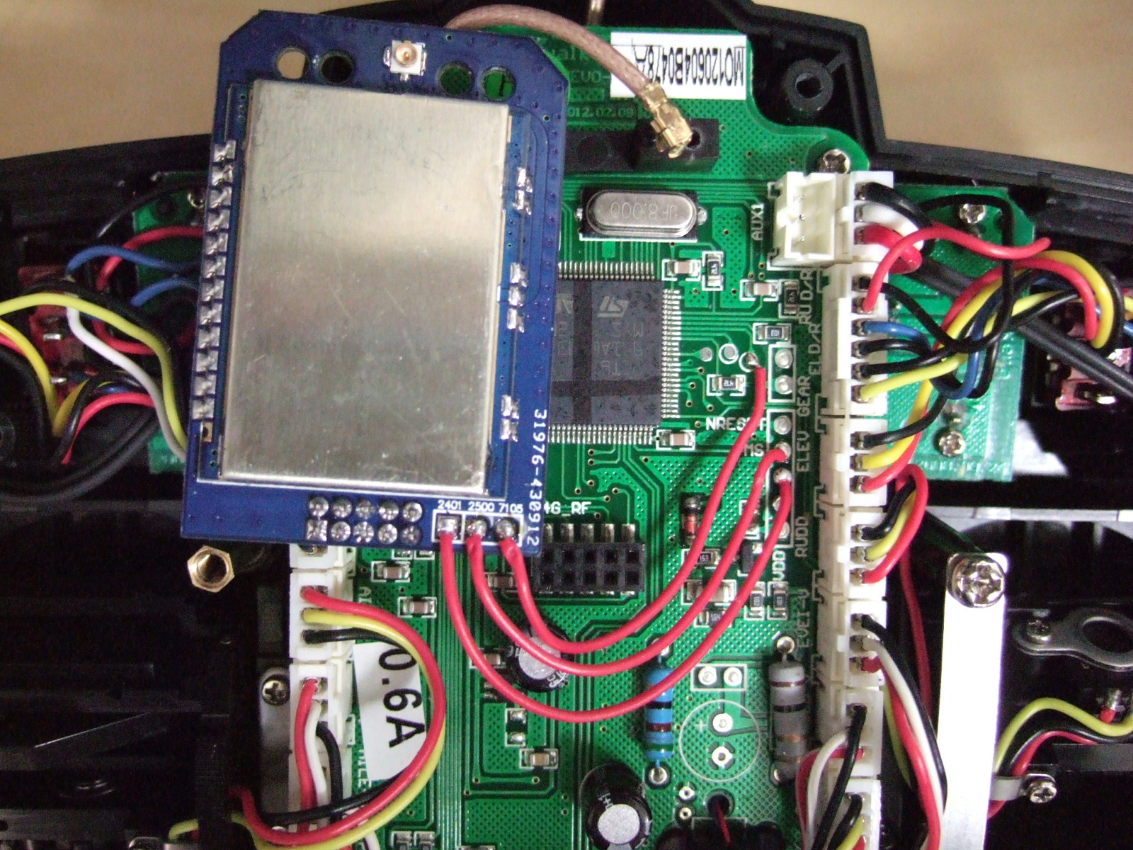

First post here I hope I'm in the right place for this. I've had my 4 in 1 module for about a month now waiting on my DEVO 10 to arrive. It finally got here yesterday so I updated to the nightly build of Deviation first no problem at all. Then I opened the case and installed the module, went in and edited the hardware file and fired up the DEVO. This is when things didn't go so good. I got the missing module warning. I've went back and triple checked everything I can think of and reinstalled Deviation a couple of times and I'm still getting the warning. If anyone can point me in a direction to cure this it would be appreciated. I've read on this board till my eyes are crossed and tried all that I can find. HELP please!! Should I try to roll back to an earlier build?

A detailed picture of module installation with wiring could help....
Also hardware.ini
Also hardware.ini

Here's the hardware.ini & pic of the installation. Hope this helps. This is the original hardware file before being edited. The one on the devo has the semi colons removed. What I'm not sure about is the connection point numbers. (not sure what they're called)

You have two modules both on a14, I think nrf module should be B7 on devo 10
Anyway please post the current hardware.ini to fully check (without semicolons).

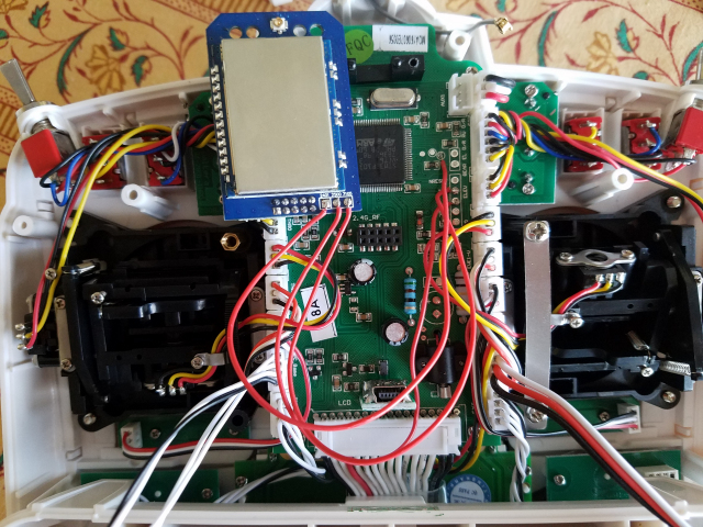

Too late info sorry, attached picture are my case.
Tested CYRF6936 and CC2500, but not tested A7105 and NRF24I01.
