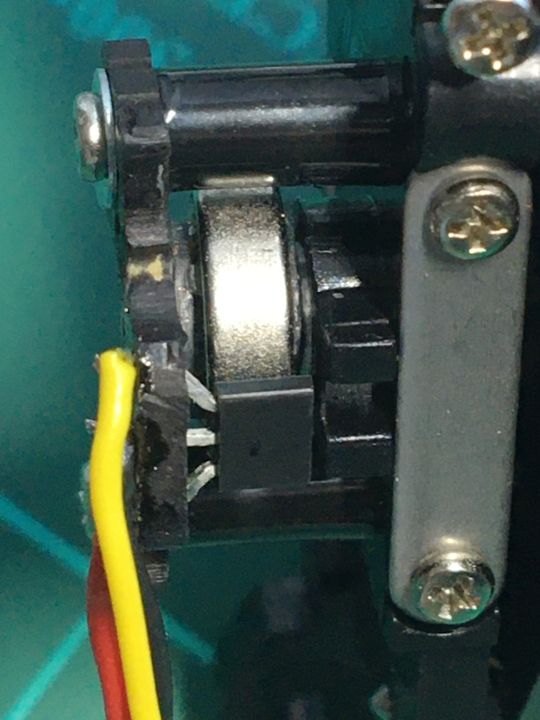

I was fascinated by the modification of the original Devo Sticks with Hall sensors as described here: mcheli.blogspot.com/2020/01/diy-hall-sensor-gimbals.html
The components were cheap and the modification can be reset at any time without damage of the Transmitter, so I decided to start this project.
The modification is described very well and easy to understand, I can't add anything to it. Many thanks and compliments to the author!
After the assembly was finished it was very important to recalibrate the sticks of my Devo 12s. The control feeling is not different than before with the potentiometers.
I have already tested the modification daily for one week with my micro helicopters Walkera 4#3b (FP, Double BL, 52gr with battery) and Blade mcpx V1 (CP, Double BL, 51gr with battery). These two helicopters are very very nervous and it is important to control them very precisely. I did the flights indoor to have a better comparison without the influence of wind. On the sticks both helicopters feel the same as before, I could not feel any difference.
In comparison: My biggest helicopter, a Blade 180CFX, was still very calm in the air, also indoor tested.
I am very satisfied; it is a complete success, simple, uncomplicated and resetable.

After several outdoor flights with my helicopters and airplanes I can report that the control feeling:
Stick movement => Flight behaviour
by using the Hall sensors exactly feels the same as before with the potentiometers.
