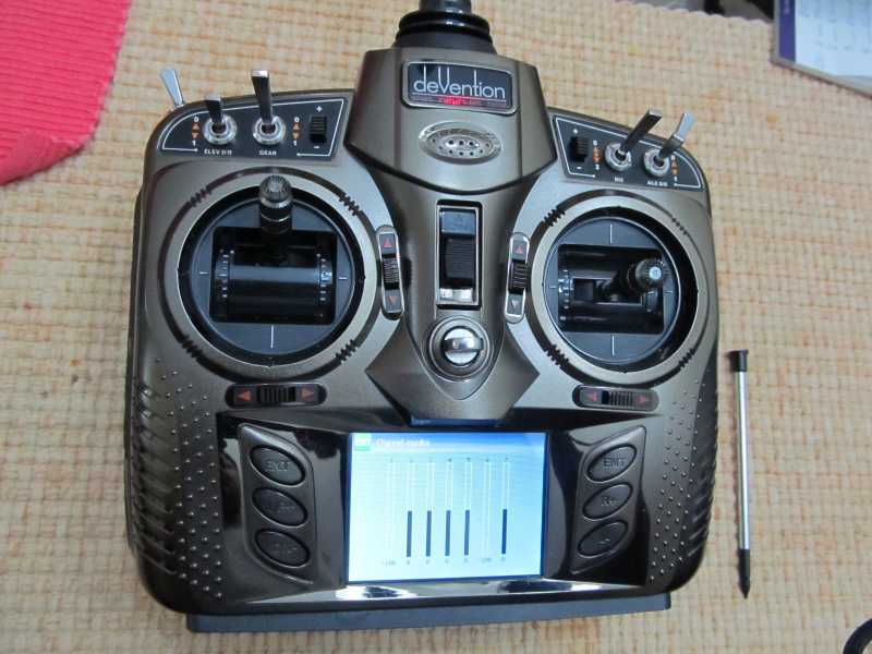

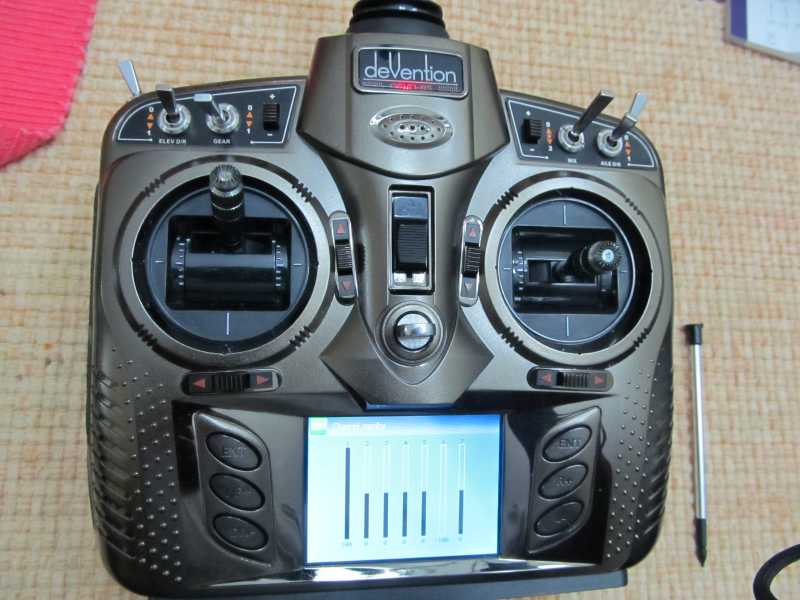

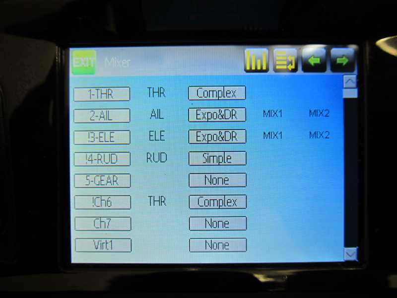

Replied by Spyro37 on topic Blade 300x with AR7200BX BeastX
Utilizing the Blade 300X file (above), I took some picture regarding the throttle hold issue.
- On the first picture (img.2144) it shows that the Gear switch is "NONE", not active? I suppose.
- Second picture (img.2145), I am on full throttle stick position, monitor bar shows that I am running full throttle, with the Gear switch on DOWN position.
- Third picture (img.2148), toggled the gear switch to UP position, executes throtlle hold
Last edit: 09 Jan 2014 01:51 by Spyro37.
- WheresWaldo
- Posts: 253
09 Jan 2014 05:27 #18262
by WheresWaldo
Replied by WheresWaldo on topic Blade 300x with AR7200BX BeastX
Easy answer:
Look at [channel1] and tell me what you see.
Hint - safetysw
Hint - It's set on with Gear0
Hint - the value is -100 when on
So how would you change it to be switch up normal throttle, switch down throttle hold.
Hint - Gear1 is the switch in the down position
Hint - safetysw
09 Jan 2014 06:06 #18263
Replied by FDR on topic Blade 300x with AR7200BX BeastX
That's not the GEAR switch, but the GEAR channel.
Your TH config is under the first button (1-THR), which is the throttle channel config page. There is a safety switch, whitch you should change to RUDD_DR...
