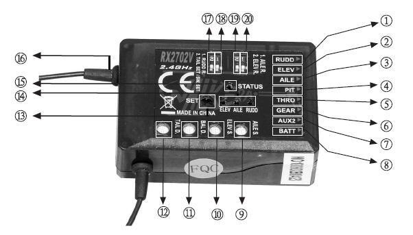

need help from you guys...regarding my walkera v450d01 setup with RX2702V-D
with my devo8s transmitter.i bought this heli as bnf set.but i am not able to set it properly...every time when i tried to lift up heli is spinning..so fast
as i am not prof..haveing hard time to find the problem...please help

Replied by rbe2012 on topic Walkera V450D01 rx2702v-d devo 8s
It looks like your gyro direction is wrong so it moves the tail servo to the wrong side. The tail shall be corrected but the error will be improved instead. Did you check this?
There are gyros where you can not change the direction. Then you can moubt it upside down.

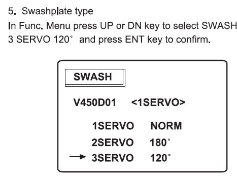

This is my DEVO 8S setup.
Swash Type: 3 Servos 120°C
Reverse switch
Elevator : Normal
Aileron: Reverse
Throttle: Normal
Rudder: Reverse
Gear: Normal
Pitch: Normal
Gyro: Normal
Gyro Sensor
Mode: Manaul
Switch: MIX SW
Pos1: 70%
Pos2: 50%
Pos3: 50%
Swash Mix
Aileron: + 70%
Elevator : +70%
Pitch: +80%
fmode normal
heli pushed violently of the ground
