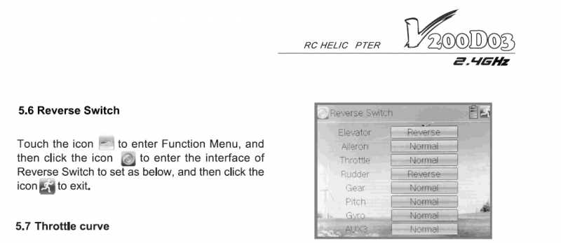

You can download one of my models below and make the following changes.
Reverse the servos for ELEV and RUDD
See my picture.
Before you fly make sure the servos are working in the correct direction.
Also make sure the RUDD is working in the correct direction. Give a little throttle when the hei is on the ground and give some rudder and check that it is working in the correct direction.
I don't have the V200D03 or I would make a model for you and test fly it.
