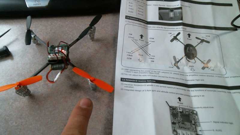

ok so i figured this out , the back (rear)right motor is spinning the right way (just like the manual , but for some reason it blows air up ? , i swapped the motor and it still dose the same thing ( i have spare motors) so i flipped the motor upside down and it almost flies the right way , very strange
and now after it binds to the transmitter the transmitter continues to blink?
so my friend just fount my original lady bird , and its doing the same thing (it used to fly just fine) so i reversed the wires on the moter that was blowing air up , and now they all create lift , but it want to flip to the left , wtf , could the transmitter be bad ? i have no clue ...............

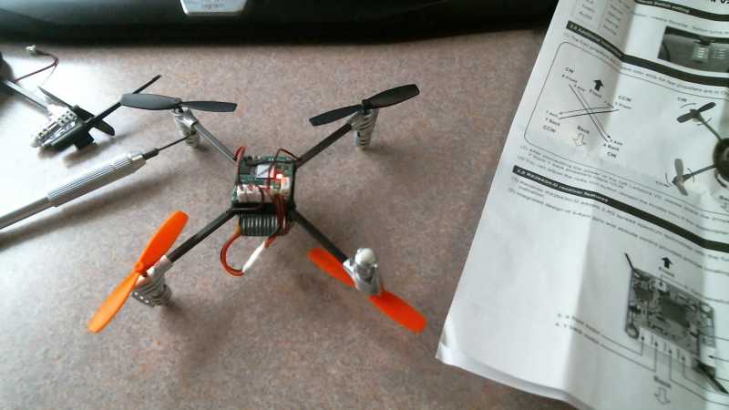

You have the props on incorrectly. Start with getting the motors spinning in the right direction as per the manual, then check that the prop you put on each motor will create lift from the direction it is supposed to spin - should have been the first thing you checked, not just the direction of the motor - prop needs to be correct as well eish
Looking at your photo it looks like you have 2 of the same direction type prop (the orange ones) which is wrong. You need one for RH direction and one for LH direction, check the black props for what I mean.

vlad_vy, in his pictures it seems he has 2 x counter-clockwise orange props, even with motor direction correct, like this it will not fly.

ty all , i had the props on wrong , flys great again !!!
