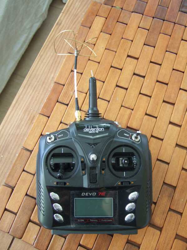

- SeByDocKy
- Posts: 1016
04 Dec 2013 13:06 - 04 Dec 2013 13:39 #16273
by SeByDocKy
i ) I use this antenna ...
ii) Yes most of the time I have to rebind ...
Replied by SeByDocKy on topic Wltoy V959 upgraded v222 and DEVO7e with nrf24l01
Sascha121985 wrote: Ok. What for a antenna do you use?
Do you have to rebind it every time?
