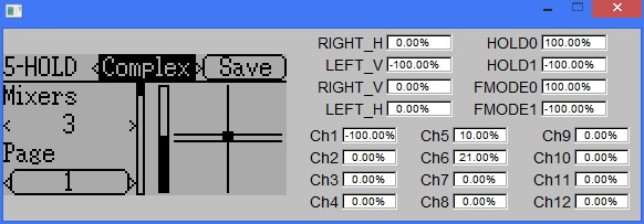

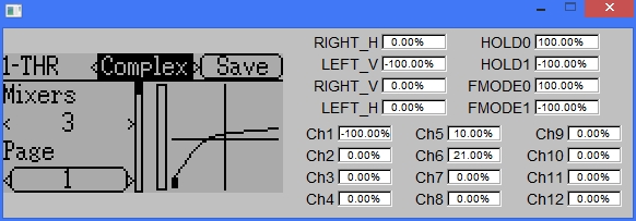

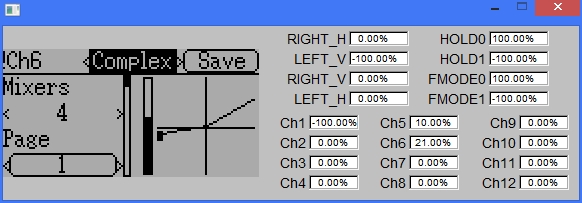

Advanced mixer mode is complex and confusing to learn. It took me a while to figure it out using the emulator and trial and error of testing the model in my helicopters and quads.
Your Devo 7e will use hold1 for TH so that is correct.
I set TR to Rudder DR Switch on Position 1 for the model which I made with my Devo 10.
If you use the model on the Devo 7e or Devo 12 the TH will change to hold1.
The models I make on this site must be made in advanced mixer mode for the complex settings I want to use.
I would not try to use my models if you change it to standard mode.
Even though you found pitch curves for idle up missing, all the other settings, channel assignments, switch assignments and other things must be correct. There should also be no virtual channels either.
Trying to fly this way could cause the heli to freak out in flight and crash.
I can change the DR/EXPO for you very fast and easy and post the model for you. What settings would you like?
