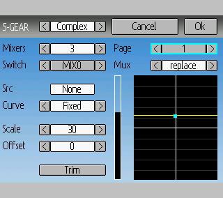

I have the gyro gains on the "Mix" switch with 3 of the most common values used on the forums/internet. These are used for beginners, standard, and 3D fliers.
You can fine tune the gyro gain to your preference in the transmitter settings but first get rid of any vibrations.
Gyro gain for the Devo 8/10/12 are in Mixer, 5-Gear (Complex). Change the "Scale" value for the gyro gain.
If you are using the Devo 7e then the gyro gain will default to my 65% value due to the 7e doesn't have a "Mix" switch. Mixer, 5-Hold (Complex). Change the "Scale" value for the gyro gain.
You need to convert the gyro gain values. See my post here: deviationtx.com/forum/how-to/2620-conver...-to-deviation-values
"Scale" at the value of "30" is equal to the Align gyro gain of 65%.

Also, how did you set the roll rate and the gain?
Do you know what are the curve types in the esc config??
I have to keep configuring everything because I don't like how it flies at the moment.
If you can share your actual configuration I would appreciate it.
Last edit: 14 May 2014 20:48 by manuwind.

I got the heli working perfectly. Tom Z's models are the best.

Using DSMX Sat and my Devo 10 I had some binding problems. Switched to 8 channels and everything works just fine (also 6 channels did work).
