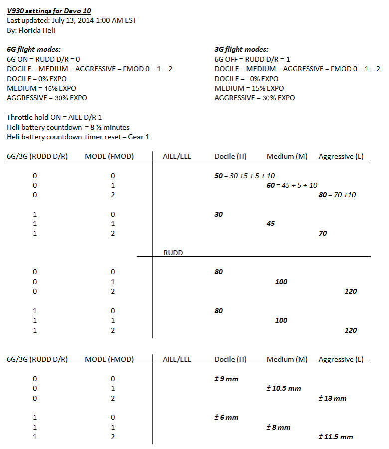

Here is a Devo 10 model.ini file customized for the v930. Thanks to Ben1977 for the help with the mixers!
This file should be used only with the linkages on the swash plate inner balls. This is the way mine arrived out of the box.
Highlights:
6 flight modes:
6G Docile
6G Medium
6G Aggressive
3G Docile
3G Medium
3G Aggressive
Throttle hold
Heli battery countdown timer - 8 1/2 minutes
Exponential in all modes except Docile
Documentation - attached
EDIT 07/13/2014:
Model file has been updated to correct bug with trims being overridden in certain flight modes.
Docile-Medium-Aggressive flight modes adjusted for smaller increments between Docile and Medium.
Added exponential to all flight modes except Docile.
EDIT 12/21/2014:
Corrected mistake in expo. New version is 1.5
If you are using a prior file, please update to this one.
-Florida Heli-

03 Sep 2014 14:21 #25481
by sfersystem
Replied by sfersystem on topic WLtoys v930 with 6 flight modes
Thank you for sharing. Do u know if these model feet to the V977 ?
- Florida Heli
- Posts: 8
06 Sep 2014 17:05 #25524
by Florida Heli
Replied by Florida Heli on topic WLtoys v930 with 6 flight modes
No because the v977 is collective pitch and the v930 is fixed pitch.
-Florida Heli-
