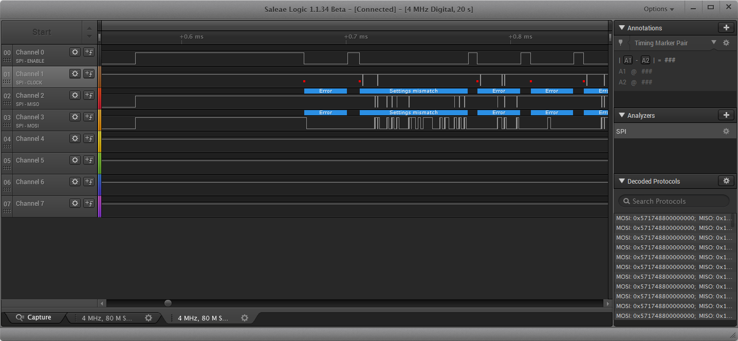

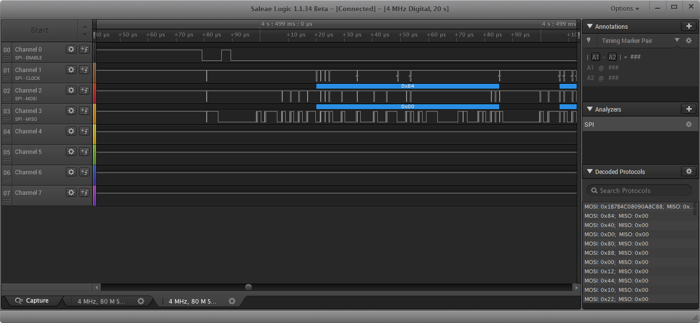

I've hooked up my Salea to the CX-20 stock TX and checked the lines connected to the transmitter module. There are 6 lines from the TX board to the module, and line 1 is definitely ground. The remaining five lines are less obvious. I cannot see any activity on line 6, so i've concentrated on lines 2-5. When I get the capture, here's the pattern I've seen. The first photo is the initialization of the board when it is turned on. The second photo shows the pattern that happens 10 seconds later, presumably bound to the receiver.
I don't think this is exactly what i should be getting. Can anyone look at this and tell me if anything is missing? I don't think this is exactly what i should be getting. If you need to see the entire capture it is at dl.dropboxusercontent.com/u/31578062/CX2...%20%5B8%5D.logicdata .

Looks like maybe you're on the right pins but the sample rate is too low. Start with a high sample rate to get an idea of the spi clock frequency.
