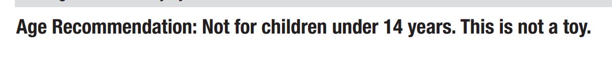

09 May 2015 11:57 - 09 May 2015 12:24 #32292 by Sero
In the videos, you can see them doing all sorts of things, like flying planes upside down VERY close to the ground, inverted with helicopters, landing and starting on water, speedy passes again close to the ground. NONE of that is for beginners, and need lots of practice to do so.
Those RC models are NOT toys, as you seems to think, and HH says so clearly in all manuals.
