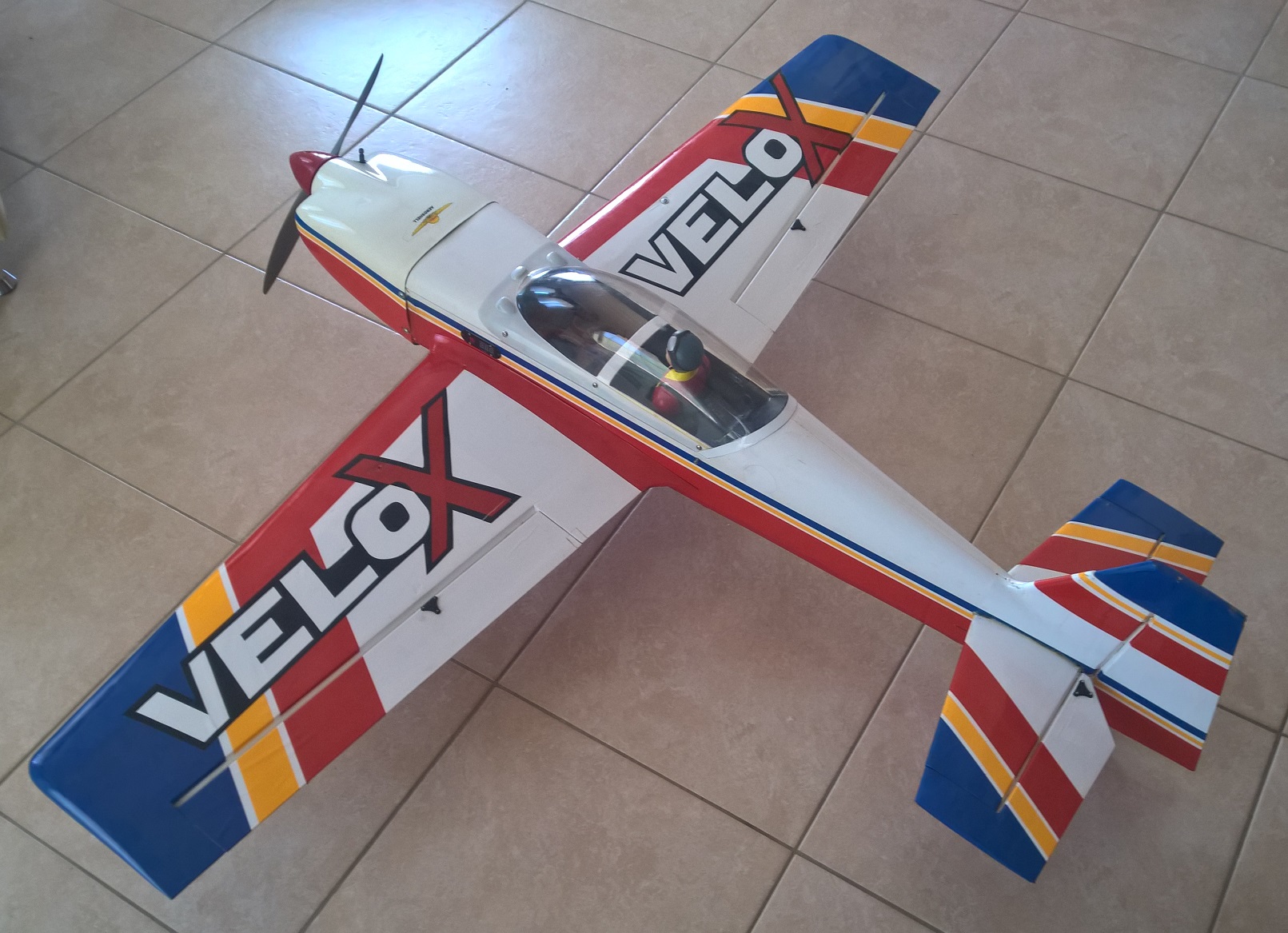

...and by the way, this is the bird that will use this .ini.
01 Jun 2016 04:08 #49699
Replied by FDR on topic Selective trim
Dögös!billmester wrote: ...and by the way, this is the bird that will use this .ini.
