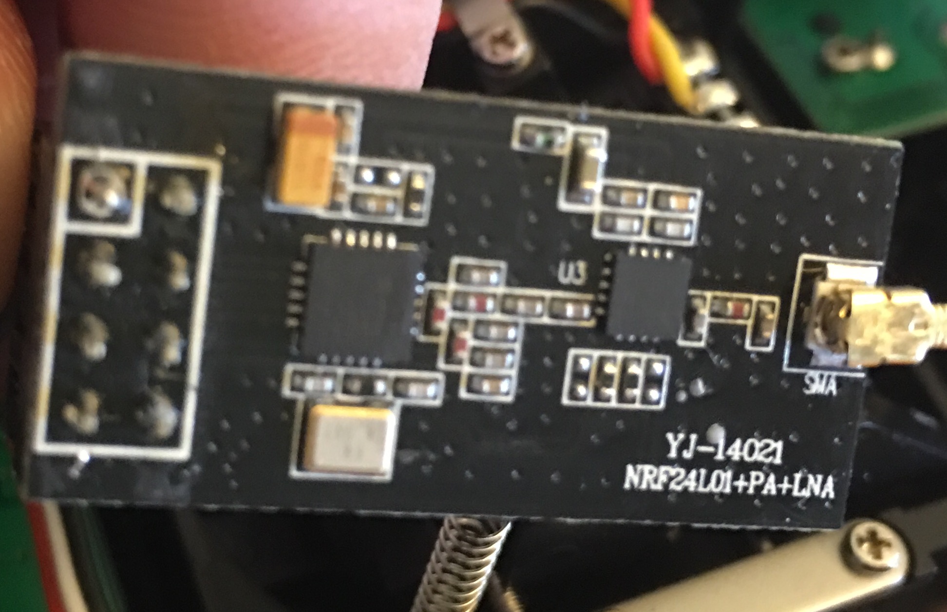

11 Jun 2016 17:27 - 11 Jun 2016 17:28 #50408
by caughron01
Replied by caughron01 on topic Cheerson cx-10a cx-10w cx-10c
Ok I got it open the I have attached a couple images of the chips I saw. Not sure what is what inside there honestly. Thanks for the help I really appreciate it as I'm trying to learn this.
Last edit: 11 Jun 2016 17:28 by caughron01.
- HappyHarry
- Posts: 1136
11 Jun 2016 19:08 #50413
by HappyHarry
Replied by HappyHarry on topic Cheerson cx-10a cx-10w cx-10c
that's the main mcu and a voltage regulator, see the large rectangle that's a silver box, about 2" x 1 1/2" are their any extra wires soldered to that going to a seperate small pcb? if not your tx is totally stock
- caughron01
- Posts: 25
11 Jun 2016 20:58 #50428
by caughron01
The silver thing in the first pic thats below the big black square module?
- HappyHarry
- Posts: 1136
11 Jun 2016 21:21 - 11 Jun 2016 21:22 #50432
by HappyHarry
Last edit: 11 Jun 2016 21:22 by HappyHarry.
- caughron01
- Posts: 25
11 Jun 2016 22:25 #50435
by caughron01
Ok so now I understand I do not have any mods should I add the nrf and the other one in the pic would that open up to a lot more stuff I can control?
Where do I get them and are there instructions here to install those?
I have a pretty fair hand when it comes to soldering just need to k ow my input locations. Thanks so much Harry you've opened my eyes on what this controller can really do.
- HappyHarry
- Posts: 1136
11 Jun 2016 22:54 - 11 Jun 2016 22:58 #50436
by HappyHarry
no probs bud, we're all here to help and be helped after all
yeah adding extra rf modules opens up the use of models that use those specific rf chips for their protocol. the stock devo rf board will do devention (obviously lol) and when you install deviation it will also work with spektrum dsm2/dsmx. so if you want to fly models and use rx's that aren't one of those you'll need to add modules.
having a read through the wiki would be a good starting point for modding information
www.deviationtx.com/wiki/
but also there is a new module that's recently been released that contains all of the commonly used rf chips in one module which isn't mentioned in the wiki yet, also there is a newer revision of it about to be released that will be practically plug and play (bar soldering 3 wires) for the devo10 that also fixes a few issues from the initial version. you can find the info on that board here >> www.deviationtx.com/forum/7-development/...-3in1-4in1-rf-module
Last edit: 11 Jun 2016 22:58 by HappyHarry.

- caughron01
- Posts: 25
12 Jun 2016 19:09 - 12 Jun 2016 21:36 #50483
by caughron01
Hey Harry I went in for a double take today and I found out that I do have that module needed for the cx-10. I have included a picture of my module.
Is there something I need to do to activate or switch to the NRF module?
Last edit: 12 Jun 2016 21:36 by caughron01.
- HappyHarry
- Posts: 1136
13 Jun 2016 00:01 #50500
by HappyHarry
cool, is it soldered in to your d10? if so you'll just need to enable the module in hardware.ini and setup the model with the correct protocol. all the info you nees to do this is in the wiki I linked you above and in the manual >>
www.deviationtx.com/user-manual/user-manual-7e-10
if it's not soldered in you'll need to do that first, again the info for that is in the wiki
- caughron01
- Posts: 25
13 Jun 2016 01:21 - 22 Jun 2016 23:49 #50515
by caughron01
Its fixed, turns out my board was bad.
Last edit: 22 Jun 2016 23:49 by caughron01.
