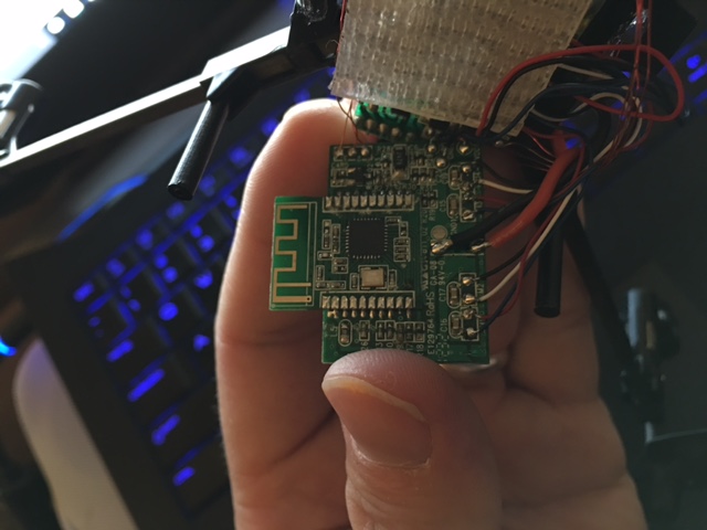

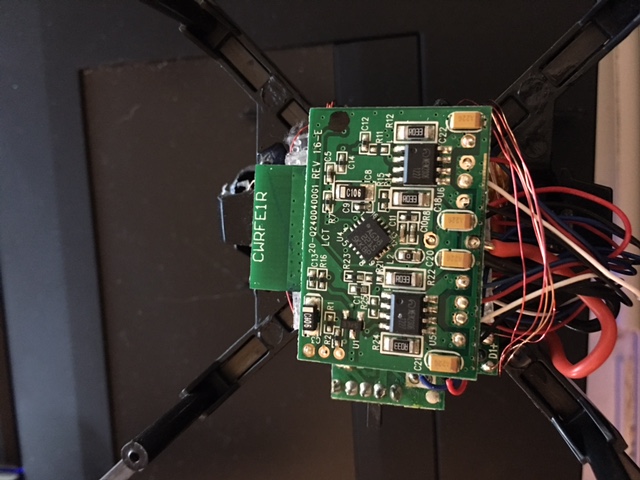

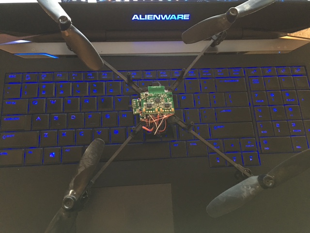

I removed all the Styrofoam so now its just a plastic frame and other required parts. It is using a module that has the name CWRFE1R stamped on it.
I can only find this link for info on the module, fccid.io/document.php?id=1793105
Can anyone tell me how I can get this thing to work with my Devo 10?
30 Jul 2016 23:26 #52304 by bazsound
Replied by bazsound on topic Call of Duty Quad Setup Devo 10, Help Please
looking through that document mentiones that it used the nrf24le1 which it states is almost the same as the nrf24l01.
we use the nrf24l01 for the wltoys v977 v966 v931, and a few other helis (hisky i think plus some) so that module is supported in deviation, but the protocol for that quadcoptermight not be.
It would require reverse engineering.
