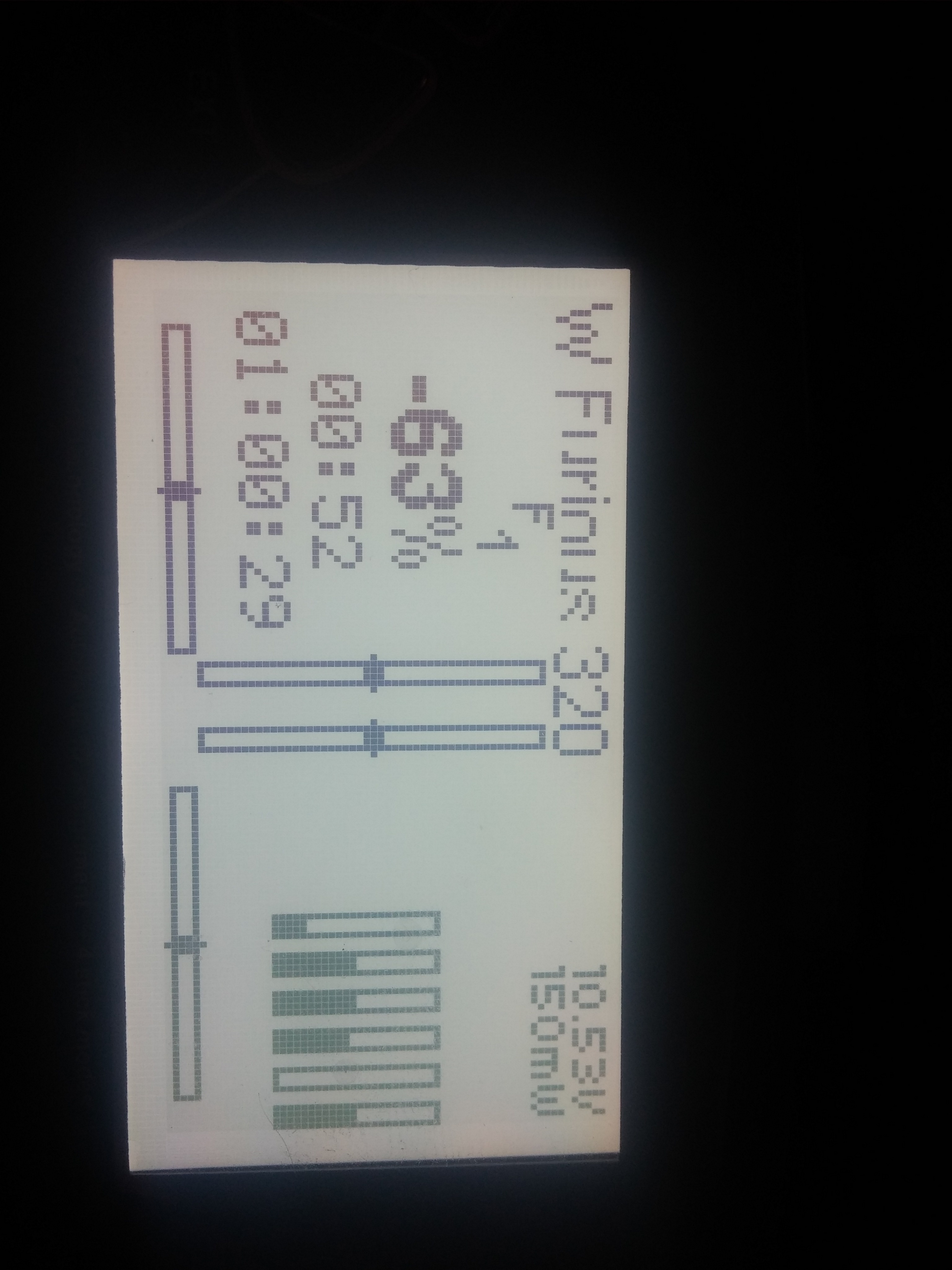

I have displayed devo10 display of situation stick.
Also has seen that change of trimmers doesn't correspond to changes on the picture and on the kopter. I change Rhrottle trim for an example, on the screen Roll changes, and in a kopter Pitch changes. Why so?
It is my mistake?
It is the author's mistake?
And has to be? What for?

- FrankV
- Posts: 39
21 Jan 2017 14:44 #58279
by FrankV
Replied by FrankV on topic Walkera Furious 320(G) setup file - GPS version!
No, it's no mistake.
Yes, it is mentioned in the manual.
Why? Because it is handy, use it always. When you have to trim on some kind of quad/plane/xxx you can have one hand at the stick, while you can easily use the other hand to trim.
No need for trimming this furious anyway, so why do you ask?

Insertion of the FURIOUS 320G model for DEVO 10 apparvtura with deviation insertion, on the basis of FrankV-https://www.deviationtx.com/forum/model-configs/6354-walkera-furious-320-g-setup-file-gps-version#53604.
The made changes:
- the arrangement of trimmers and their display on the screen on standard is corrected (at FrankV they settle down on another, it is so more convenient to him)
- change of expenses of Elevator, Aileron, Rudder is joint and it is postponed for one toggle-switch - "ELEV D/R"
- the AILE D/R toggle-switch includes the additional flight mode
- instead of the picture of a multikopter display of a condition of levels on 7 channels of the 320th is displayed
- display on the screen of percent of level of gas is increased and the arrangement of other elements is changed, small additions are made.
the complex problem of display on the record inclusion mode panel is solved. On the right the timer which counts record time is inserted.
Several small improvements are made.
The camera turns on LTRIM +, LTRIM is switched off-.
But I would change ARM, so it isn't pleasant to me.
The insertion is working, it was written by my companion. We from Russia.
The link to file with the yadi.sk/i/DfN2gHoz3Dwhgt settings
Excuse for my English
Here a forum in Russia forum.rcdesign.ru/f135/thread441959.html
The made changes:

The 4th mode should be chosen in FlyConfig
example
MIX
1 - Stabilize
2 - Loiter
3 - Drift
AILE D/R - RTL
How to make ARM on the switch?
who can make?
MIX - 3 flight mode + 1 flight mode AILE D/R = 4flight mode
example
MIX
1 - Stabilize
2 - Loiter
3 - Drift
AILE D/R - RTL
who can make?
Last edit: 21 Jun 2017 12:20 by nemo152.
