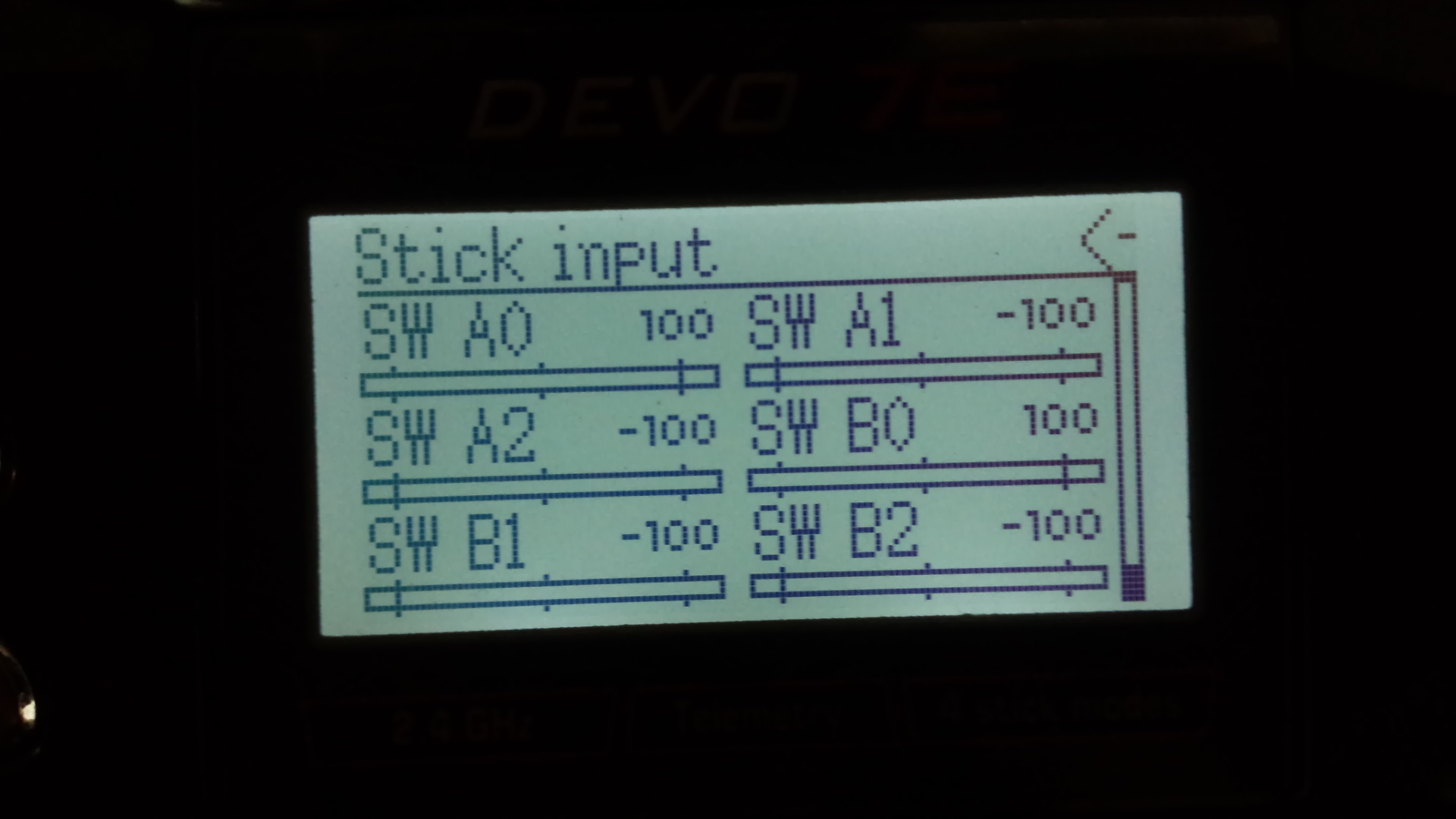

19 Sep 2016 08:18 - 19 Sep 2016 10:20 #54027
by TF824
Replied by TF824 on topic Help!! Devo7E V977 Pitch Jumping around Zero Pitch
BirdBarber
That change (CH8 safety NONE) solved issue.
No more pitch jumping at all.
Thanks a lot!!!

- TF824
- Posts: 36
22 Sep 2016 07:29 #54124
by TF824
BirdBarber
Thanks for your help again!
I finished adding 2x3 position Switches and checked function by the channel monitor.
It's working good.
Now I want to make V977 model.ini similar to your Devo8S V977 ini.
I'm trying to figure out which one can convert to added switch A0, A1, A2 and B0, B1, B2 from your Devo8S model ini.
If you can help, please let me know your suggestion.
Thanks.

I see you have the input monitor displayed, that's good for checking your switches, and the separate channel monitor is used for checking what is output from the mixer to your heli, make sure you know how to use it as well.
To change a switch assignment in the mixer I will give an example for Rud D/R in my V977 8s model file listed above..
ENT button -> scroll to '1 Model Menu' and ENT -> scroll to '2 Mixer' and ENT -> scroll down to the right 'Expo&DR' box beside '4-Rud' and press ENT
The mixer for the Rudder dual rates is now displayed, it goes way beyond the bottom of the display.
Scroll down using DN until 'Switch1 / ELE DR1' is highlighted and then just toggle the switch on the transmitter you would like to use instead of the ELE DR1 switch. The new switch name should display. You can also select a switch by scrolling thru the list using the R and L buttons. Now just scroll up using the 'UP' button until the 'Save' box is highlighted and press ENT. Thats it, just press EXT multiple times to exit all the way out.
The most common problem when using the mixer is forgetting to 'Save' your changes.
