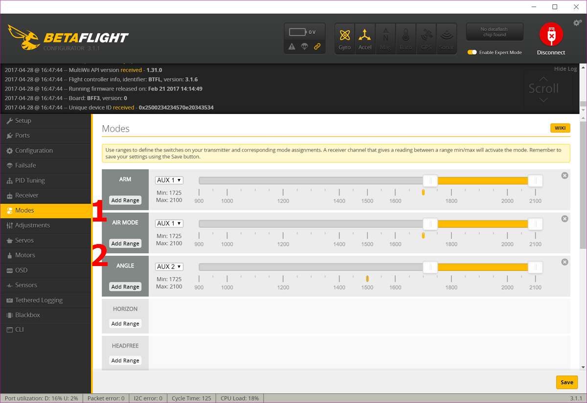

Hey everyone,
Here is my ini for my KingKon Tiny7. It currently uses Aux 1 to arm. Aux 2 is for modes: Air,Angle and Horizon.
Enjoy!
Enjoy!

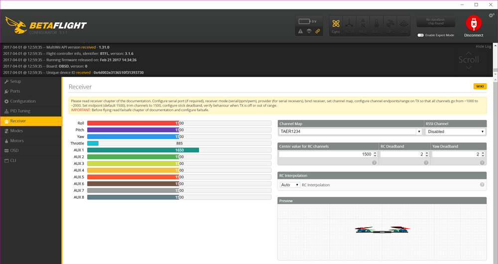

I'm using this ini with my Devo F12E. So the switches might be different. Hook your Tiny7 to Betaflight. Then go to the receiver move the switches and see if any respond you can also check your flight sticks.

Yeah sorry. I'll have to update my post so everyone knows it's setup for a F12E. But changing the switches is easy. Just use the receiver screen to figure out which switch you want to us to arm and change modes. And got to switches tab then plug in the right aux channel to arm and change modes. You should be good then. Betaflight is easy to install the chrome plug-in.
Good luck!
Good luck!
