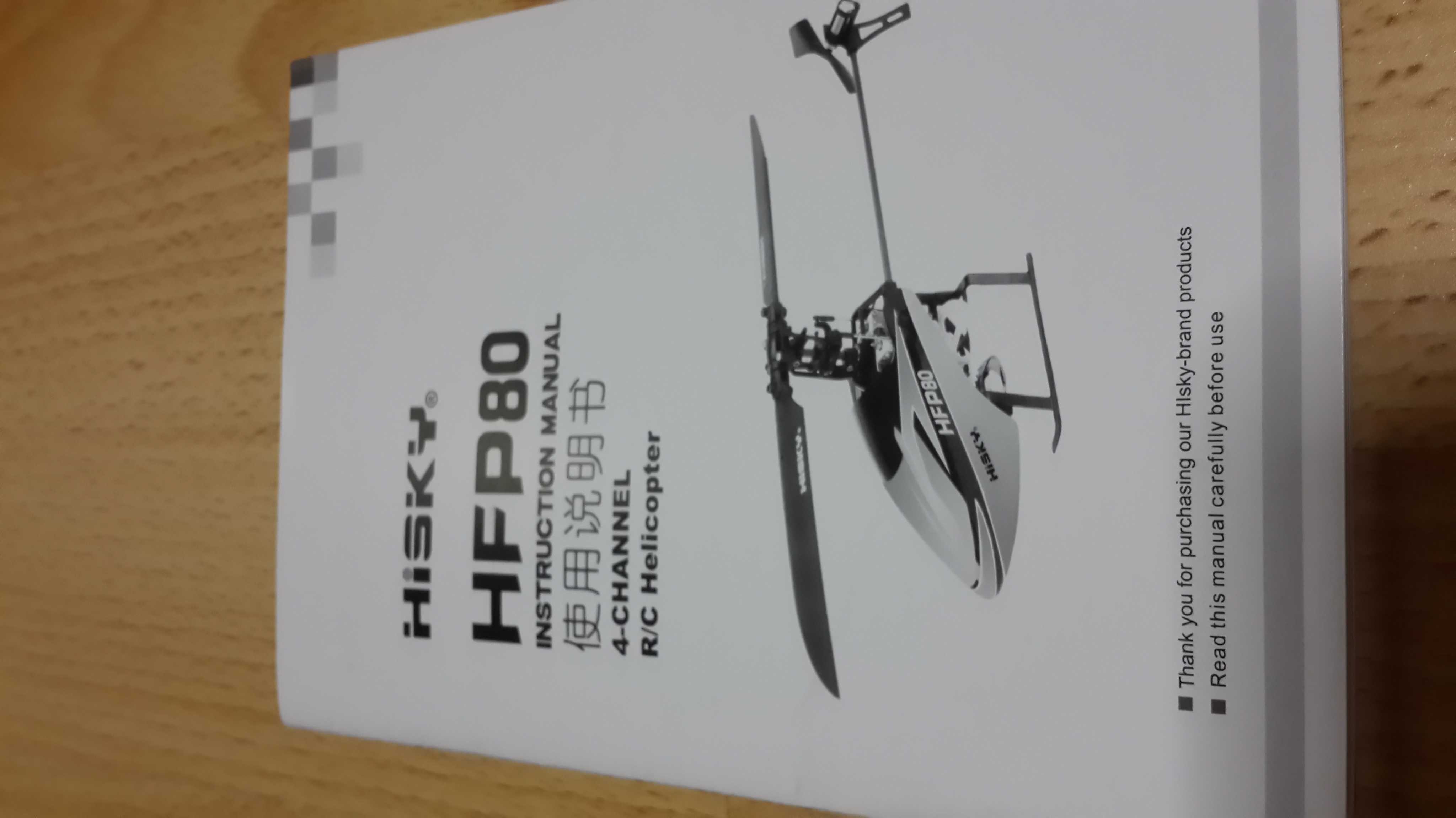

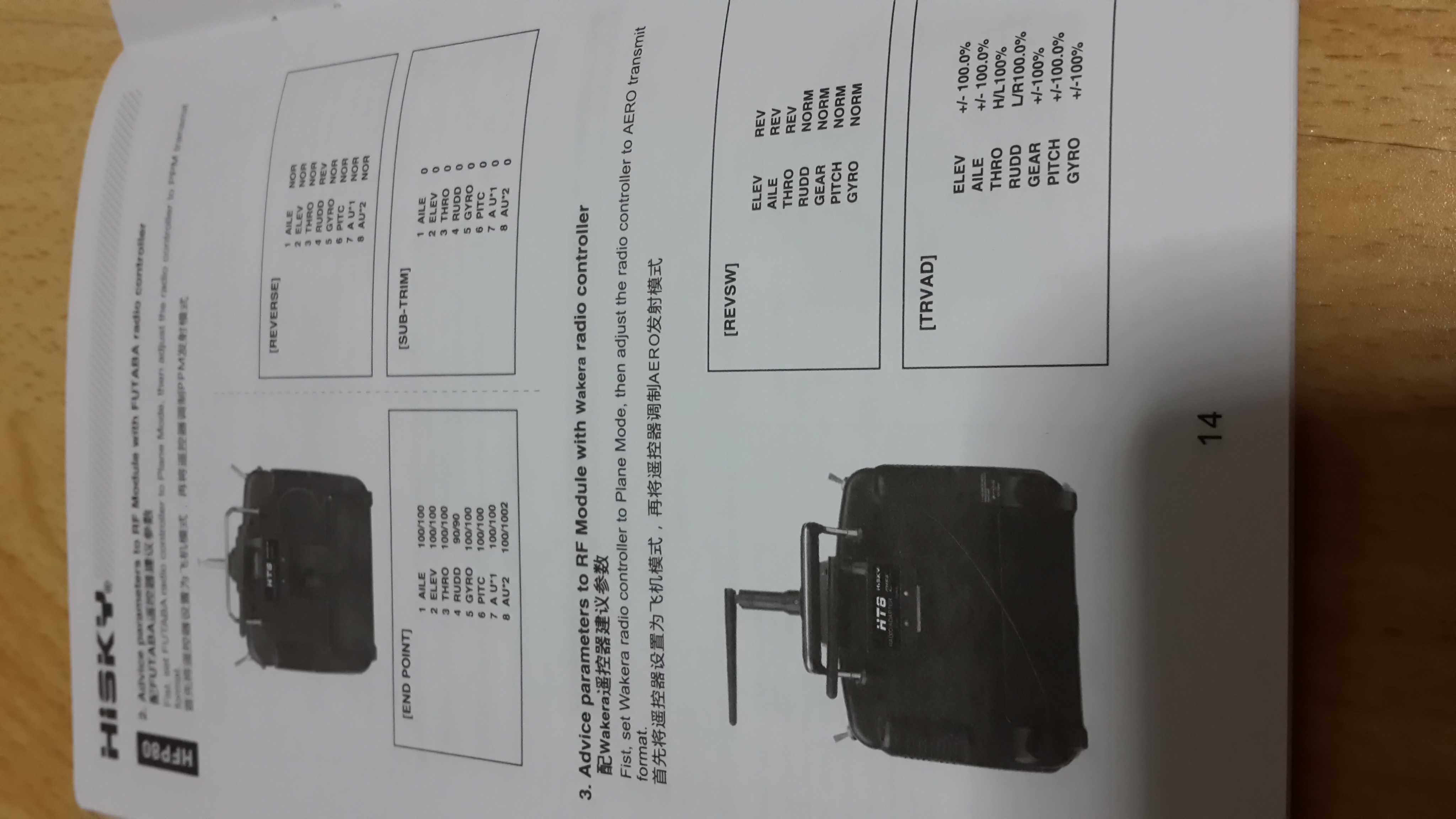

07 Aug 2014 18:01 #25076 by mugen0001
Replied by mugen0001 on topic Req: Hisky HCP 100/ V922 model ini for nrf24l01
now i test with my HFP80 ,it don't work .
in left stick (throttle) when i push up => nothing , push down => only tail rotor spin ,and main rotor not spin
