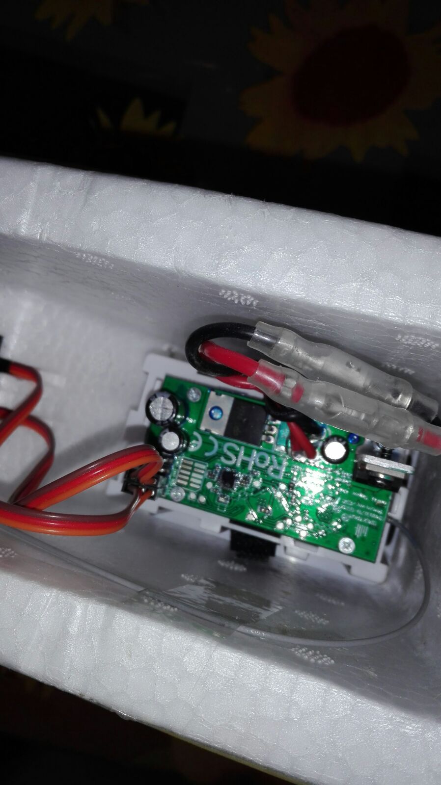

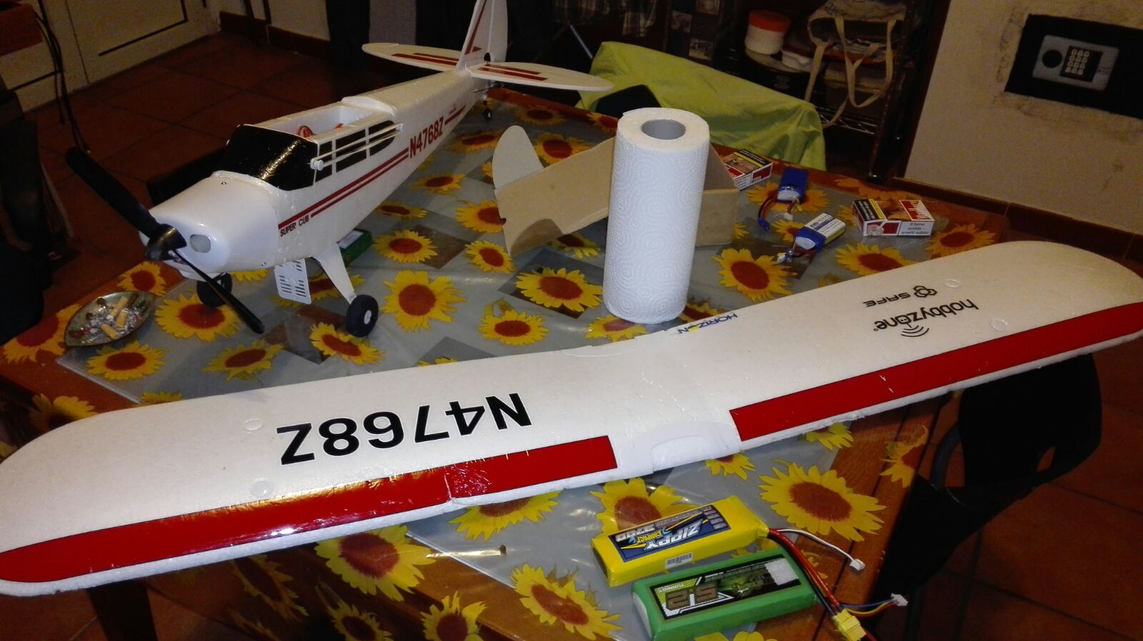

i got plane in hand it is sport cub and has safe board on was working on dx9 but i cannot get throttle go, it a brushed motor and do not see motor or esc cable to safe board, aileron and rudder they go but cannot get throttle working, im going mad...
