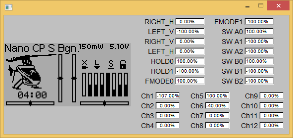

- joshthebox
- Posts: 12
03 Jan 2017 19:12 #57510
by joshthebox
Replied by joshthebox on topic Blade 180 CFX and Nano CPS for Devo 7E
For the Nano CP S Bgn file, what switch is designated for flight modes? I can't find it. I have a 7e.
05 Jan 2017 16:43 #57556
Replied by hexfet on topic Blade 180 CFX and Nano CPS for Devo 7E
Looks like FMODE0 and FMODE1, which I don't think exist on the 7e. Search for those strings and change them to a switch on the 7e.
