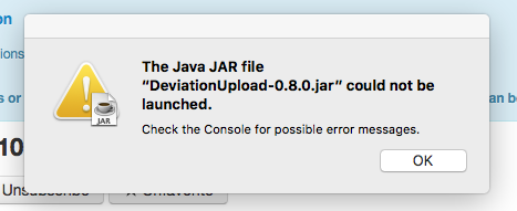

01 Aug 2017 19:09 #63672
by RC/DC
Replied by RC/DC on topic Walkera F210 Devo 10 Model.ini Request $$
@mwm- Getting this on my iMac when trying to open the USB Uploader on my iMac.
See attached screenshot. Running OS Sierra 10.12.5/Mid 2011 iMac-tons of memory.
02 Aug 2017 12:45 #63684
Replied by mwm on topic Walkera F210 Devo 10 Model.ini Request $$
Do you have the console output it refers to? I didn't see it in the attachments list.
