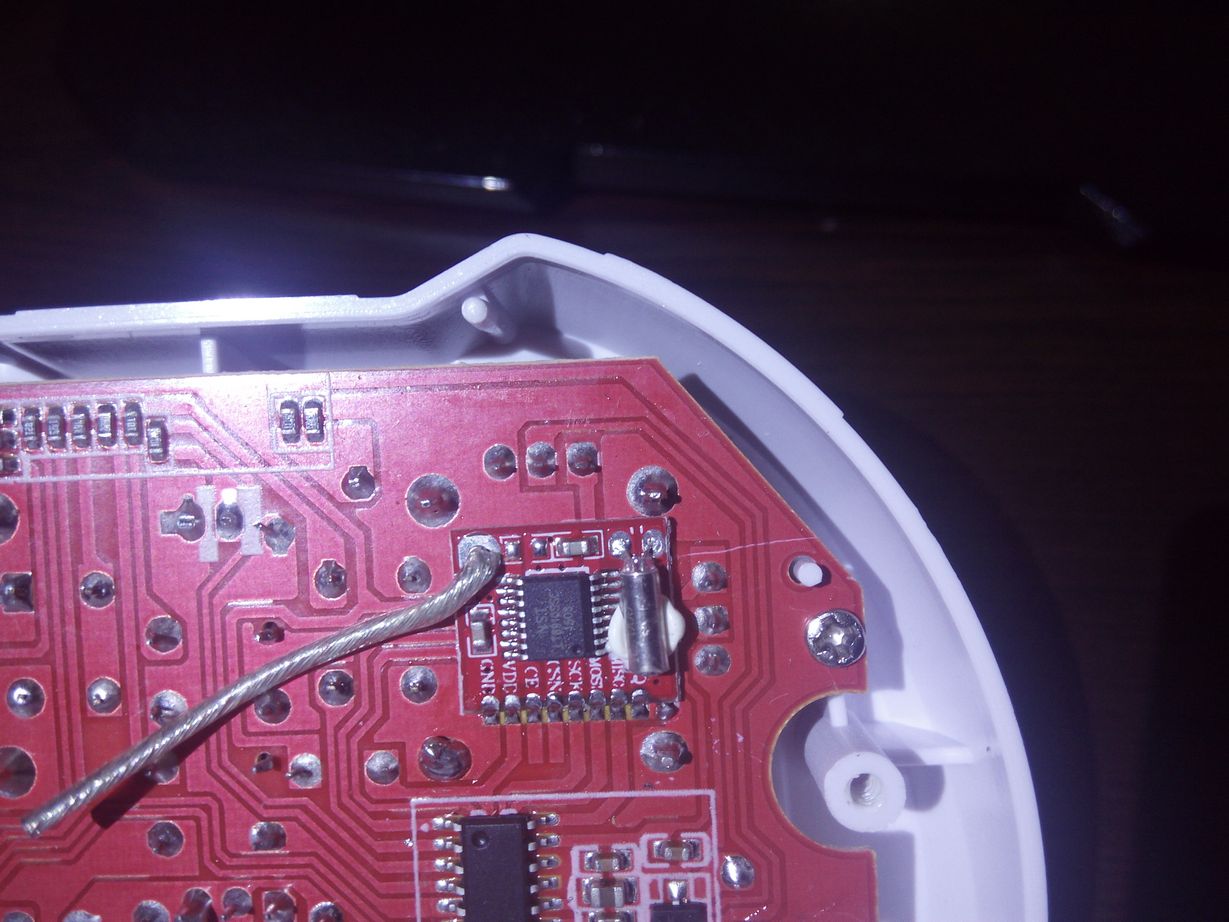

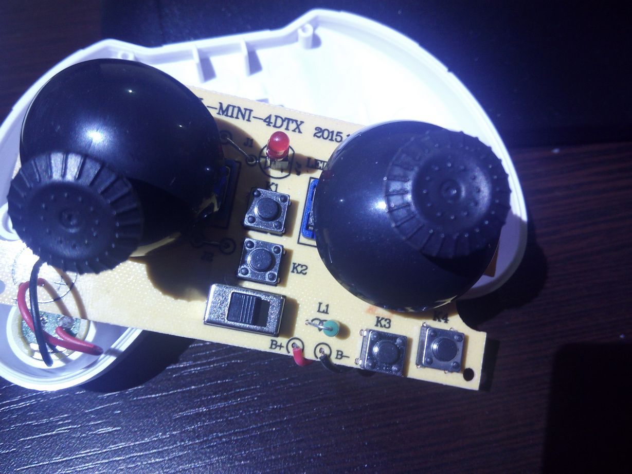

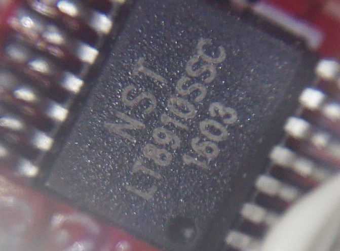

Yes, i have received the quad long time ago. I have only flown it a couple of times.
Here are a few pics, i hope it helps determine the chip and maybe the protocol.

Too bad, this chip is currently not supported by deviation firmware. It is the same chip as in the jjrc h31. I was asking about this model a few weeks ago.
www.deviationtx.com/forum/protocol-devel...l-for-jjrc-h31#58567

Take a look at the F36 and GW008 threads. Goebish is working on an emulation for LT8910 TXes, but this is still work in progress.
