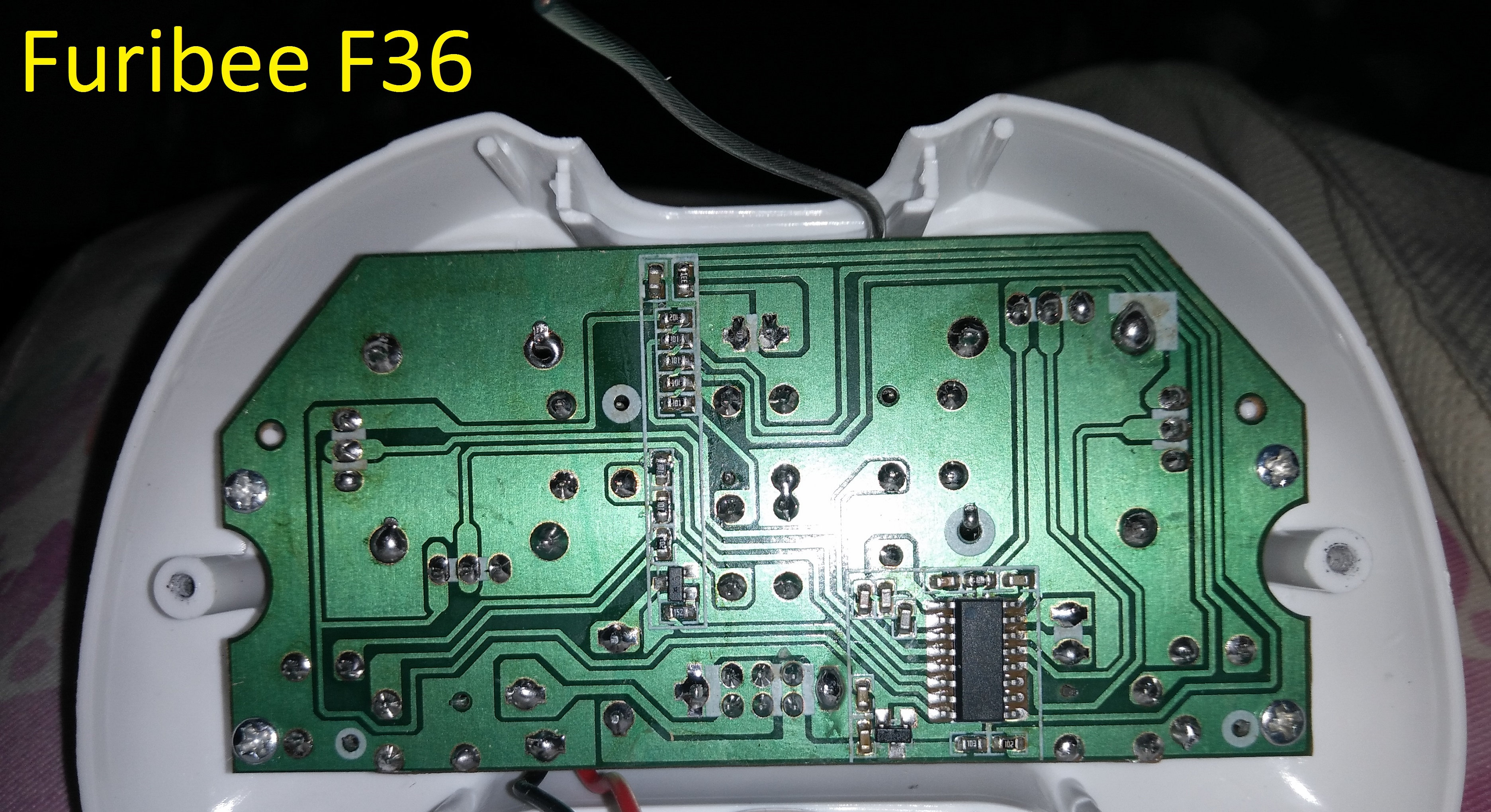

I've got a Devo 7e with 4in1 and a new F36. I've also got a logic analyzer. But there is no seperate radio chip on the F36 receiver board. The TX also uses a single chip for everything, so no sniffing on the SPI bus. Anything else I can try to help contribute to the efforts ?

Replied by HappyHarry on topic Furibee F36 Needs Deviation
that's not good news, the only option now afaik is to use an sdr setup and pull the data from the air. that's a much more expensive setup and again afaik a more involved procedure
