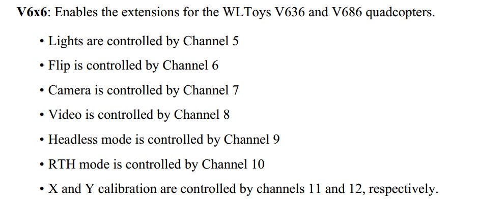

Hi !, I need the config file for a NiHui U807 drone, I've downloaded one already but I need to know if could be possible to add the "headless" mode.
Any info ?

by ajtank
Replied by ajtank on topic Nihui U807
U807 should be using v6x6 protocol. See attachment for info from the manual. I however do not have this quad.

Oppps, I've tried to use the channel 9 & 10 (in the emulator) but I can't get the right "mix". As far as I know, I've to asign a switch to a channel, then the channel must have a value of -100 and +100...so when I flip the switch the state changes from -100 to +100...Now my question....Should I use a "complex" mode? "simple" mode (in this case I can't assign a switch) ? Which type of curve...fixed, max-min....? As you can see I'm a little confused about it....

Replied by FDR on topic Nihui U807
A simple mixer will do.
Set the source to the on switch, like AIL_DR1 or GEAR1, and it's done.
While it is not necessary, I usually change the function to Min/Max to distinguish it's two state behaviour, despite it will behave the same...

Hi! Thanks for the info...I've checked it and it works!!! Now I need to test in the real world
