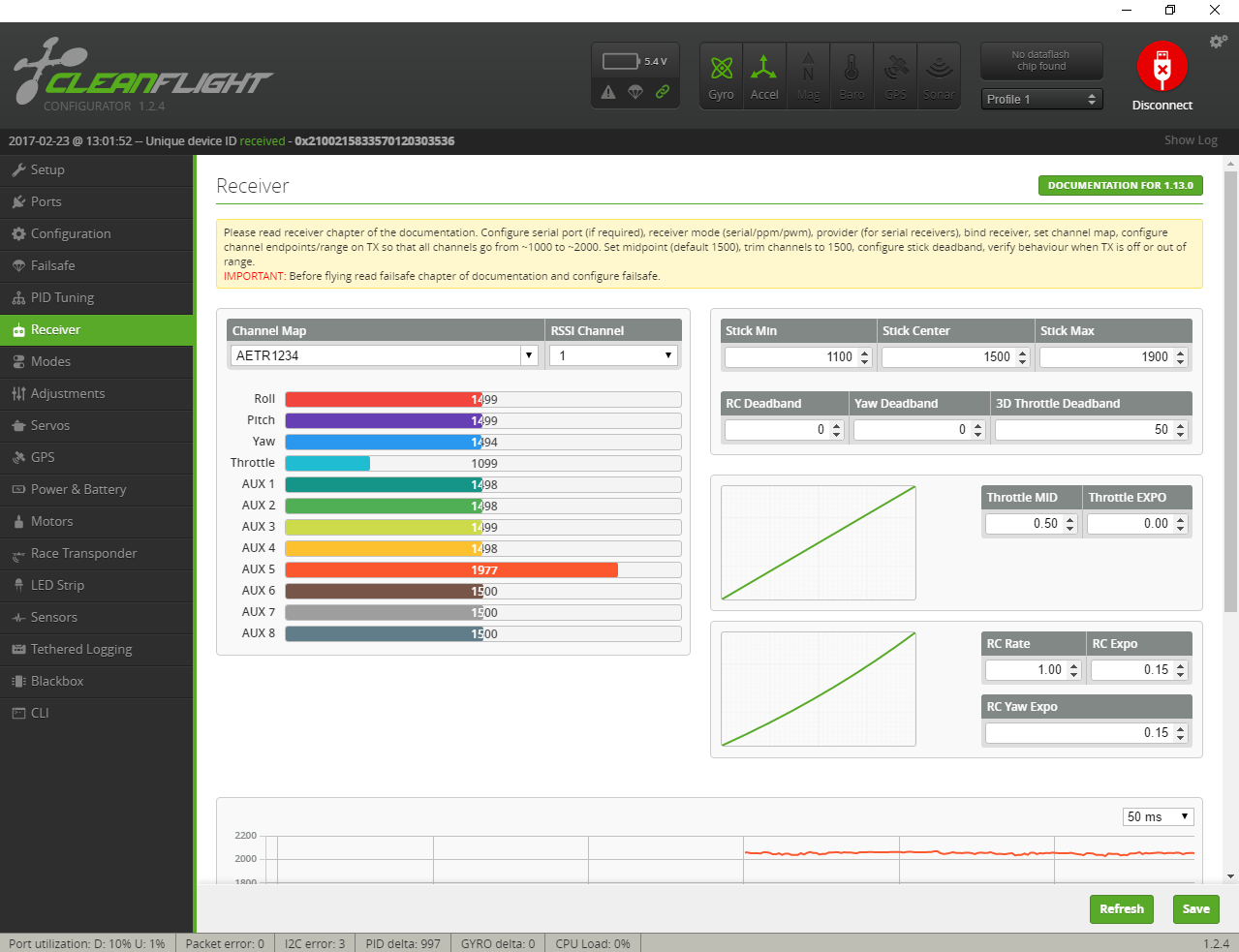

hey thanks for your help i had to set it to just over- 60 for it to bind. but now i have another problem , im unable to arm as aux 1 and 2 dont work at all and aux 5 seems to be set to 1950 to 1990 as it jumps around there constantly :/ so i cant fly as I'm unable to bind. see photo about what I mean with aux 5

it's normal for Aux5 to jump around like that due to the rx being PPM everybody reports theres doing the same as well as mine..Did you set up the switches in the mixer on your radio? You can go to the mode selection in CF and manually set it to Angle mode if you don't want to set up switches on your tx...I think you hold Right on throttle to arm but most setup a switch to arm/disarm
