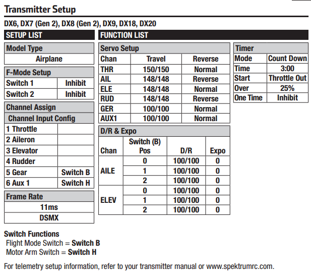

Hi there,
I have a Devo 8s with Deviation 5 installed.
I want to fly the new Blade Torrent 110 (still waiting on it).
Can anybody help me to translate these settings (attached) into a model file?
I struggle a little bit in understanding how to make the switches.
Thx a lot for any help.
Oliver

Hi Cestus,
I see you tried the Patreon page. However, I've really stopped doing that because it wasn't generating any work.
I have no idea what the Blade Torrent is, and I'm not familiar with any of the radios listed on that setup. Do they have setup for one of the RTF radios like a DXe or DX5e or the older DX6i? Failing that, can you find the manual and post a link to it? The settings don't make any sense to me - B is the flight mode switch, but nothing in the table that references it changes when it changes. H is a throttle arm, but it isn't otherwise mentioned so I don't even know if it's a 2-position switch, a 3-position switch, or something else.
If you've got it and assuming it's some kind of multirotor because just about everything is, I'd start with a standard 4-channel model using the DSMX protocol, reversing the AIL and RUD channels in the channel settings as indicated by the settings. If it doesn't arm, try a mix on channel 6 that uses a 2-way switch as a source and a MAX/MIN mix and see if toggling it arms (do all of this with the props TAKEN OFF). Since they only use 6 channels, make sure that you set the model to 6 channels as there are bugs in the deviationTx protocol that make some 6-channel Rx's misbehave if bound with deviation trying to use more than 6 (or is it 7?) channels.

I assume too, that I will need the motor switch on chanel 6 to get it running (hopefully).
I totally struggle understanding what they mean with the Switch B.
Simply a 3-way switch on chanel 5? Could it be so easy?

Shouldn't be. I thought I turned it off. Months ago. Oh well.cestus wrote: sorry I found the info here and saw it was still active
Sure looks like it. That's pretty standard for Blade 'copters. It also means you could do the stagility mode hack to get self leveling with no angle limit.I totally struggle understanding what they mean with the Switch B.

Okay, strange.
I remade the model from template and now binding works
The motor switch works too, I can arm the motors.
But strange behavior:
As soon as I make the motor switch on, the motors are running.
Slow but running.
Throttle works normally, but I cannot make the motors off oO
Throttle is at -150 and the motors are still running.
I cannot check flying at the moment, kids are sleeping :/

Replied by mwm on topic Blade Torrent 110
The manual says you stop the motors via the arm switch. That's also normal behavior for the older Blade quads I have. Some FC software has a setting to control whether 0 throttle actually stops the motors from spinning or just cuts them to very slow value. They do this so you have yaw control even with the throttle all the way down.

lol you name it
It is a normal behaviour for this copter.
Today I was able to fly during lunch time
Settings work perfect, and this copter is a BEAST.
Totally incredible how much punch this thing have...
I will upload my config later, in case someone else needs it

Here is my simple setup for the Blade Torrent 110.
Devo 8s
Moto Switch on RUDD D/R
Flying Modes on FMOD
Devo 8s
