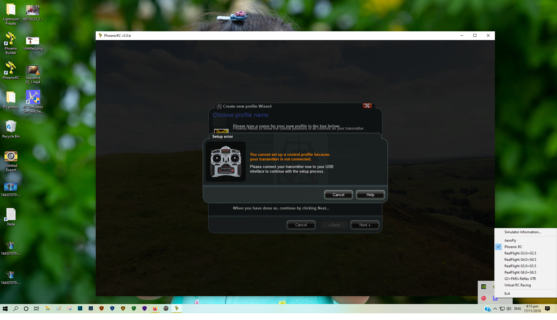

HI EVERYONE, I NEED HELP ABOUT MY DEVO 10 AND PHOENIX RC.
I INSTALLED : PhoenixRC + RC Simulator SimSwitcherXIn1 + MY PC RUNNING WINDOWS 10, DEVO 10 V5.0
BUT WHEN I RUN PhoenixRC IT STILL NOT GET SIGNAL FROM TX. BUT PC NOTE ME DRIVER ALREADY INSTALL.
WHAT SHOULD I DO TO GET IT WORK ... PLEASE HELP !!!

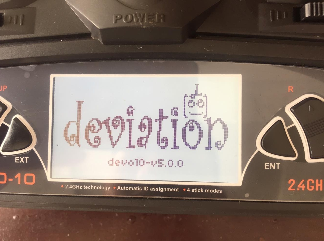

Is your transmitter running DeviationTX firmware or stock Walkera firmware?

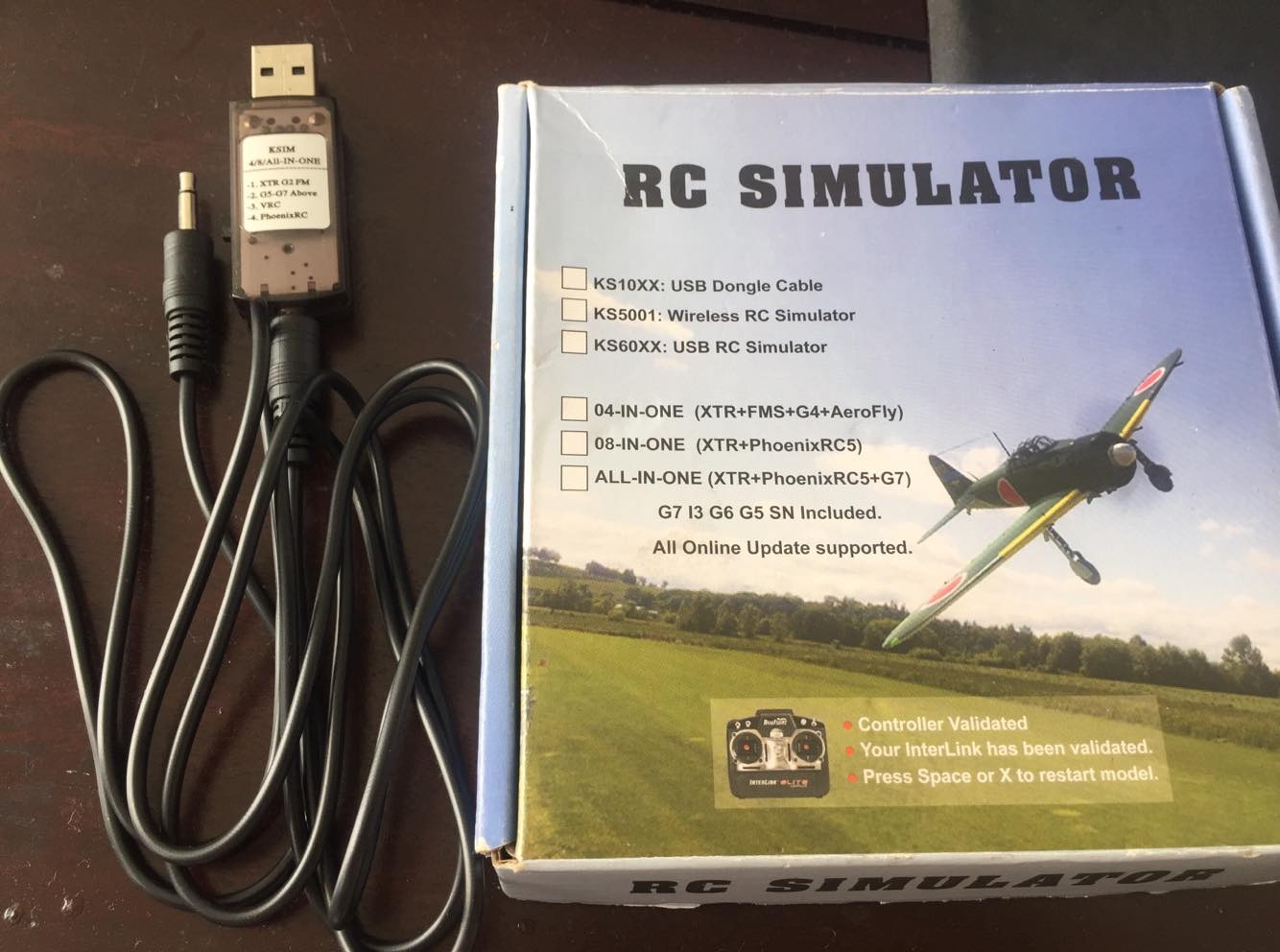

You need a trainer port to usb adaptor for PhoenixRC. It can be ordered of of ebay. Been using one for abt 4 years.
- Mack775
- Posts: 42
17 Nov 2019 20:57 #75449
by Mack775
Replied by Mack775 on topic [HELP ]DEVO 10 + SIMULATOR
SimSwitcherXIn1 should have one it should work!

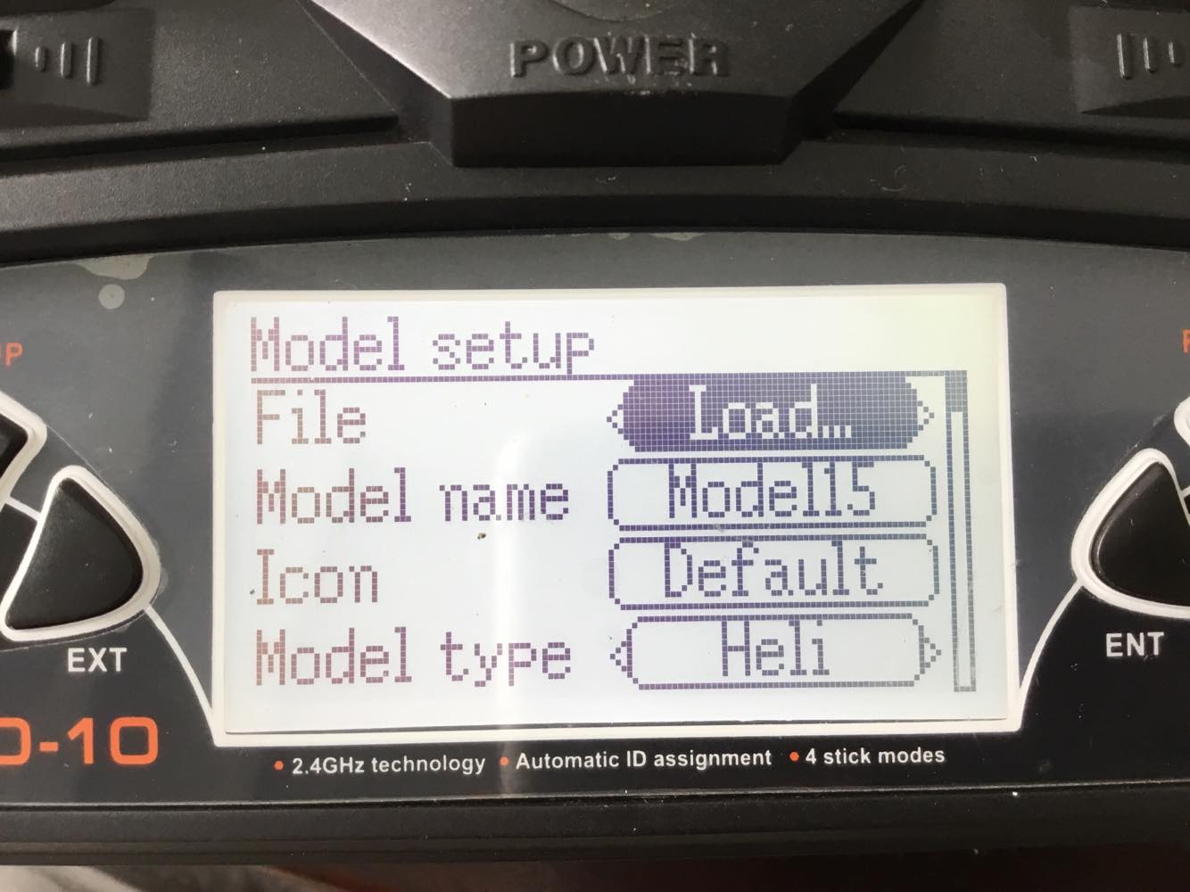

To select PPM:
Go to 'Model Setup' page.
Load a new model file if you need to.
Change 'Devo' to 'PPM'.
Then select 'Re-Init'.

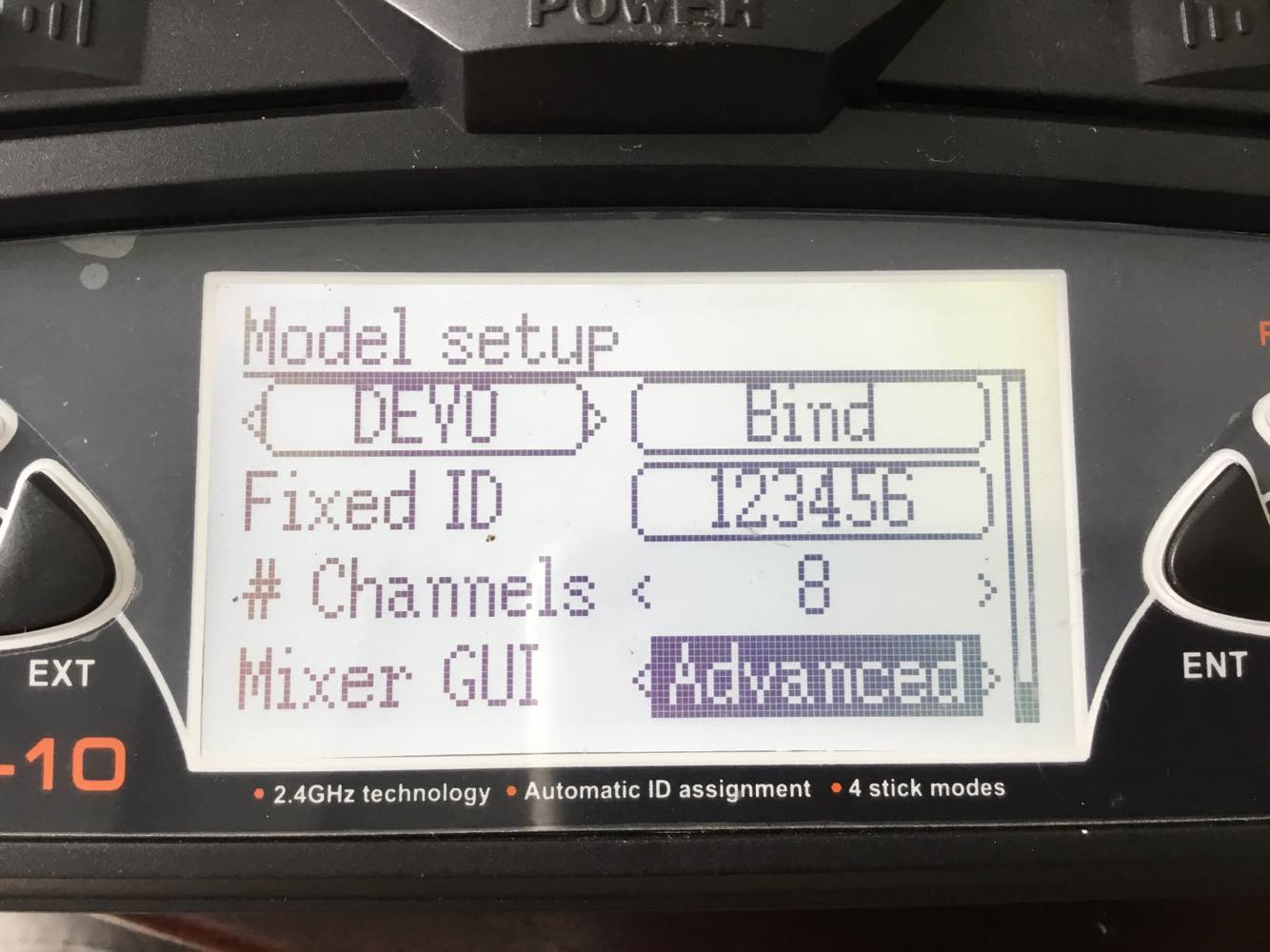

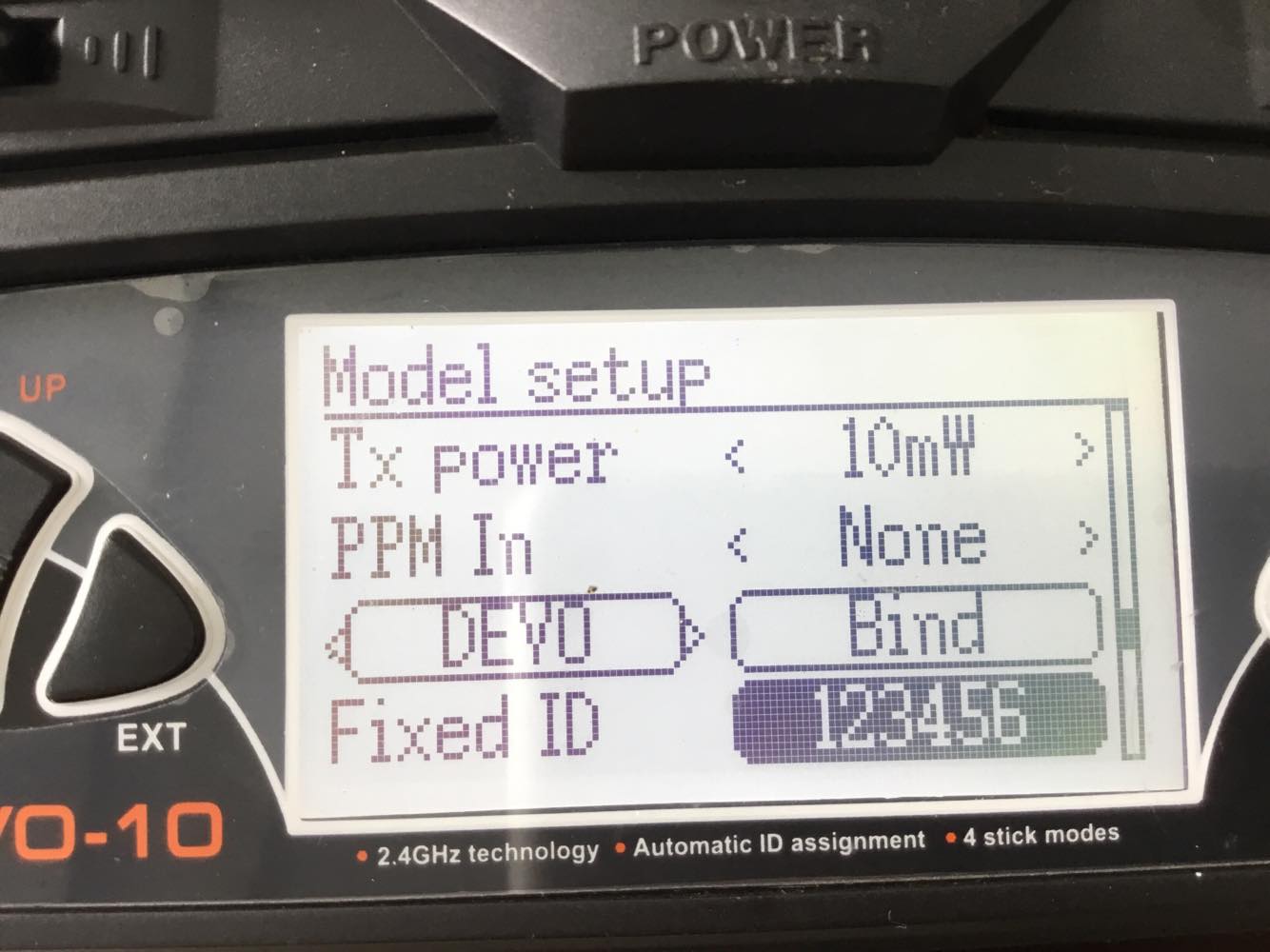

I Go to 'Model Setup' page.
Load a new model file. than the list show below (PHOTOS), what should i change
1. i enter DEVO, it show me: ON/OFF
2. i enter PPM IN, it show: NONE / CHANNEL / STICK / EXTEND
Replied by DOTHANHNHAN on topic [HELP ]DEVO 10 + SIMULATOR
gdenton wrote: To select PPM:

Replied by gdenton on topic [HELP ]DEVO 10 + SIMULATOR
Where it says 'DEVO' change that to 'PPM'.

already work. thankalot
gdenton wrote: Where it says 'DEVO' change that to 'PPM'.
