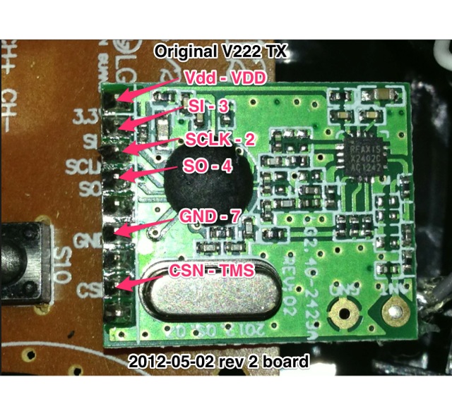

Does anyone know the stock transmitter radio pinout? I opened mine up and it has 9 pins, 3 of which aren't labeled. I didn't take the time to probe them to see if they're even connected - if they aren't it would be fairly easy to drop into place in the 7E since it's just SPI like normal.
From the top it's:
3.3v
MOSI
SCLK
MISO
(unknown)
GND
(unknown)
CSN
(unknown)

Ah hah, found victzh's message on it from a few months ago on the other forum:
www.rcgroups.com/forums/showpost.php?p=24998249
...now to man up and risk having a grounded v222 until the replacement transmitter comes. I hate desoldering.
At least the 7e side of it is nice and beefy when I go to put it in.
In case of forum disaster, the pinout is as follows, looking at the silkscreen side of the stock radio module:
Vcc MOSI SCK MISO CE GND IRQ CSN NC
Pull CE high, leave IRQ and NC disconnected and the other 6 are perfectly ordinary.
Thanks for all the work, victzh!

By the way, with the v202. Our first quad with the drop out issue. I did many things to try and resolve it.
I had the RX antenna horizontal. I trimmed it to 31.25mm. To 30mm. I replaced it with a new antenna wire. I tried a thin wire one that came with my Blade NanoCPX.
I also tried with three Devo7e radio, two different antenna configuration. One using a dipole up the antenna tube. One using a J-style antenna horizontally installed inside the Devo7e.
Regardless of all that test scenario, the drop out remains.
So we have three quads now. v202, v222 and v262. All with the same dropping out of the sky issue. 10ft or right in front of us sometimes. Very frustrating.
I just got a new usb logic analyzer. Now to figure out how to hook it up and peek at the signal. LOL anybody care to give me tips and get me up to speed?

Daryoon, what exactly do you want to achieve with your new logic analyzer? Protocol is reversed and nothing unknown left. Stock transmitter is very sloppily programmed indeed, it has irregularities in emitted packets which can't be explained by any logic, so they seems to be bugs in transmitter program. My code which does not produce such irregularities works perfectly for me - no dropouts on V202 and V212 so far.
The chance is that sequence recovery algorithm in receivers is lacking as well. If you don't get the packet on expected frequency on time, you can do two things - either predict the frequency from the hopping algorithm and wait for next packet there, or stay on the frequency waiting for hopping algorithm coming to the same frequency again. As far as I can tell by analyzing V202 receiver it uses the latter strategy. It takes 32*4ms = 128ms in theory to recover. May be the RX gets tired and just switches off control - I did not check this. The quality of receiver may affect the rate of defective packets and thus the dropout rate.
Summing up - if you have one model without dropouts and another with dropouts, may be the model is to blame, not transceiver.

Well, I am just gonna start learning to hook these things up. Not looking to reverse engineer protocols or anything like that...yet.
I don't even know where to hook up the probes. Don't laugh too hard.
It's just that we got three TX. One of which was shipped by Banggood and IS the TX with supposed the "fixed" to prevent drop out. Thought I could hook the logic analyzer up to that or something to give you guys feedback.
But it seems like it won't matter anyways. The new TX didn't solve the drop out issue on ANY of the quads we have. Including the brand new one that we just got in the mail.
Like I said...v202, v222 and v262. All suffering drop out. And with all combination of TX we have. So it doesn't look like it's the RX or the TX that's to blame. Don't know what else to try at this point without knowing exactly what WLToys deem was the issue and solution that they implemented.

What kind of logic analyzer? If it's Saleae or clone I can send you the Python scripts for decoding the nRF24L01 protocol (as used by V202, not everything in the spec is implemented).
If I understand the situation right, the fix is both in new TX and RX, so defective receiver boards with dropouts stay defective. I asked a question in rcgroups about what specifically they fixed, but don't have serious hope of it being answered.
