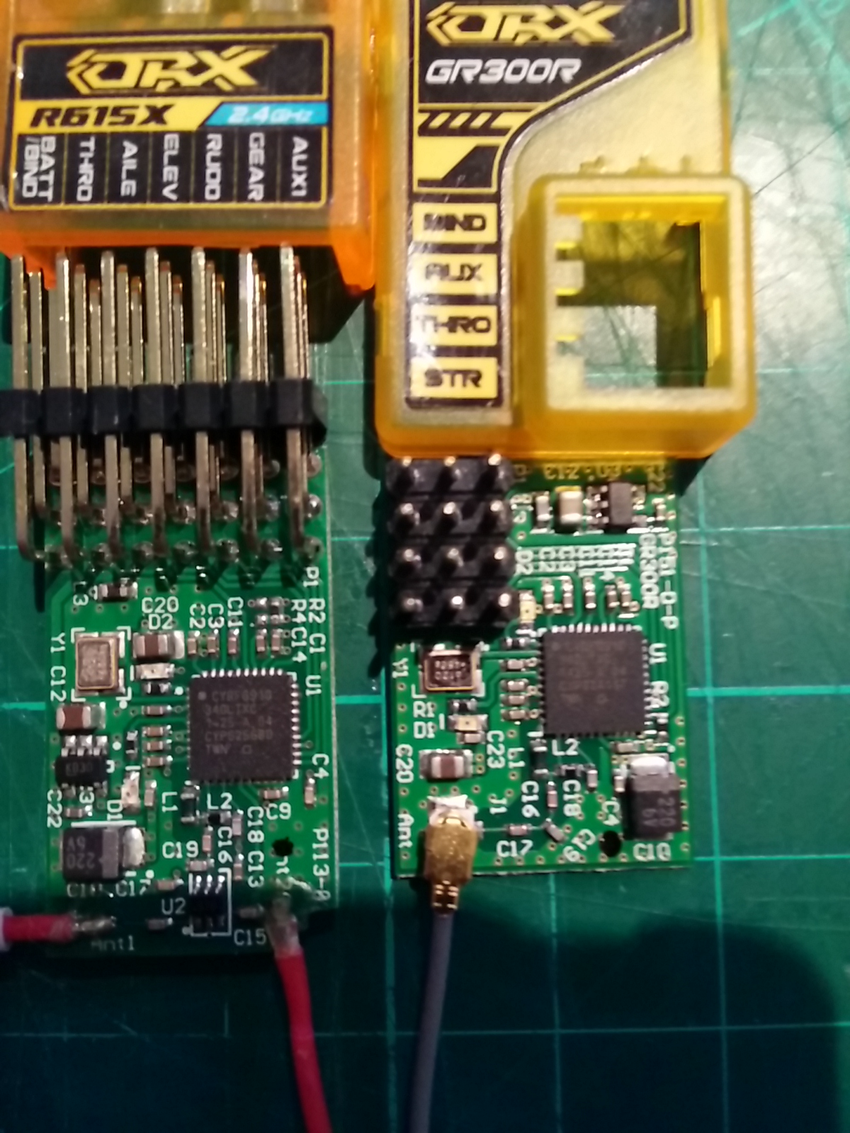

04 May 2016 19:21 #47764 by Gzus11
Replied by Gzus11 on topic DSM2 surface radio
I've just picked up the gr300 ground receiver fairly cheap, and now discover that's it's the same as the original post.
It appears to bind with dsm2 but flashes the red led indicating signal loss, shame.
I assume this is an old post, and no development has been made on the ground protocols.
If it helps at all, I attach an image of the orange r615x next to the gr300r. The components look very similar with the main chip cyrf6910. I also have a spare if there's any thing I can do with it to help.
