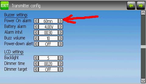

No, there is implemented an alert when the tx is not used (no movement of the sticks) for (configurable) 1 to 60 minutes. You can find it in the tx configuration menu (called "Power On Alarm").

20 May 2013 09:55 #10136 by rbe2012
Replied by rbe2012 on topic Alarme Devo when not used
It is in the nightly build since a few days (about a week), not in the regular code. I attached a screenshot from Devo12:

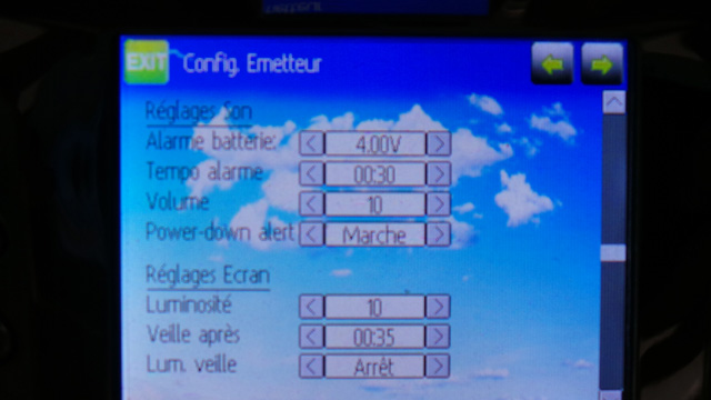

20 May 2013 12:22 #10143 by Franck
Replied by Franck on topic Alarme Devo when not used
rbe2012 wrote: It is in the nightly build since a few days (about a week), not in the regular code. I attached a screenshot from Devo12:
YES ! but i don't have this option on my DEVO 8 ... :unsure:

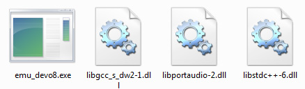

Franck wrote: ... The emulator does not work for me, I get errors ...
Have you only errors concerning the DLLs? Then please read this: you-need-these-dlls
20 May 2013 18:08 #10160 by Franck
Not *Dll

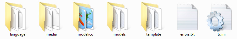

20 May 2013 18:38 #10161 by rbe2012
This looks as if the file system you use is not correct. You should have a structure like this:
├───filesystem
│   └───devo8
│       ├───media
│       ├───template
│       ├───models
│       ├───modelico
│       ├───language
│       └───tx.ini
└───emu_devo8.exe
When you look at the USB drive you will only see the tx.ini and the directories media, template, models, modelico and language.
For the emulator the above shown structure is necessary.
If you create this, the "file not found" issues should be gone.
20 May 2013 19:03 #10163 by Franck
there is that in my devo
emu_devo8.exe is in my pc with dll
It is correct ?
20 May 2013 19:06 #10164 by heliaddict
Replied by heliaddict on topic Alarme Devo when not used
How exactly does the "power on alarm" work? I have tested on Devo 7e and set to 1mn - should the alarm activate after 1 minute? Nothing happens on mine, am I missing something?
20 May 2013 19:06 #10165 by FDR
Replied by FDR on topic Alarme Devo when not used
No, the 5 directories and 2 files of your first picture should be under the filesystem/devo8/ directory, i.e. 2 dirs deeper then in the tx.
20 May 2013 19:17 #10166 by Franck
FDR wrote: No, the 5 directories and 2 files of your first picture should be under the filesystem/devo8/ directory, i.e. 2 dirs deeper then in the tx.

20 May 2013 19:41 #10167 by domcars0
Replied by domcars0 on topic Alarme Devo when not used
heliaddict wrote: How exactly does the "power on alarm" work? I have tested on Devo 7e and set to 1mn - should the alarm activate after 1 minute? Nothing happens on mine, am I missing something?
If you don't touch anything during 1mn .... then the alarm must beep.
In fact "Power On alarm" is not a very good name... It's an "Idle TX Alarm"...

20 May 2013 19:52 #10169 by rbe2012
It does on my Devo8. It is important not to move the sticks for one minute (or the selected time). Every movement resets the timer.
