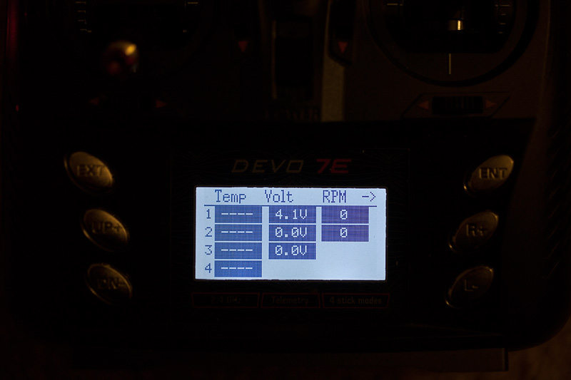

The bug is very easy to reproduce:
Looks like there's an issue with the u8 A7105_ReadReg(u8 address) function, in hubsan_cb(), just add a single register read after sending frame:In theory this code should have no incidence but it is enough to lose connection after a few seconds (random).
I found that if you add a few nop loops here and there in ReadReg() it will work longer before losing connection.
Anyone with a H107D wants to test a firmware with (supposedly) working voltage telemetry ? Don't attempt to actually fly , there's a big risk of connection drop
it's only to check if telemetry is working. Thanks, and happy new year !

Replied by goebish on topic New Hubsan Upgraded Version on the way
PhracturedBlue wrote: If you need a hand, let me know, and I'll spend some time actually going over it, but probably not today.
A7105_WriteData(packet, 16, state == DATA_5 ? channel + 0x23 : channel);
A7105_ReadReg(A7105_00_MODE);I found that if you add a few nop loops here and there in ReadReg() it will work longer before losing connection.
