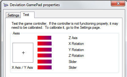

Go to Start->Devices and Printers->Deviation Game Pad->Game Conmtroller Properties->Properties->Test
And see if all axes work. Probably this is just the simulator expecting different axes then deviation reports.
Deviation reports on:
X,Y,Z,Rx,Ry,Rz and then a bunch of sliders.
If the software is looking for some axis between Z and Rx you would get this behavior, but it isn't really a Deviation bug.

I get the following, do you know what I should get?
(I can unfortunately check only on my HP laptop - we have our Summer holidays here in South Africa and I am not at home)
Zaxis - respond to Deviation Right Vertical or Ch3
X Axis - respond to Deviation Left Horizontal or Ch4
Y rotation - respond to Deviation Gear or Ch5
Z rotation - respond to Deviation Ch6
No response from any other Deviation channels

It should be:
X axis Ch1
Y axis Ch2
Z axis Ch3
X-Rotate Ch4
Y-Rotate Ch5
Z-Rotate Ch6
Slider 1 Ch7
Slider 2 Ch8
I didn't check it today, but this code hasn't changed, and I've verified this in the past

Hi PB,
Testing as per the Gamepad gives me the first 6 channels as you specified, but nothing on Ch7 and Ch8 (sliders)
I have not tested via the (Phoenix) Simulator again, as clearly I have other issues there.
I don't think this is important even if there is an issues on the channels 7 and 8 and suggest we park it until I can test on my PCs at home. I'll also clear the Bitbucket issue for now, seeing that nobody else joined with issues from their side.
Thanks for the help!

I just discovered this feature and wanted to add some lines for the manual. Before I always connected another Tx via DSC-cable on my Devo10.
I confirm that the first 6 channels work as desired but I cannot get access to Ch7 and Ch8 also. It does not matter which input I use (stick, switch or pot) I never get any response from both last channels.
Randmental, will you open again or might be PB is faster
