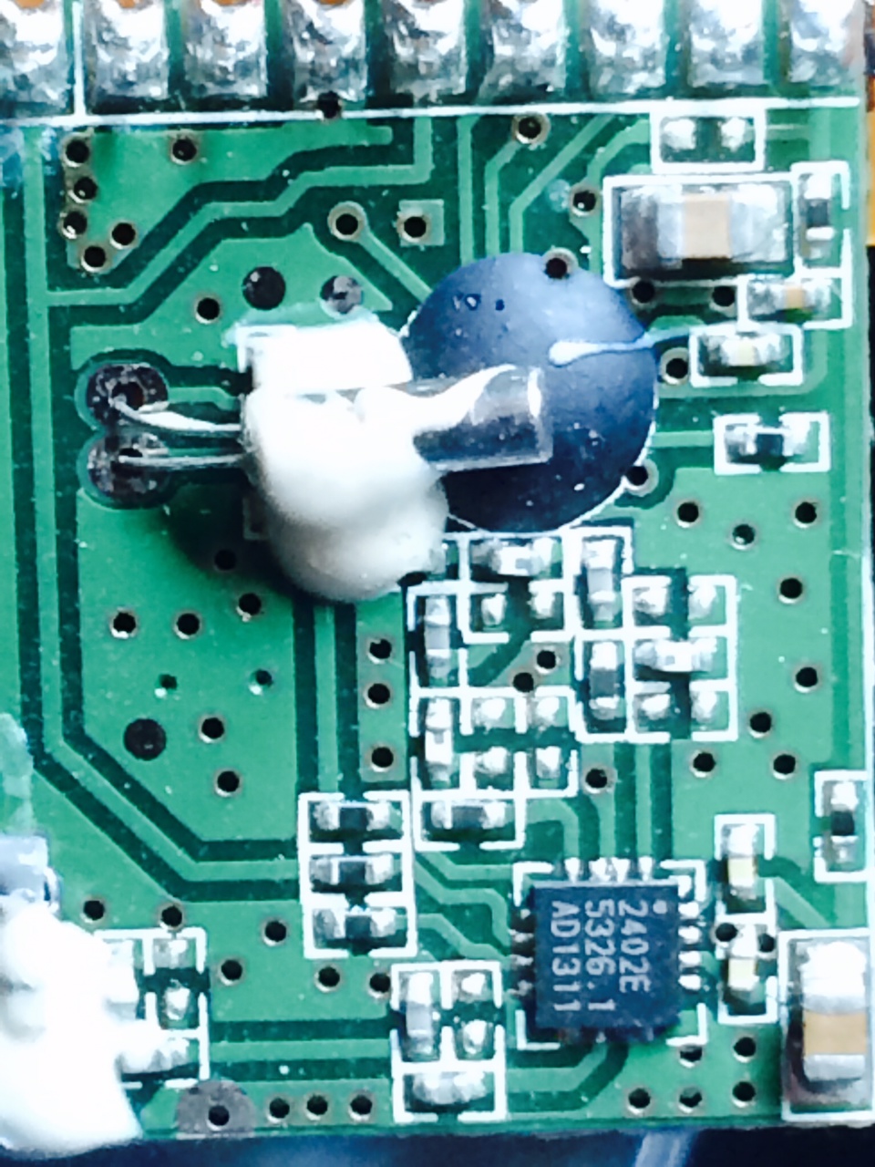

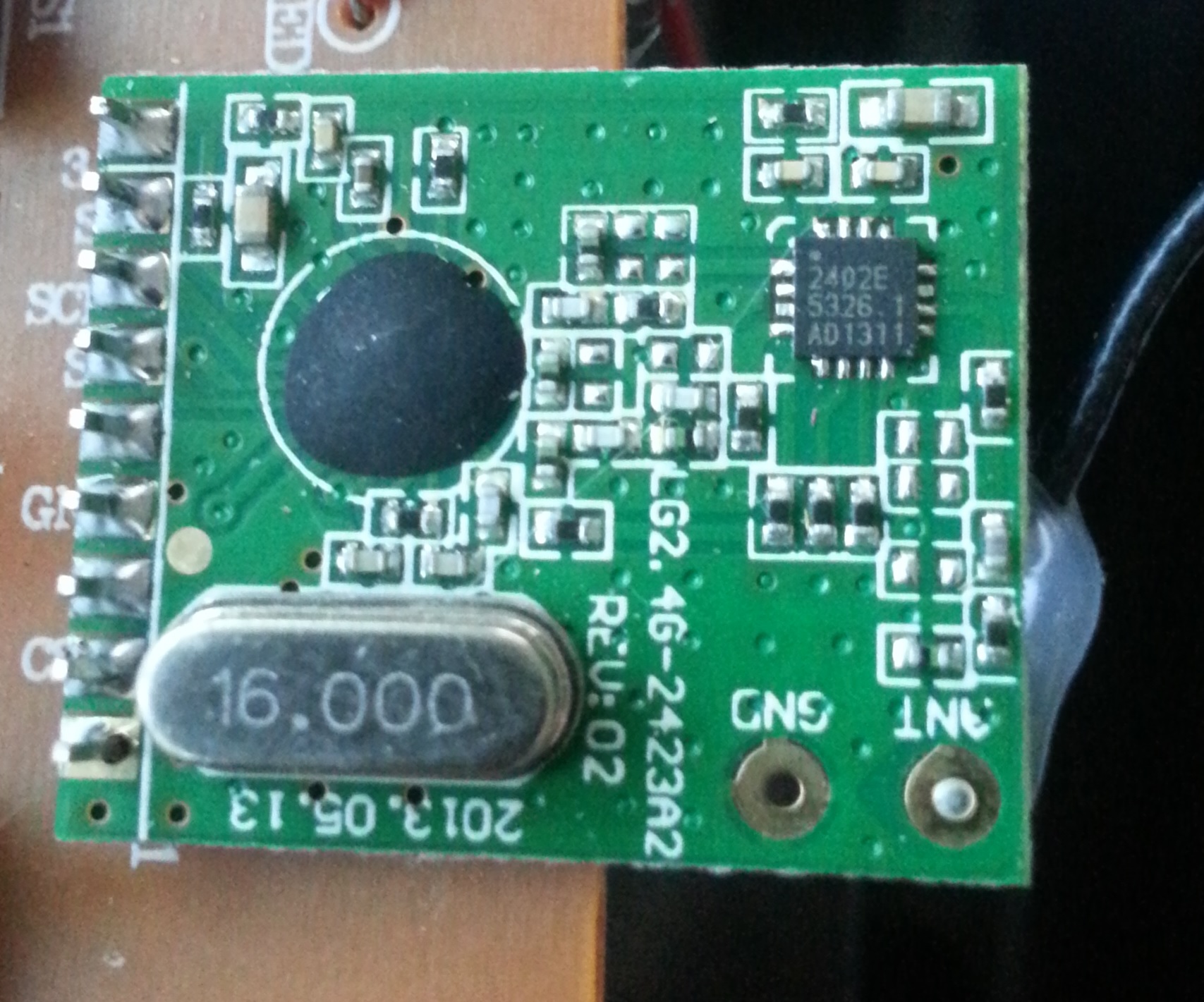

has anybody an idea which chipset this little raceboat uses?

Looks very much like the module in the stock TX from the WLToys V262.
Protocol is most likely different.

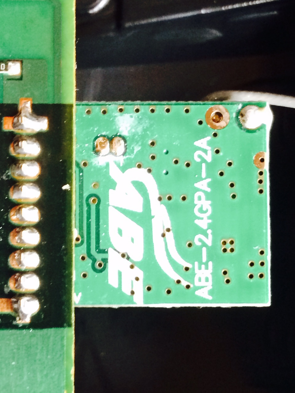

I have seen BK2421 based RF Modules from "ABE" in UDI Transmitters and X30V Transmitter. (Though both are labelled AGBE 2.4GCOB).

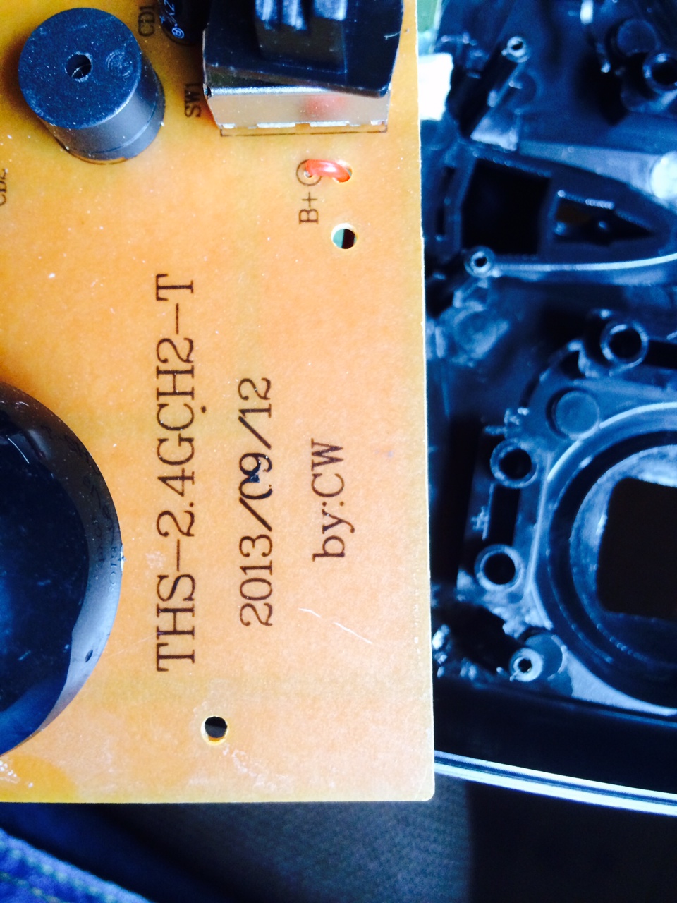

X30 Transmitter is labeled "KY-X30T-2" (Video Version, red PCB) and has
"by:CW" plus "LFPCB.cn" printed on it. Its using XinXun protocol (which is a YD717 variant available in deviation).
You should try YD717 and its protocol variants (available as protocol options) and also V2x2 (copied by many).

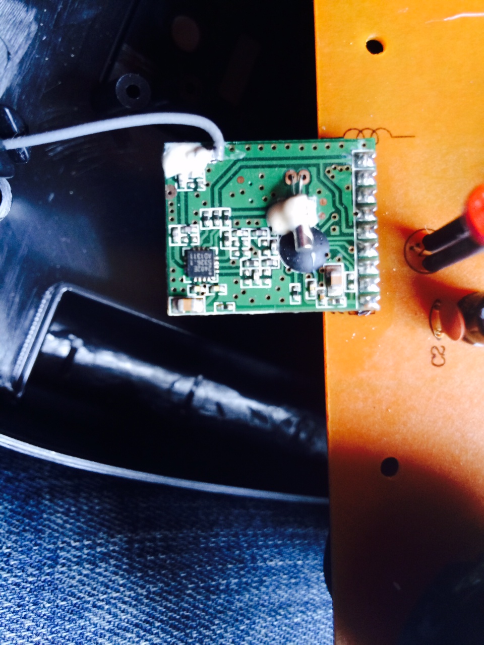

i ve harvested the 2421 module from the original transmitter and planted it to my devo 6.
No luck with the yd717 variants and v202.
in the manual of this toy binding is described:
Turn on rx
within 5 seconds turn on tx
rx is blinkin faster
steer in one direction to fix binding
led should go solid
do you know toys with the same binding procedure
Turn on rx
led should go solid

No luck
Tried to bind with CX-10
Red pcb
Should work with Skywlkr Protocol but Dienst
Waiting for the Single board Universal Module for my 6s and my 12s
Red pcb
