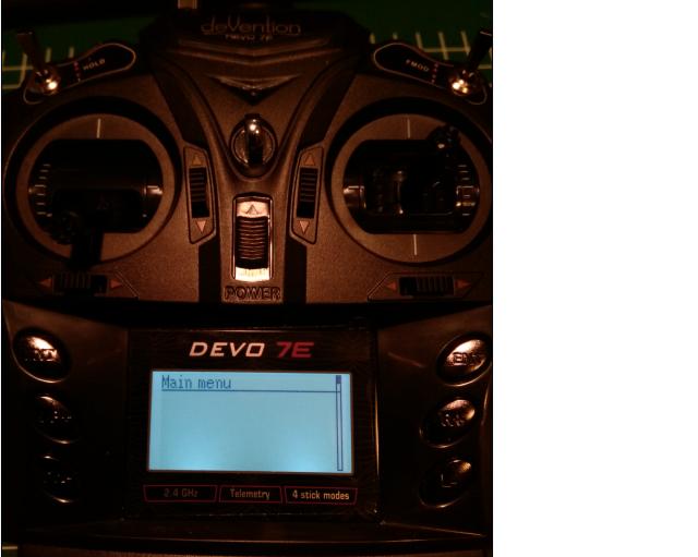

I'm new in rc heli. I have a problem to install the deviation 4.01 with kn protocol for my devo 7e. My current test version is "deviation-devo7e-v4.0.1-415e24c".
After the installation . If I turn on tx and press ENT , a strange blank sceen will be displayed and there will be no response anymore. All I can do is turn the power off . My 7e is new from two weeks ago.
Problem will be fixed by install the offical deviation 4.01 without kn protocol . But I need the kn protocol very much for my v977.
Anyone can give some suggestions ? Pls help ! Thx!

Did you also copy the included filesystem? Does this happen at initial startup or only when you have selected the KN protocol?
Shing Tong Chan wrote: After the installation. If I turn on tx and press ENT , a strange blank sceen will be displayed and there will be no response anymore. All I can do is turn the power off . My 7e is new from two weeks ago.

- wasp09
- Posts: 211
04 Aug 2015 17:20 #36553
by wasp09
Replied by wasp09 on topic V977 on 7e
ShingTong,
Thanks to Moeder, we solved the screen whiteout puzzle on my 7E a couple of weeks ago.
It turned out a power supply issue. When my 7E hit the current limit on the LDO while running the KN protocol, the screen started to corrupt after a while, whiteout/reset followed. Depending on how hard the protocol worked, the time before whiteout varied... KN (FX/Feulin) dropped the 3.3V rail on my 7e to below 2.4V even before hitting the whiteout and KN (WLToys) to around 3.0V. KN (WLToys), used for V977, did not hit the whiteout yet, but it was already over the line. It gave us bogus voltage reading, something like 30% higher than it should be as the reference dropped with LDO cutoff. Put an eye to the TX voltage reading if you are showing that on the screen.
I added an extra LDO (1117) to supply the RF modules on 7E. It works fine now.
Regards.
