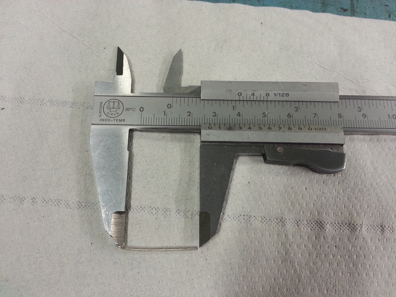

29 Jan 2015 09:31 - 29 Jan 2015 09:33 #28197 by Durete
Replied by Durete on topic SYMA X5C-1, X11, X12
Probably I found the source for the Yaw problem...
I need another good test with the correct antenna lenght.
Last edit: 29 Jan 2015 09:33 by Durete. Reason: Attach the photo...

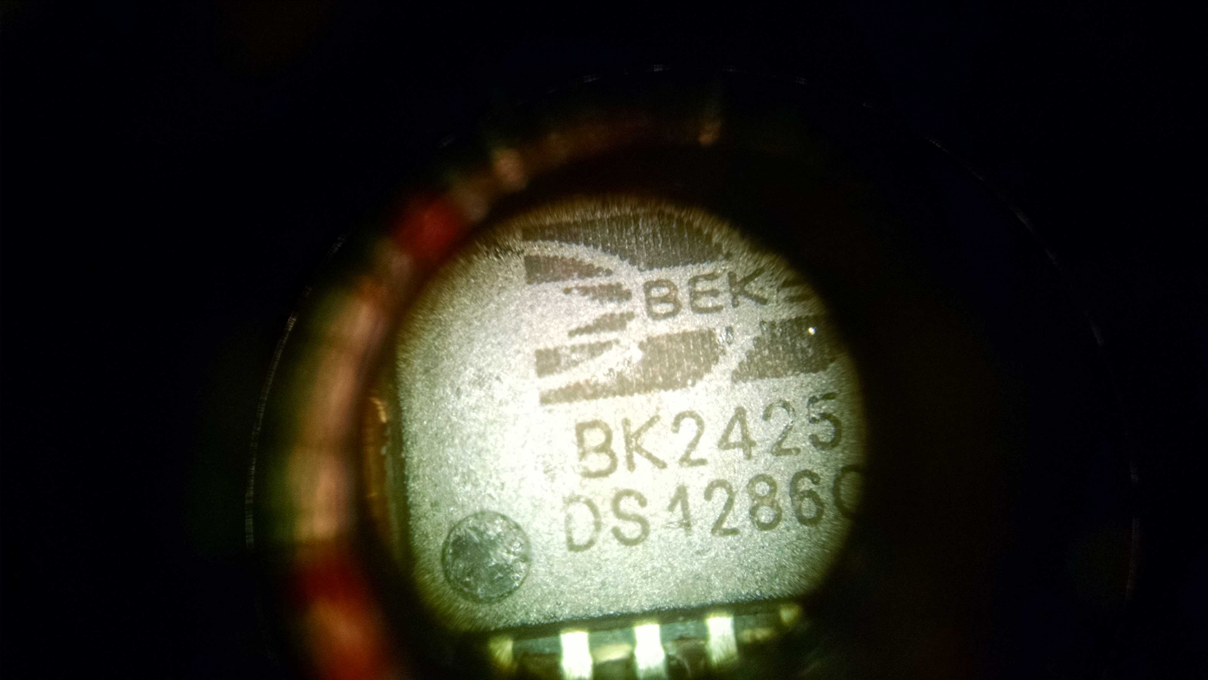

victzh was prescient - I was not able to attach probes to the X12 fc board. Just don't have the right tools. :(
The RF chip is a Beken 2425 in a 16-pin SSOP package. Was not able to find a datasheet. Looks like the SPI pins are 10-14 just by inspection. Anyone know of a test clip for this package? The pin spacing is .025 inches.
The board has several test points labeled CLK, DA, and RET. The CPU is stamped "ARM" so maybe these are for an ARM debugger? If so that might be a way forward.
Haven't given up, but not likely to solve this any time soon. Had an idea to add a protocol option to choose one of the 3 tx addrs that have been captured, so at least a few Devo users could fly together.
The X12 is fun to fly! The yaw rate is anemic so I just flew tail-in the whole time. Tilt the direction you want to go and the thing is fast. Reversed directions so the headlight becomes a taillight and makes it easy to see outside.
Last edit: 30 Jan 2015 04:26 by hexfet.

30 Jan 2015 07:41 #28229 by Durete
hexfet wrote: victzh was prescient - I was not able to attach probes to the X12 fc board. Just don't have the right tools. :(
I can't find any BK2425 datasheet so far, but I have on the way an X11 spare FC and I have the equipment and skills to attach some probes to the RF chip or MCU. :)
If you guide me, I can capture the info you need.
