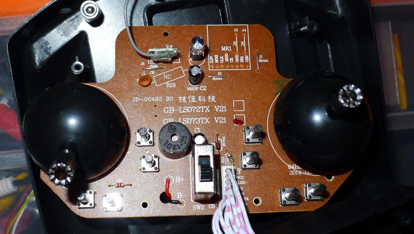

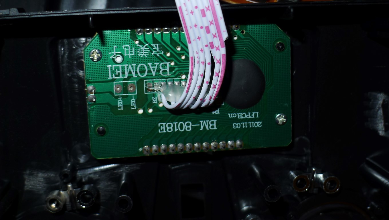

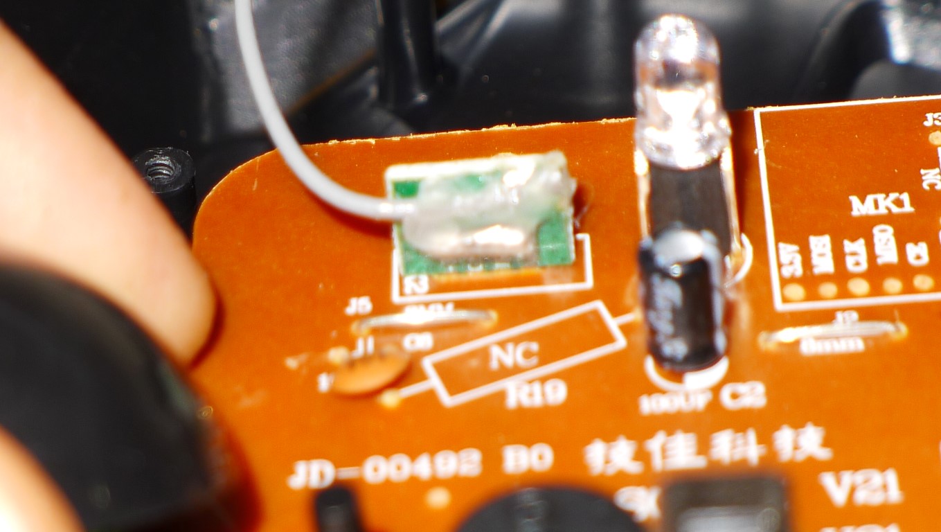

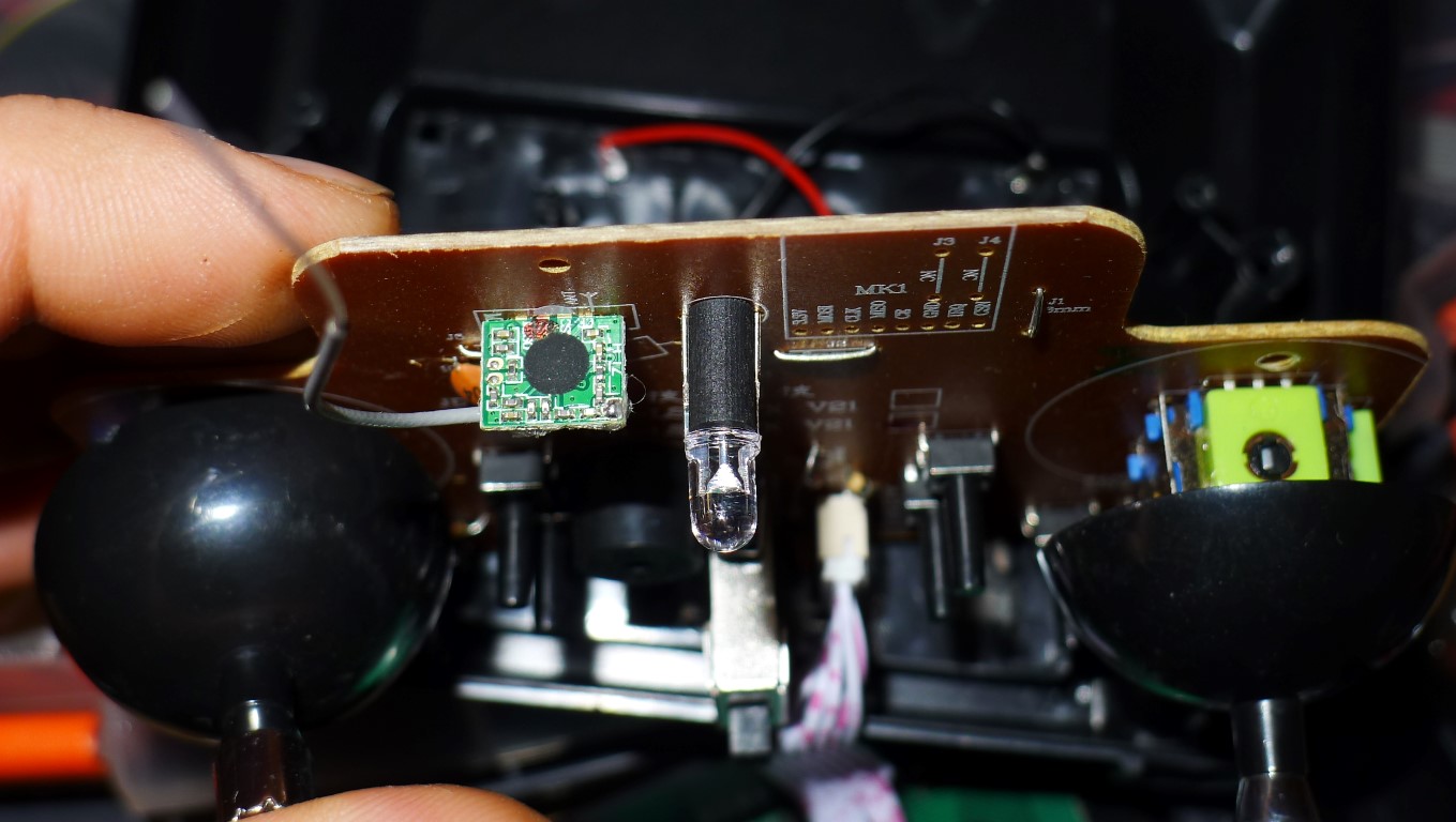

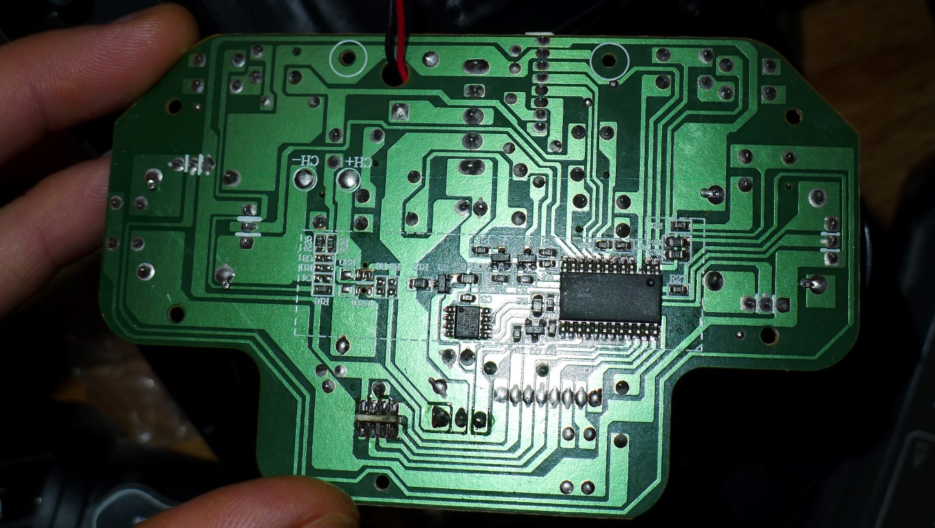

OK Here's some pics of the board (although Durete thinks it uses the XN297 chip so maybe they won't be useful. Sorry probably overkill

Interesting pics. Looks like the board can take an alternate radio module. Wonder if the label in the second pic is "NRF" under the white stuff?
I didn't find any XN297 modules on ebay or amazon. It would be interesting to know if it's compatible with the current deviation nRF protocols. The cx10 code might also work with the XN297. But a volunteer would have to remove a module from a stock tx to install in their devo
It would install just like an nRF24L01...

OK I pulled apart my ls111 controller because I'm ok with sacrificing that one anyway and unfortunately it doesn't have a breakout board. I was however able to confirm that it is a XN297 chip. (XN297 1428 printed on it)
I just looked on the data sheets and since hey are pin compatible couldn't I buy a nRF24L01 board and remove the chip and replace it with a XN297 chip. I could get the signal amp if I did that too. They both are a QFN20 so it shouldn't be that hard (although small).
Thoughts?
Thoughts?
