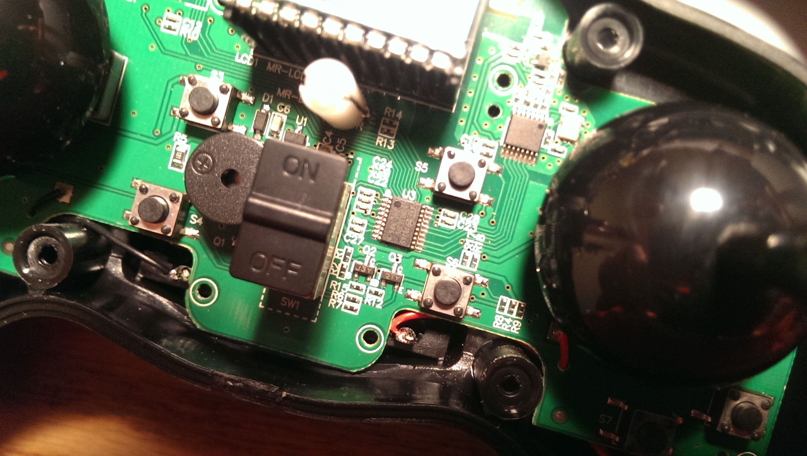

Anyone tried dissecting the Proto X SLT RTF Tx?
The manual says that an SLT transmitter can't turn the lights on/off. Any chance someone has looked at doing that with deviationTx? Or maybe I should have gotten the earlier version?

That would be interesting to reverse (I did the original SLT). I second this request, if someone have detailed photos of TX, please publish them to assess feasibility of the hack.
18 Feb 2015 03:11 #28777
Replied by mwm on topic Proto X SLT LEDs?
Ok, here you go. I can't quite make out what the chip in the center is - presumably the MCU. The other IC on the board is a BK2425, which is an RF module. Apparently, this is used in the Syma stuff you've been working on already.

I see. I wanted to buy Nihui U807 with camera, but they're not selling it right now, only pre-ordering, and despite advertising free shipping they try to add shipping as well.
So maybe I just buy this Proto X SLT - it seems to be solderable to. I have Lishitoys L6052 with similar chip, so I will try to do this first.

So what you're saying is that nobody tried to control it with third party SLT controller, Deviation including?
18 Feb 2015 03:55 #28783
There was one comment on rcgroups about someone having no luck binding it to a deviated 7e. I certainly plan to try again when I can get one into bind mode.
Since Hobbico pretty much instantly said mine was defective, I suspect there are issues with the magic gestures to get into bind mode, which is new on the SLT version.
