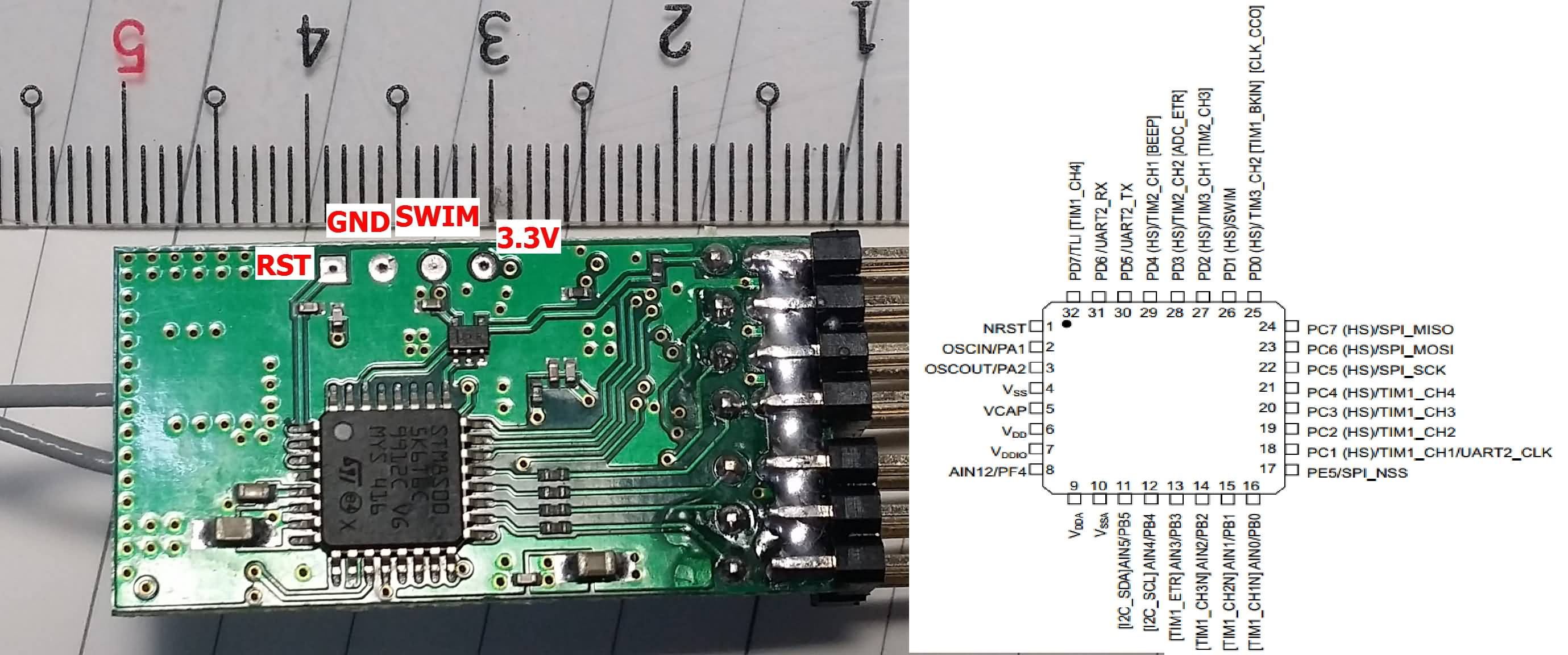

dc59 wrote: I can't connect my SF700S to ST-Link and now I got problem, my SF700S can't work! :(
Dose pin order from left to right at bottom side Reset , vcc (3v3), gnd , swim correctly?
Omg , I'm sorry for this :(
Reset , gnd , vcc, Swim . Hope stm8 not burn .
If it bad , I will send you file bin to load firmware . But you have to replace new chip st8
Still not able to connect it to ST Link,I think it was killed by me ~ :oops:

john wrote: Omg , I'm sorry for this :(

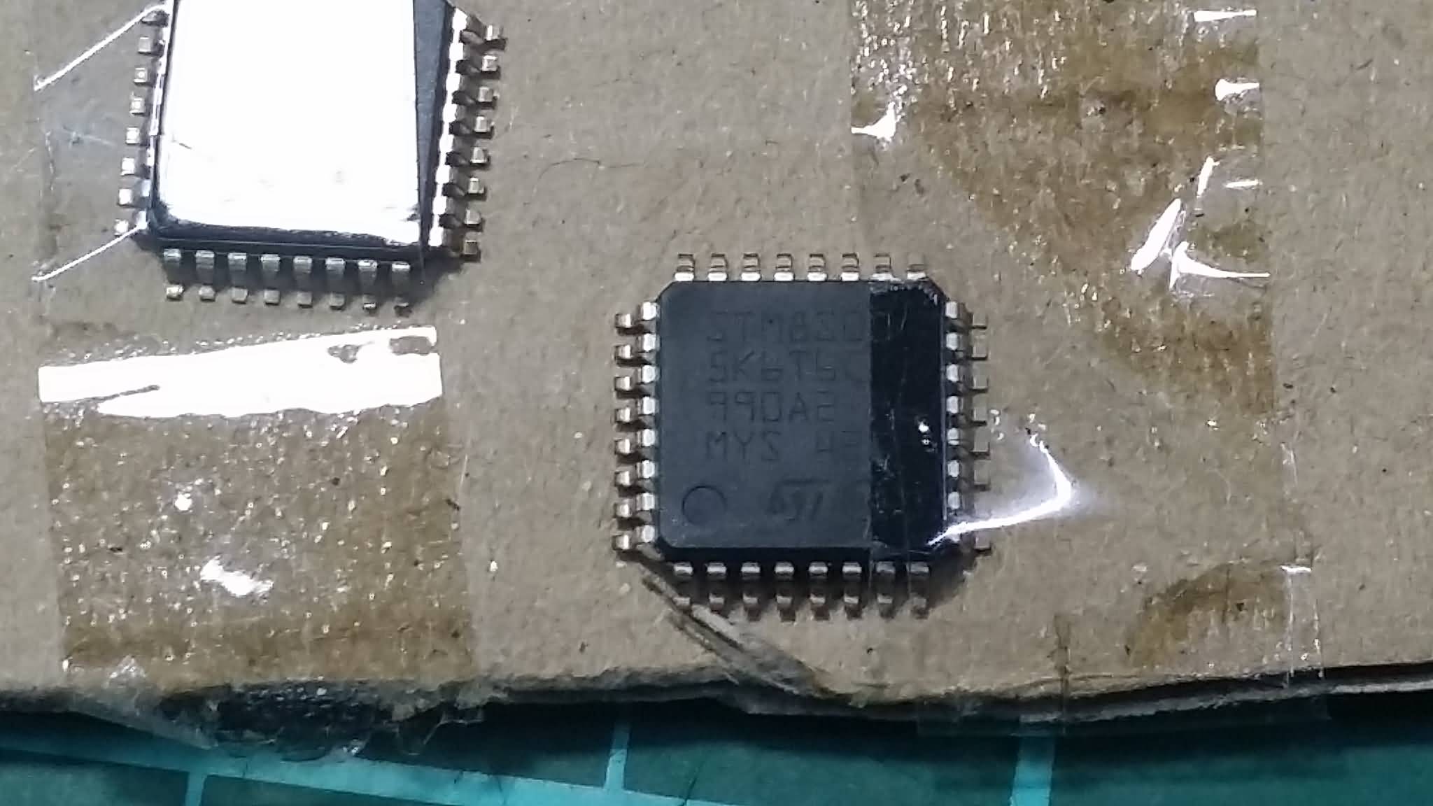

I place a order for new MCU and hope I can get it at next week! :lol:
Would you please post the firmware here?

you have to check again circuit then you remove stm8 , if it still short circuit , CC2500 and T212 , omg i don't want to say this ......
i will send you inbox for a firmware .

john wrote: you have to check again circuit then you remove stm8 , if it still short circuit , CC2500 and T212 , omg i don't want to say this ......
Hi John,
I use multimeter to check pin connection as below:
Is it correct?
and I didn't get your firmware.

Hi John,
I got my new MCU today,would you please send me firmware?
Thanks a lot.

dc59 wrote: Hi John,
Thanks a lot.
hi dc9 .Sorry for missing topic ;)
you should power v for rx , then check volt 3,3v to sure , next is solder stm8
i send firmware stm8 rx sfhss . Good luck . :)
Thanks a lot.
I replaced new MCU to receiver, but still can not connect to it via ST-Link , I think the board was broken already! :(
