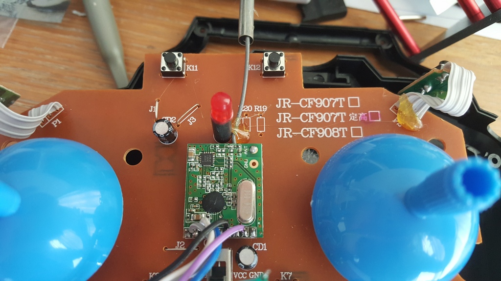

I recently purchased a H26WH, the variant with altitude hold. It cannot bind using the H26D protocol. The circuit board looks similar to Seby's H26D but it probably carries a different MCU software.
I have uploaded the SPI capture of the binding with the stock transmitter here
Any comment on whether it is a known protocol is much appreciated.
Last edit: 03 Oct 2016 05:50 by ajtank. Reason: better clarity
03 Oct 2016 10:20 - 03 Oct 2016 10:30 #54545 by goebish
Replied by goebish on topic JJRC H26D
Looks like yet another MJXq variant, have you already tried to bind with every MJXq sub-formats ?
Also, can you tell me which RF chip is that ? I can't see it well in the picture (or maybe the RF chip is under the expoxy blob, and the other chip is a PA), I suppose it's a Beken 24xx.
Last edit: 03 Oct 2016 10:30 by goebish.
03 Oct 2016 10:36 #54546 by ajtank
Replied by ajtank on topic JJRC H26D
Yes I did try all available options under MJXq but no joy. The chip on the top edge is RFX2401 (PA+LNA) whilst the chip next to the crystal is covered by black epoxy. According to previous threads it is supposed to be a Beken transceiver.
